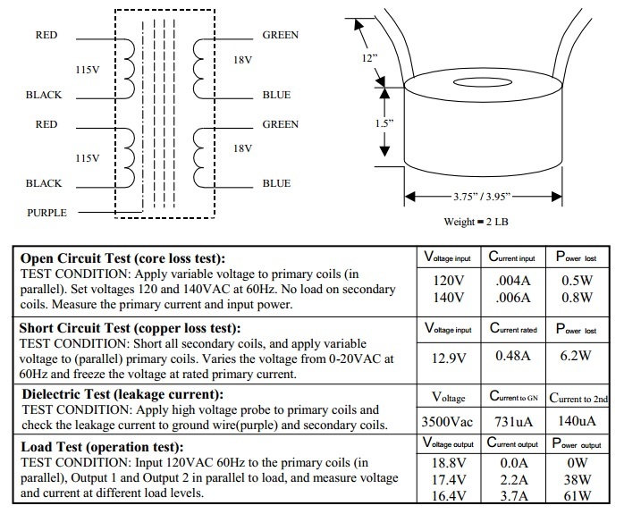

Bought an ebay 9028 DAC also bought Antek AS-0509 and AS-0518
How do I connect the 2 x 18V ? 18V - 0 - 18V There are two sets of Green and Blue wires.
Thank you !

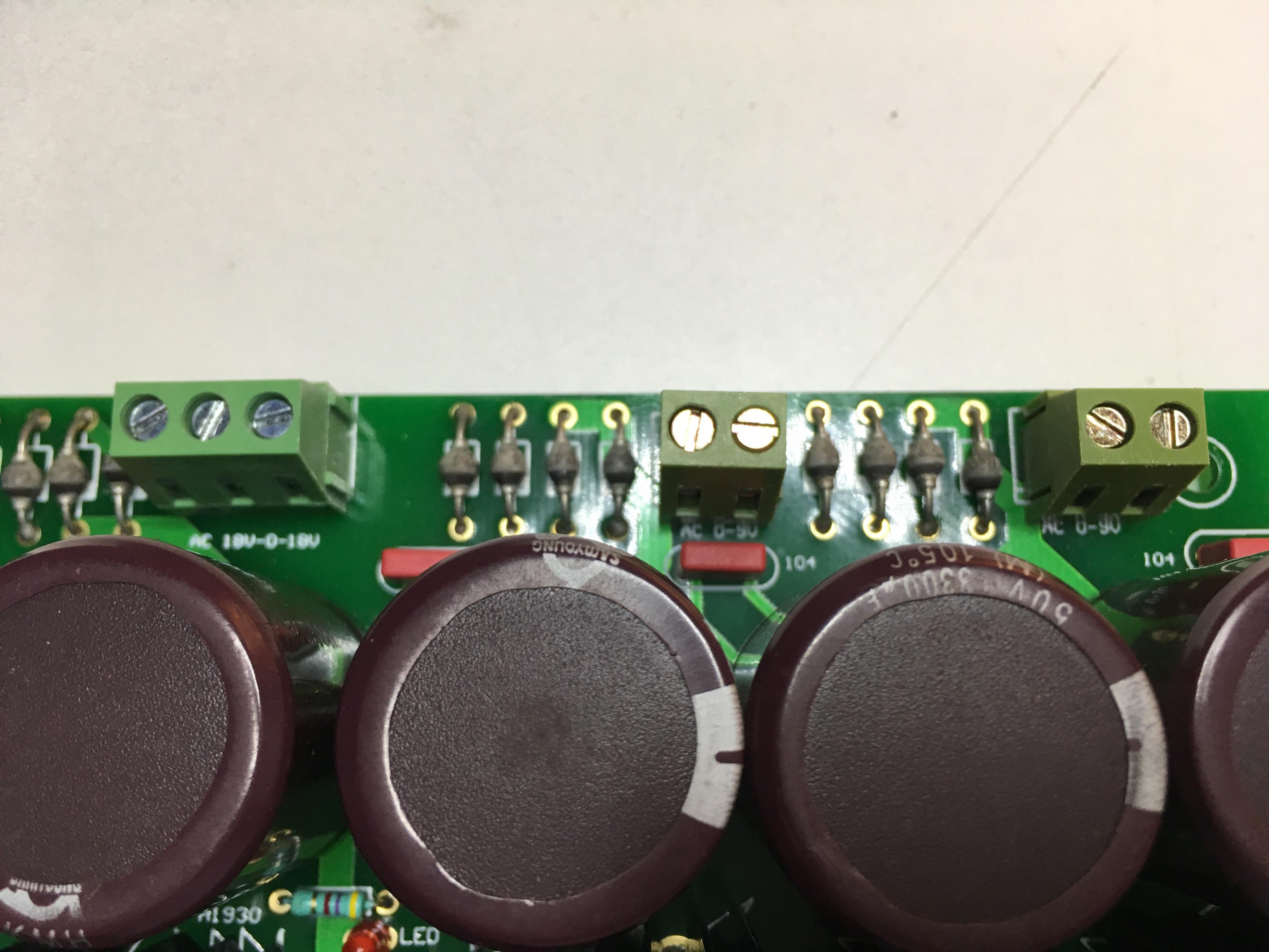

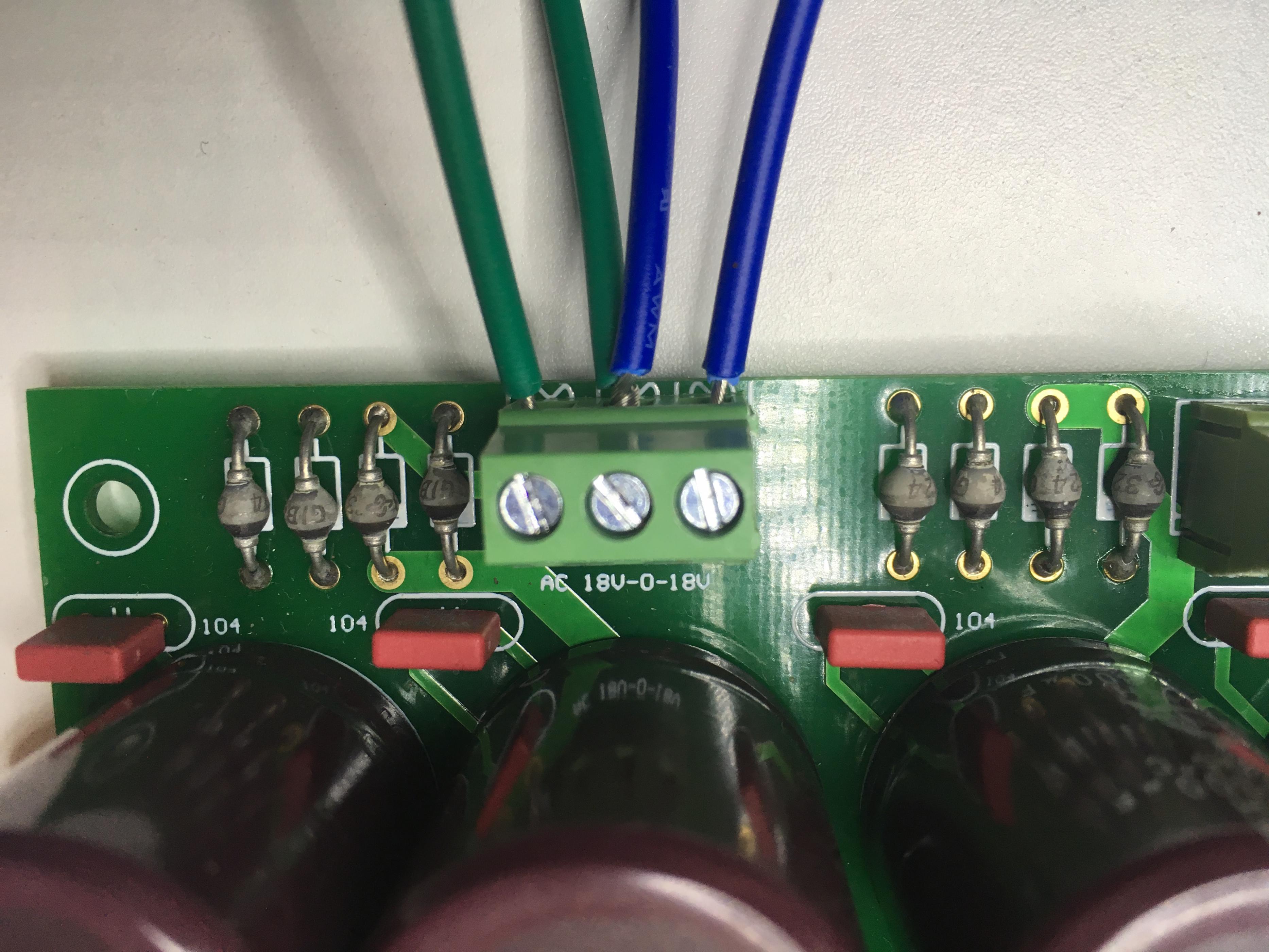

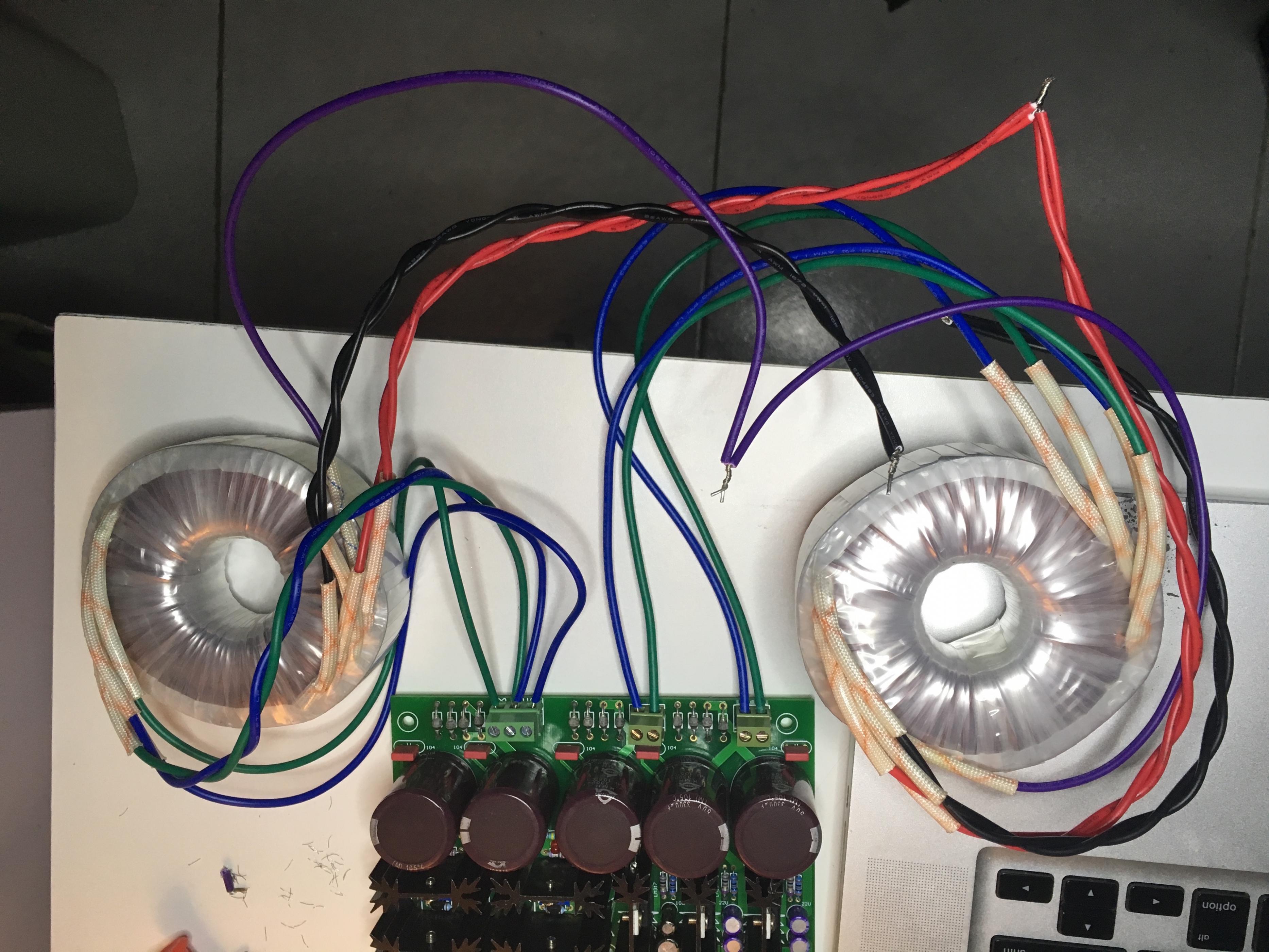

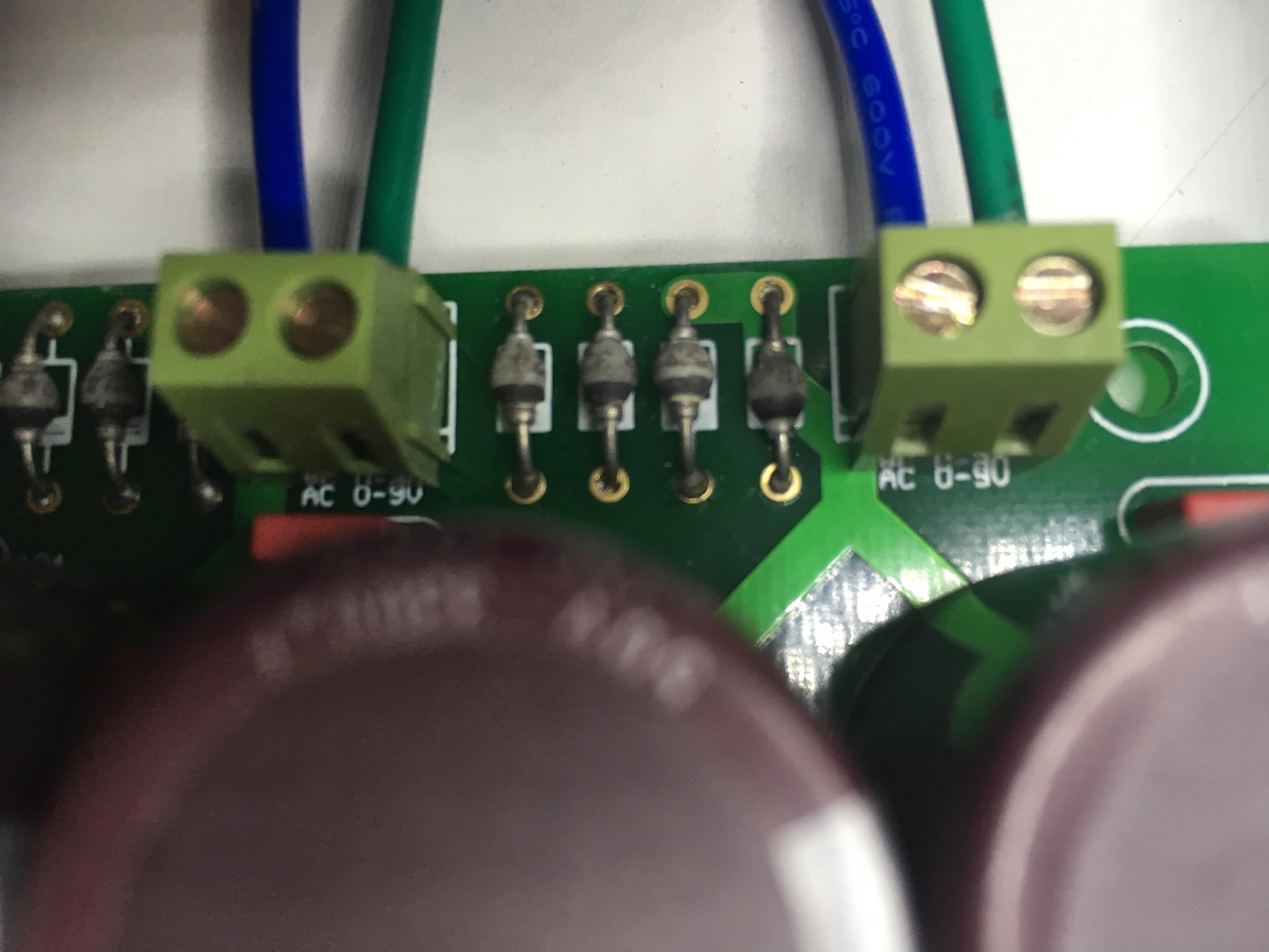

Dear abraxalito,
Thank you ! I am still enjoying your suggestion of the TDA 1387 x8.
Thought I would compare it to an inexpensive 9028.
Can you please review the attached photos to confirm the wiring ?
Thank you !

I'd just double check that the blue and green you've got twisted together are from separate windings and assuming they are then yes you're good to go!

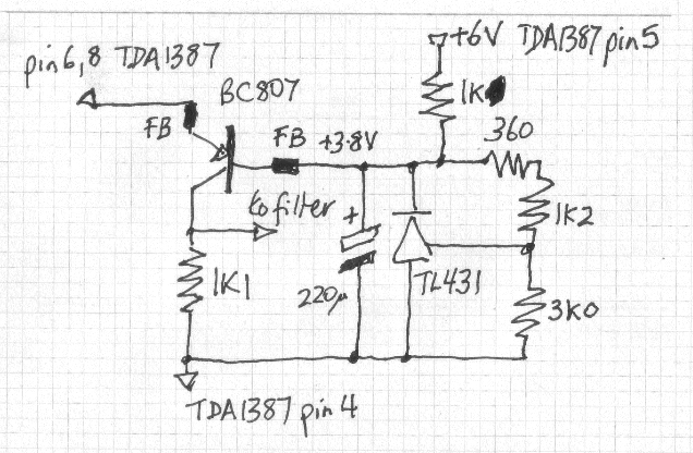

I've attached a hand-drawn schematic for what I mean here - its a simple common-base stage with the base reference voltage derived from a TL431 voltage reference. Nowadays I use this stage on the output of my LC filter but it can work directly connected to TDA1387s. To enhance it add current sources to both the emitter and collector of the BC807 - this lowers the input impedance. In its present form the input impedance varies rather with the current flowing through it. The I/V resistor (1k1 here) depends on the number of DACs you have paralleled - for 8 DACs as you have you need about 300ohms.
