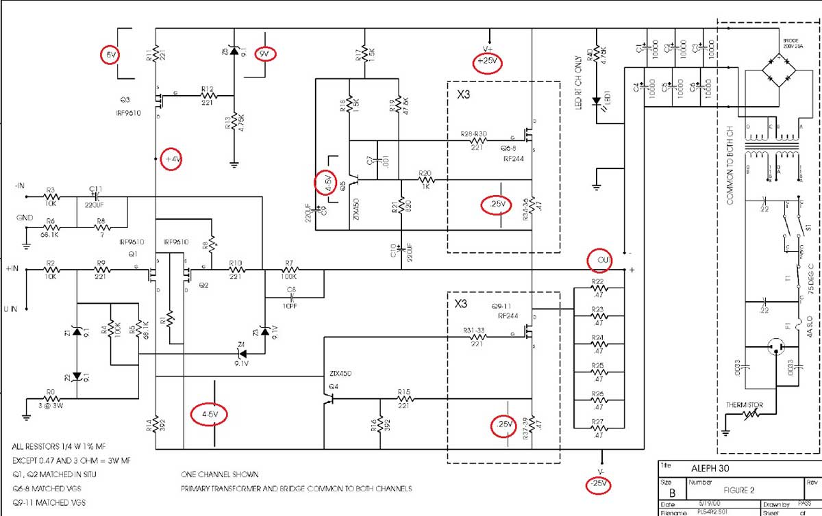

ok - for now just exclude speaker protection ( but do not connect speaker to amp output)
post schematic here , which you're using and familiar with , and I'll mark what to measure
you mean the diagram of the amplifier? If so, the circuit is this:
View attachment Pass Aleph 30 Sch original.pdf
so - download this file , open it in MS Paint or some other graphic editor program , measure all red circle marked voltages in your actual circuit and write them on schmtc
then post it here
do not forget - both inputs grounded while testing
nothing connected to output
disconnect speaker protection circuit from amplifier for now
then post it here

These are the measurements:
on resistor 221ohm 4,88 V (you post 5 V)
on zener 8,64 V (you post 9 V)
on drain IRF9610 (current generator for differential) 3,53 V (you post 4 V)
collector-emettitor ZTX450 UP 3,93 V (you post 4,5 V)
collector-emettitor ZTX450 DOWN 4,27 V (you post 4,5 V)
on first triplet resistor 0,47ohm : 0,40 V - 0,39 V - 0,38 V
on second triplet resistor 0,47ohm : 0,41 V - 0,38 V - 0,38 V
however, the thing that continues to leave me perplexed the fact remains that if not connect the signal, the output voltage is around 40mV, while connecting the signal rises to 0.54 V, hence the reason for which the speaker protection (which currently is disconnected) goes in protection.
so , after several posts - I'm realizing that your problem is combined from two things :
1-unmatched input mosfets
2-missing procedure/possibility for setting output offset
cure :
replace R11 with 500R multiturn trimpot (connected as variable resistor - middle leg connected with one (any) outer leg)
set it , prior to soldering , to half value
short both inputs to ground
power up
set offset with that trimpot , after temperature equilibrium
do the same for other channel
shorting inputs to gnd during setting offset and Iq procedure is a must
