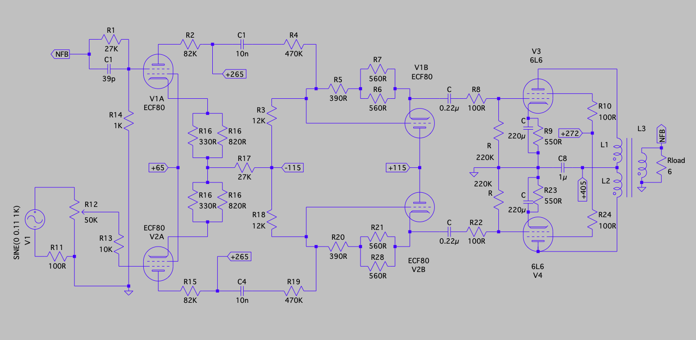

Hi All,
Recently I cleaned up the attic and found a project I never finished. With autumn almost here I searched for a schematic that fits the parts and Yves' design is a close match.
In short I wanted to build the schematic I found from Yves 6l6 PP but without the fixed bias potentiometers.
I've been searching on cathode bias, and found some information but I'm not sure how to apply it and if it is even possible...
If possible could you help me understand how to change the schematic to cathode bias and provide with the steps necessary to do so.
Or a link to another website or thread if I missed that would also be great.
thank you for your time in advance.

Since you already have all the parts, I would just build the circuit as the schematic you posted. Just put is two fix 560R resistor in place of R6 and R21 trim pots. That is the most simple way and properly the best way.
If you must convert the 6L6 to cathode bias one simple way to do that is to add two .22uf 400V+ capacitor between R8, R22 and the cathodes of V1b and V2b. This will DC decouple the cathode follower driver which also set the 6L6 bias. You will need to put in two grid leak resistors of about 220K or so on the 6L6 grid. Next you will need to put in the two 6L6 bias resistor in place of the 10 ohms R9 and R23. If you set the bias to about 22V and 40ma, you will need a 22/.04 or 550 ohms, 2-3W. You will also need two cathode by pass caps. 200-500uF should do the job.
Grid leak resistor are put between grid to ground. Cathode bypass cap are parallel to cathode resistors.

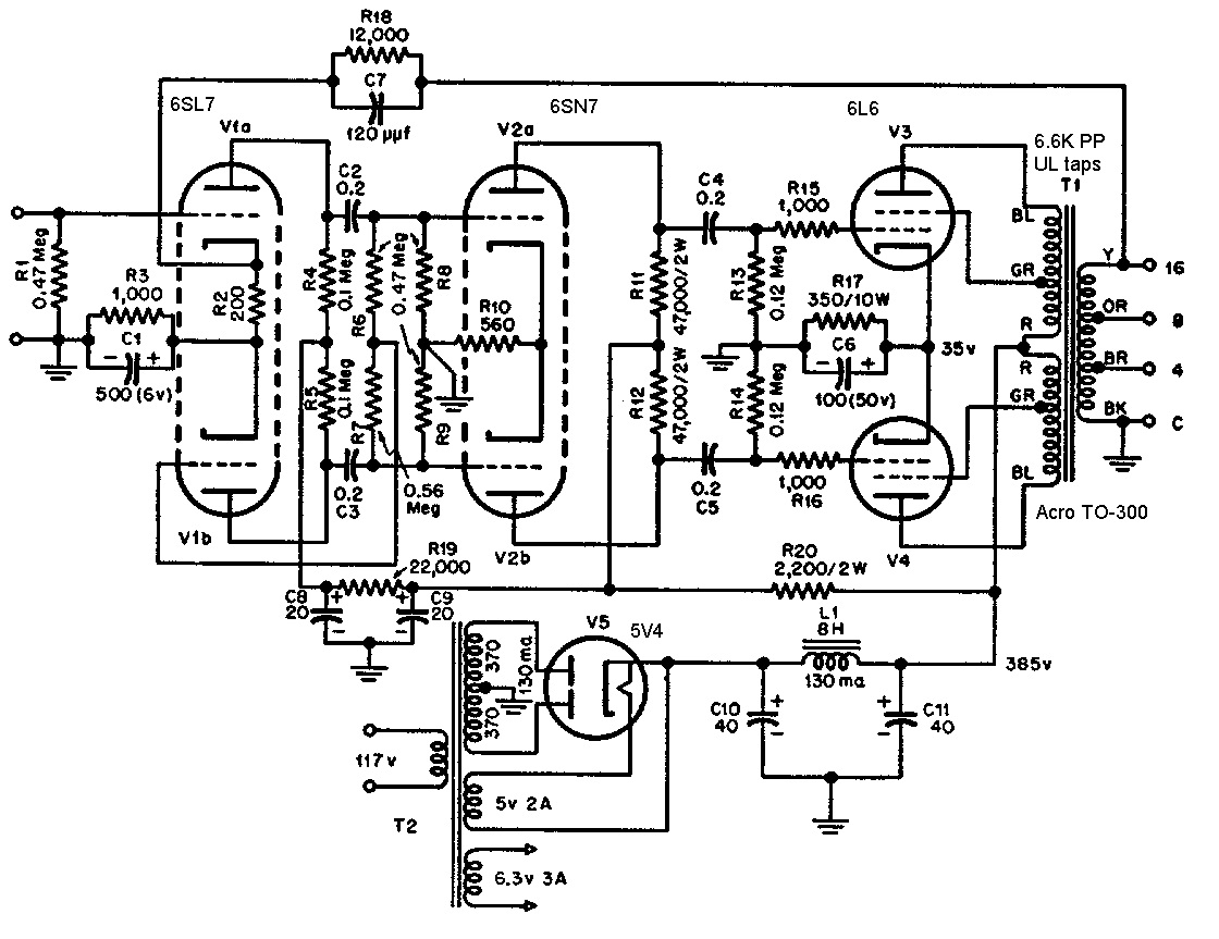

This is an easier amp for a beginner to build. Cathode bias (but I would use separate R's and C's on the 6l6 cathodes to avoid current "hogging.")
Thanks for sharing a schematic, but I choose the 1st posted schematic:
-Because it has documented test results.
-It is for all 6L6-oids even the older ones that don't like high screen grid voltage.
-Also I have 6k OPTs (50watt) not 6k6 OPTs. (I looked at the original 6L6 datasheet, It showed an option for AB2 using the 6K OPT, but I am nowhere qualified enough to design a schematic with these parameters and couldn’t find one matching the 6K OPT.
-I do have a lot of other tubes like 6SN7’s 6SL7’s, so if I find a documented schematic that would match the components I have… even more to think about... but let's not do that for now.
Ah that was my first guess treat the POT as a parallel resistor. but I didn’t think it could be so simple. And I didn't know what value to calculate with. So in my calculation I used 500R to calculate the resistor and replace it with 264R then add R5 390R gives me 654R so say replace R5, R6 & R7 with 680R
Could I do the same with the R16 470R pot? Just split it in half and settle for 220R or 240R?

It is not simple but either it is complicated. Step one is to calculate the output 6L6GC bias point. Search for a 6L6GC data sheet. Look for a Ip vs Vp (plate/anode to cathode) chart. The design you want call for Vp of about 400V and an Ip of 40ma with a G2 voltage of about 272V. If you do some reading you will find for that bias point Vg (Grid to Cathod) should fall a bit more negative than -22V. Lets use 22V as the Vg bias for now since a bit more Ip (but not too much more) is a good thing.
The voltage drop between R3+R5+(R7//R6) should be around -115 - (-22V) or -93V. R(total) should be = -93/8mA (per schematic) or ~11.6K. If you look at ECF80 data sheet and the triode curve. A good Vg bias for 8mA could be -2V. so R5+(R7//R6) = -2/8mA = ~250 ohms. And R3 should be 11.6K - 250hms or ~11.35K. Notice R3 is less than the 12K value in the schematic and all the resistors needed are odd ball value. May be this is why you have problem in the first place. The way way to bring up this amp is to have some number resistors at hand and adjust the value as you measure and bring up B+.
R16 is not used to adjust output tube bias, it is what is call AC balance. It effects the out harmonic distortion. If you don't care to tune this (have the ears or equipment) use two 230R resistor.

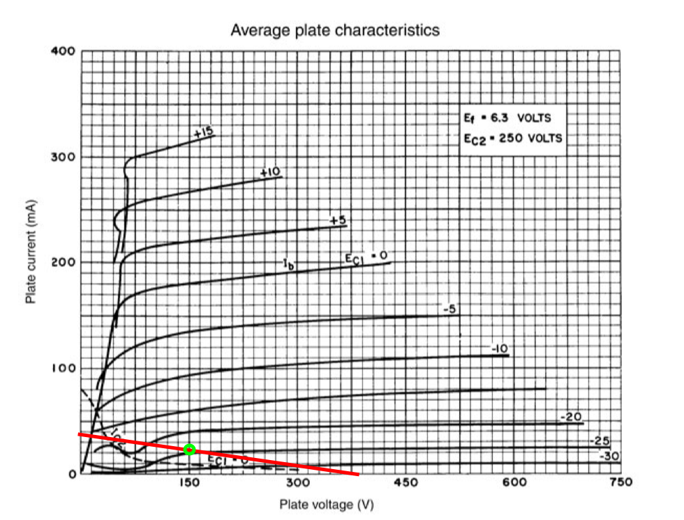

I assume you mean the “average plate characteristics” chart? I could only find charts that show Ec2 (screen grid?) as 250V. When I draw a line from 40mA to 400V the center touches around -25. Is this correct?

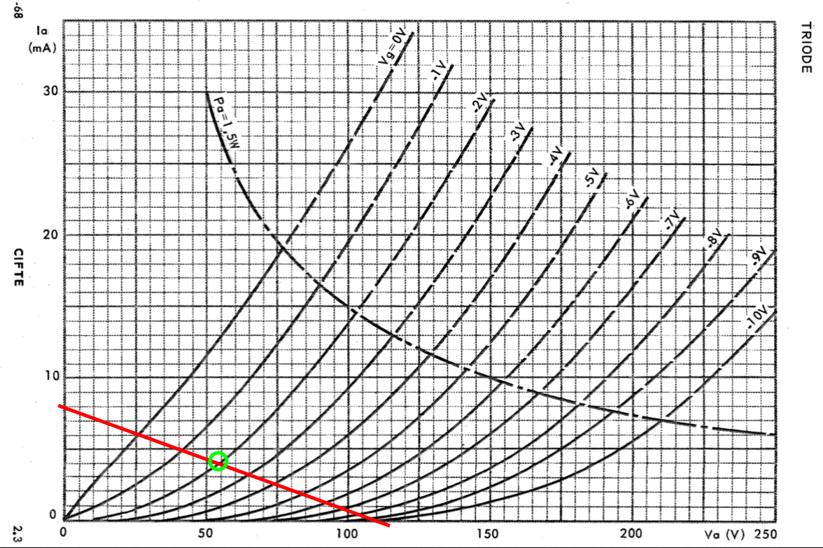

Also attached. This raises no questions because when I draw the line it is spot on at -2V.

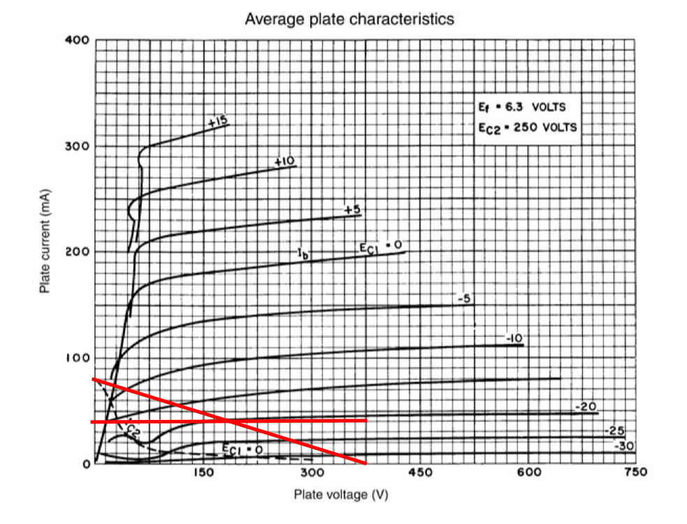

I assume you mean the “average plate characteristics” chart? I could only find charts that show Ec2 (screen grid?) as 250V. When I draw a line from 40mA to 400V the center touches around -25. Is this correct? Or is 40mA the midpoint and should I draw the line from 80mA to 400V

You have the correct V/I curve for 6L6. One correct way to draw a load line is to draw a line from 400V to 133mA. This is a 3K load line (each 6L6 see half of the 6K output transformer). The133mA value came from 400V/3K. Once your draw that line, move that line up vertically by 40mA (your planned bias). Move the lower point to 40mA, upper point of the line to 133+40mA=173mA. Now extend the lower end of the line to 0 mA following the same line slop. This line now represent the AC loading that each 6L6 will see with a 6 ohms resistive output load when the amp is in class A.
The bias point is the intersection of 40mA and 400V on the load line. Grid voltage should be near -22V.
Also G2 for your curve is for 250V. At 272V, your planned G2 Voltage, Plate current Ip should be higher for any given grid voltage. Since 272V is less than 10% higher than 250V, the difference in Ip should only a little more. A little higher idle Ip typically yield lower distortion. I would leave it as is rather than redrawing a new curve or gusstimate a new bias point for G2 = 272V.
