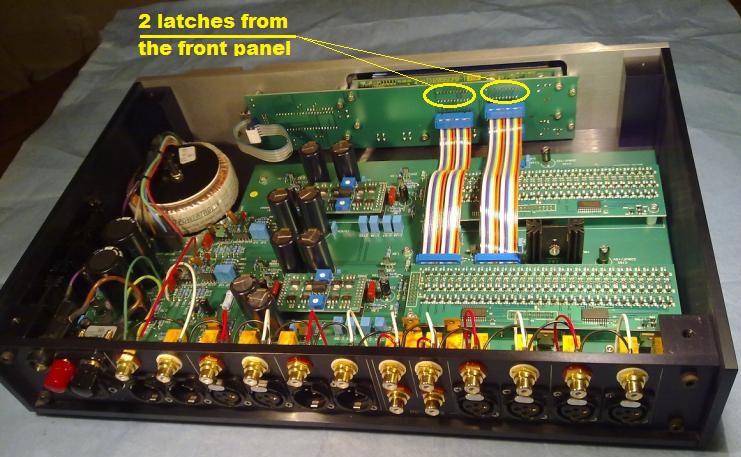

I have preamp Pass Labs X1 , now , preamp no output sound , I switch Input 1 or every switch input no sound relay click . I think uCom have problem .
Everyone have schematic or guide me replacement and repair .

I have check :
- Power supply : +/- 40 Vdc ===> OK
- UGS modules test points marked as + & - : +/- 32 Vdc ====> OK
- Regulators : +/- 15 Vdc and 5 Vdc ===> OK
- Front Display ====> OK
- 5 Vdc at pin 40 IC PROM ===> OK
May be I need replace ICs Latches

Today I very glad statement : Pass Labs Preamp X1 are working well now . I have buy ICs Latches replacement for old ICs Latches and select input 1 to input 4 working fine , connect signal input and have output signal , preamp X1 have very well sound .
Thank you everyone and Mr Nelson Pass . I have contact to Mr Kente and receive schematic manual from service at Pass Labs , and help me repair Preamp X1 very quickly

"Replace latches" it's not entirely clear which latches need to be replaced, what they are and where they are on the board. Alex.

Latch failures are usually related to not having the power cable connection made properly before plugging the unit in. The latches on the front board can then fail.
These drive all the relays and volume control circuits.
