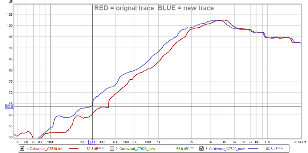

Since you had such a nice presentation here's some help;
To start off I redid your trace of the Goldwood tweeter ( I thought it looked a bit off or shifted ).
A word of caution is in order, "Don't Blindly Trust Tracing Programs" ( I've had to learn this same lesson the hard-way myself ) 😱
Identify some unique feature in the original trace and make sure the traced file has the same unique feature ( in the same frequency area ) .
Here's a comparison of your old vs my new :
658400d1516705055-please-help-refine-crossover-design-goldwood_gt520_trace-comparison_-png
In the case of your speaker these tracing errors happen to matter quite a lot ( since the LF tweeter roll-off happens earlier in your trace ) and you need all the LF performance we can get from this tweeter ( since usable woofer response dies after 2K ).

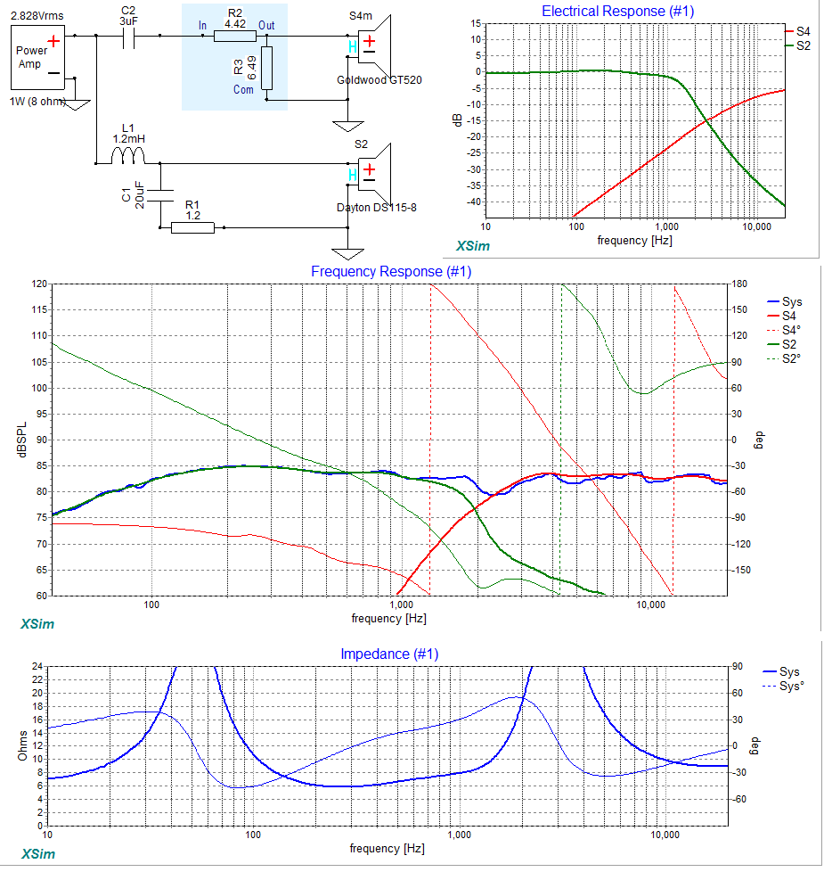

I've included 6 different approaches ( 6 XSim files in a folder ) aimed at making a network that can stitch together these two drivers ( that were IMHO never meant to go together ).
- I've arbitrarily set the acoustic center of the tweeter 1/2" back from the woofer ( this is just a guess and it really needs to be acoustically measured to get that figure to be correct ) .
#4 will likely be your best overall budget crossover ( with a live-able hole between 2-3K ) while #6 fills that hole ( at the expense of added network cost and a loss of some efficiency ).

Here's V4 ( the shaded blue area represents an 8-ohm variable LPad) which is an affordable network.

I shaved off 5db ( within the driver spec. in XSim ) since I don't believe the Goldwood tweeter is anywhere near their stated efficiency .
That's one reason why I included a variable Lpad ( in a few of the network designs ).
I figure HF balance is one area that will need a lot of user adjustment.
