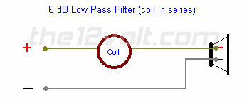

well Im not too good with this stuff and I really want to build one (for experience)
I just want to filter out the highs and midrange so the subwoofer is only receiving bass, becaude right now my subwoofer sounds like a midrange.
I would like to wire it exactly like this:
but I dont know how to build the inductor
the sub is a 4ohm @ 30Hz
so where do i start from here on building an inductor
what parts will i need (preferably fromradio shack, here,

All things considered, you are better off buying an iron core inductor. Gathering the materials to wind your own will be a major pain - you won't find what you need at RatShack. Even were you to have the material, building the coil to the correct inductance value would be a second major pain.
In addition, the parts values you specified are probably textbook values that apply only to a resistive load and will not work exactly as intended with speaker loads. It might be close enough though, depending on how fussy you are.
But there are other considerations. If your woofer has only a single voice coil you're dead in the water because you could only hook it up to one channel.
If you have a dual voice coil woofer - or two woofers - and are determined to make your own crossover I suggest that you buy what you need from Parts Express or your local car audio installer.
I agree with Kanga that a first order filter will not be enough. Consider a second order at least.
$100 for the parts, as suggest by JoeDirt, is massive overkill for this project, IMO. But I do agree with Joe that bi-amping is the way to go if you have the funds available.
