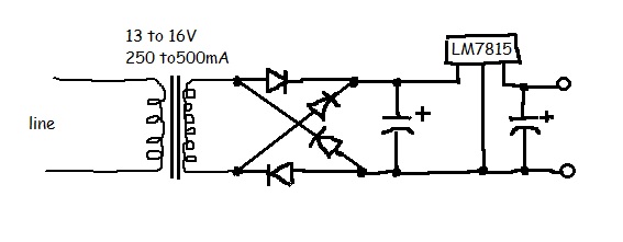

Let's start with specifying the requirements. One question I have is why, if you need 15V, 13.8V is not acceptable? Also, what are the current requirements? Most transistor testing can be accomplished with a few hundred milliamps. Easy peezy, as a popular English soccer announcer often says.
Aren't you going to have to order parts and wait for them to arrive to build the rest of the tester?
I have no idea. The spec for the design calls for 15v and 500mA. I was going to use a 16v supply I found laying around here, because my default mode is "This is good enough", but then my super-secret default foundation mode is "Must be precise!" kicks in and says "Dude that wrote the spec knows more about electronics than I know about sleeping and eating, so do what he says!" So I dug around till I found that 15v supply. And here we are.

Well I'm surprised - and not - that the +15V value didnt change with a load on +5... You didnt mention the Ohms value you used, so if it was 1k, that would cover the doubt. You need something like 5 ohms, 8 being more common amongst audiophiles.
A "switcher" is basically a class D in powersupply clothing. It uses a pulse-width scheme to regulate. In the most basic design (i.e. "cheap") everything works fine - as long as current flows out. With no current flow, the class D PWM controller chip doesnt know what to do. I have one PC powersupply that "pulses" the DC voltage output with zero current load - in its confusion as to what's going on.
Like the PC power supply, in the intended application for this brick, there's never the case of zero output current, as it's always connected to the powered-on modem device to be useful. So that problem goes away - at least as far as the OEM is concerned.
Switching power supplies are popular because, generally;
- They have the wide-range AC input, so the OEM doesnt have to stock and manage different SKUs for Europe, China and the US.
- They are typically lighter than an ordinary 50-60 Hz transformer based equivalent, so the OEM saves on shipping their product.
- They can have very good regulation over AC line variations, so the OEM doesnt have to make special, explicit circuitry in their product to take care of that.
Considering that you want to explore matching transistors, I'd suggest using the best-behaved power supply you can find - just to get that out of the picture you're trying to take of the transistor. For npn / n-channel, you'll be sinking current at the transistor output and will need a power supply capable of sourcing the current you expect to sink.
At the transistor input, you'll need to provide a current (npn) or voltage (n-channel). The input current may be 1/10 to 1/1000 of the output, so different requirement there. For a FET, the input is voltage and no continuous current is needed. It may be a good idea to use even a different power supply unit for the input part of your tester, so it remains totally unaffected as the output current increases during your test...
I'd suggest an analog, transformer based PSU for the input and a switcher capable of multi amps for the output. The switcher can be "preloaded" using resistors such that it's voltage-stable with zero load being drawn from your transistor under test. I'm imagining an ATX computer power supply, for the cheapest implementation. Use the output with the highest label current capability.
The input PSU would need to be somewhere above 10V to fully test most FETs. The current capability depends on the circuit you're using to drive voltage or current into the FET / Bipolar transistor under test. For example, if the input control was a 50 Ohm pot, the power supply would need to provide better than Vout/50 of continuous current. So if Vout was "15", that'd be 300 mA. Probably pretty easy to find something analog that can do anything above 10V, and 500 mA regulated. Regulated meaning the voltage output value stays the same as current increases from 0 - 500 mA.
Ela-blah-ating further, some PC power supply boxes have two 12V channels; one for the CPU (higher current) and one for the rest of the motherboard. It's conceivable to successfully "preload" the +5V output with an amp or two for stable operation, then use one +12V channel for the tester input control circuit - and the higher current one for driving the output current measurement. Cleverly arranged, the PSU cooling fan could even cool the heatsink you mount the device under test upon. Maybe even use the CPU HS for this, from the old 1200 "specmark" AMD Athalon box you butchered to make your transistor matcher.
Hope this helps and good luck!
The goodie I'm using for this project is listed as "N-Channel, Enhancement-Mode, Vertical DMOS FET". It'll be used as an input transistor in a differential pair. Like I have any idea what its doing, but I have to learn. Right now, I know I have to match these things as closely as possible.
Well thats interesting. You suggest using that for just testing mosfets, when there's no variance in signal or inductive load, or any of the other stuff I don't understand? I'm not arguing against it - I've heard about amp designs like that, where the input sub is isolated on its own board and has its own power supply. I find it an interesting idea, since I'm all about precision (down below my surface brain of "ehhh, good enough".
The input PSU would need to be somewhere above 10V to fully test most FETs. The current capability depends on the circuit you're using to drive voltage or current into the FET / Bipolar transistor under test. For example, if the input control was a 50 Ohm pot, the power supply would need to provide better than Vout/50 of continuous current. So if Vout was "15", that'd be 300 mA. Probably pretty easy to find something that can do anything above 10V, and 500 mA regulated. Regulated meaning the voltage output value stays the same as current increases from 0 - 500 mA.
In Nelson's diagram, its +15v to a resistor, which then goes into the drain and gate, plus a line going from the source to ground, which I assume in this case means the negative side of the power supply. There's a test point after the resistor, and before the ground. His resistor value is 2200. Using your formula I have 15/2200, or... 6mA? Can that be right?
Actually, I guess thats right. Reading Nelson's article - for the 50th #(!* time - I see he's using that exact formula to test his N channel devices at 5mA.

A "switcher" is slang for "Switchmode power supply" also called SMPS. It does not run at 60Hz. Linear supplies run at 60Hz - those are the classic transformer, rectifier and filter cap things. A SMPS rectifies and filters the mains - your AC from the wall outlets - which it THEN switches off and on at high frequency through a MUCH smaller transformer. In a typical ,linear supply, the filter caps are recharged 120 times a second. They have to provide current to the circuit for 1/120 of a second at a time. A switcher can run at 50kHz, 100kHz, even into the megahertzes. The caps there thus are recharged every 100,000th of a second and so can be much smaller.
The SMPS lacks the huge iron transformer, so it weighs FAR less. It also runs at very high efficiency. The large iron transformer is also relatively expensive. A whole SMPS can cost a lot less than just a transformer. SOmeone had to design the circuit, but they are assembled by machine, not people with soldering irons. SO the complexity doesn't matter.
You keep referring to a "brick", and I have to admit I don't know what a brick is. DO you mean a "power adapter" like comes with so many things? What we call a "wall wart?" Or do you mean a box supply like bolts into a desk top computer? (Those by the say ARE SMPS) Point being, the whole using terms unfamiliar works both ways.
A linear supply has a transformer that steps the mains voltage - 120vAC here - down to something lower and then rectifies it. If I plug that into a 240v outlet, all the voltages inside it will be doubled. And if it is a 15v supply, that means 30v will come out. An SMPS can accept either 120v or 240v mains input at the flip of a switch. But more modern ones accept that full range of voltage with NO other compensation. By its nature, a linear supply cannot do that. And that is why jj knew what he knew.
For multi output supplies like in your computer, the +5v output is the main one, so if any output needs a load it would be that one. WHy would it need a load? Because the regulation only needs to be within a small range. With zero load required, then it has to regulate over a wider range. Needing a load isn't a feature, it is a side effect. The SMPS is not used with nothing connected as a load, so needing one is not an issue.
