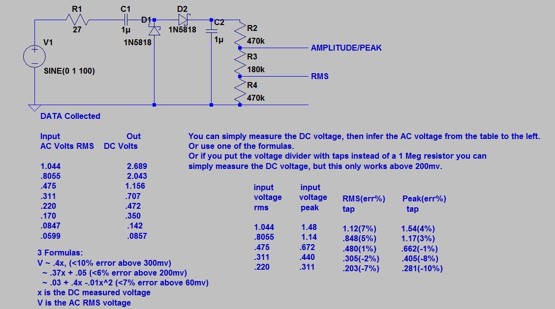

Thank you I was wondering about the extra diode, it did remind me of the Greinacher voltage doubler circuit I looked up a while back. Anyhow, I see what you mean. It should be very easy to calibrate the circuit as you described. From my laptop I will go to youtube and find a 100hz signal and use this as a signal generator and adjust the output volume oon the laptop. I will measure the voltage on DMM, write down the value, then hook the laptop up to the circuit and measure the DC measurement from the home brew meter. I'll then adjust the volume on the laptop and take several points this way. I think that should work fine. I'll also publish my results when I'm done, in case anyone else wants to use the circuit. I'll use some schottky diodes 1n5819s or 1n5818s because the voltage drop is lower, and my 1n34as I bought off ebay are a little suspect and I hear those diodes tend to be somewhat variable anyhow. I'm thinking the schottky diodes may have more uniform characteristics if someone is to build this. Thanks again, I will post my results!
Built and tested at 100hz, how high of frequencies will this circuit measure?
Ok thanks everyone. I built the circuit and also simulated. The simulation doesn't seem to work well at all. Anyhow, I used a 100hz sine wave at various voltages from 60mv to 1v. I then fit the 3 curves V=mx, V=mx+b and V=cx^2+ mx+b, the lower the voltage goes, the more complicated a formula you need. In the case of the simplest formula, which is ac voltage = .4xDC voltage measured, I just used a voltage divider with 2 taps, so you don't have to fool with the formulas or tables above 200mv. I just used E12 series values to get something close enough. You could use trimpots if you wanted to be more accurate.
I did all this using a 100hz signal (not sure how high the DMM measures). I'm assuming it would measure higher frequencies in a similar fashion?

changed charging capacitor to 10uf instead of 1uf
I tested this with a clean guitar signal on my preamp, the reading on the DMM still jumped around a little too much, so I replaced the charging capacitor with a 10uf capacitor instead of a 1uf capacitor and this seemed to work a little better, but you have to wait for the capacitor to discharge a second or so if you make any adjustments and re-measure. I've posted the corrected circuit here. Thanks everyone.
Yeah, unfortunately the guitar signal itself consists of a very strong, and very brief, initial transient (usually only a few milliseconds long), followed by a fairly rapid decay (that only lasts a few seconds at most).
The bigger capacitor will also probably eliminate that initial transient voltage, so what you read will be some sort of heavily averaged voltage. (That isn't necessarily bad, you did the right thing to make the DMM readable - just keep in mind that big initial peak voltage probably isn't going to show up in your measurement.

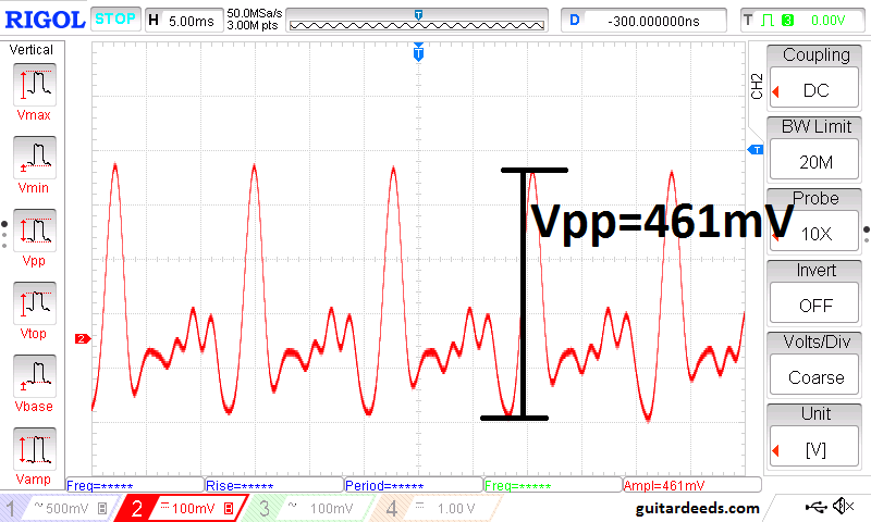

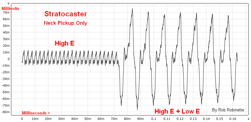

A while ago I had the same question (how big is a raw guitar signal?), and I found a couple of oscilloscope screen captures online; I'll attach them in case you find them helpful.
Incidentally, neither of these images shows an initial transient; the second image was probably taken well after the initial pick attack, but I'm confused about the first (the one that shows both high E and low E output). Why doesn't this include a transient at the point where the low E string was picked? 😕

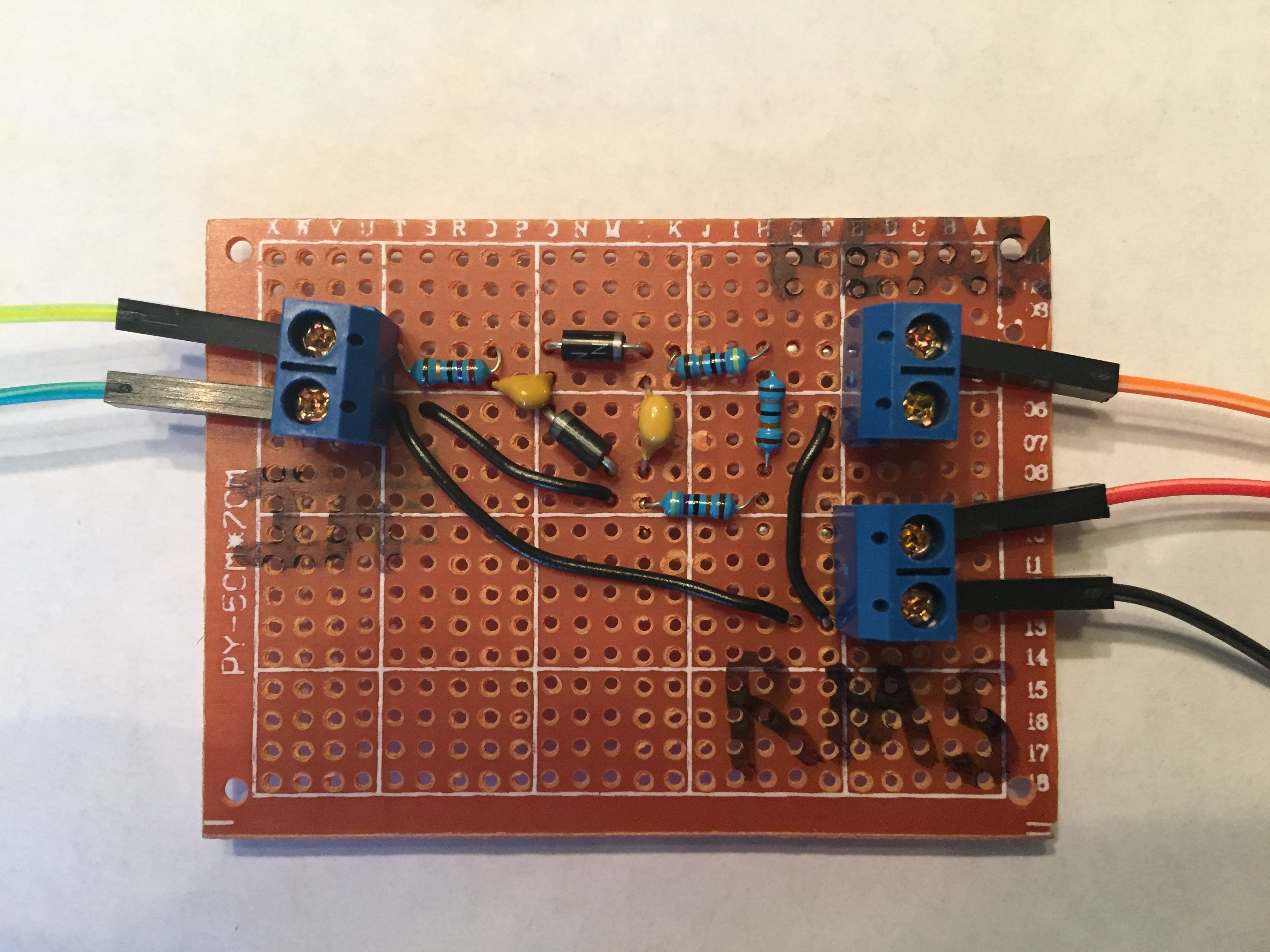

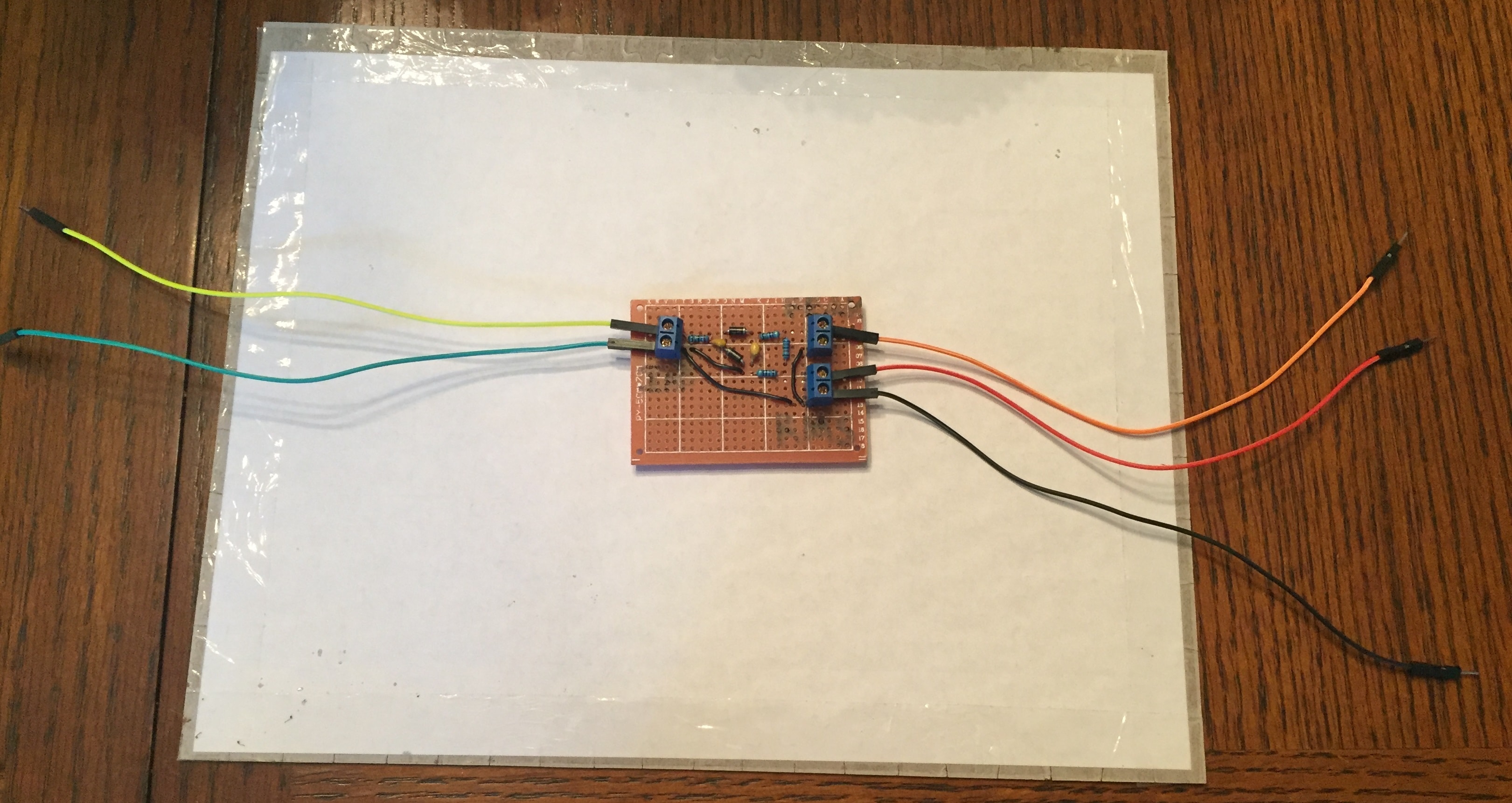

picture of my circuit, thanks guys
Thanks Gnobuddy for the interest and the circuit, that is a very interesting circuit.
I think those circuits are all great for teaching or use so I'm glad they were posted. (As far as measuring down to 60mv I'm simply posting what I found as I was curious. I cut and paste into mycurvefit.com which plots it and fits it automatically, so it only took a few minutes, doub't I'd ever use those formulas)
Anyhow, in practice, I've been using the simple voltage doubler charging the capacitor with the output across the voltage divider with 2 taps, I think that's simple and accurate enough for my purposes. Here is a picture I've already used it multiple times.
Thanks JMFahey for the circuit you posted, I'm very happy with the spinoff I did of it, its seems to be working fine and has been very useful. I like the idea of the voltage divider knocking down the output though. Its not that hard to divide by 2 and multiply by .7, 🙂 but it seems nice to me to just read the voltage right on the dmm etc.
