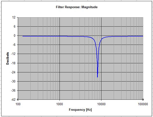

I am still at a loss when it comes to the 8.1KHz notch filter. I found many examples of circuits for such filters, but they were designed to completely remove a band of frequencies, whereas I only need to slightly lower the gain. Basically I need 8.1KHz, -8dB, Q=3 (about 1/3 octave bandwidth if I'm not mistaken). The simpler the circuit, the better. Any suggestions?

If you are looking to make an active notch filter, I can supply you with a printed circuit board and a bill of materials for creating a notch filter at that frequency and Q. The circuit will only use 1/2 of the PC board, a dual op amp, and a few parts. The response should be like this:
The above plot is from a simulation I put together of the as-built circuit using real world components having Fc=8.1k Hz and Q=3. There is a slight gain loss of about -0.5 dB.
I have developed the board design so that a range of active circuits can be created using the same board, depending on how it is populated with components. You can design it for whatever frequency and Q you want, if you decide to modify the notch frequency or depth for instance, or want to use the other half for a HP or LP filter, delay, etc. You will need to solder all the parts to the board and provide a regulated power supply to use it.

2) What notch depth can I get ? I'm looking for at least -60 dB in order to use it in distortion measuring set up at 1kHz
