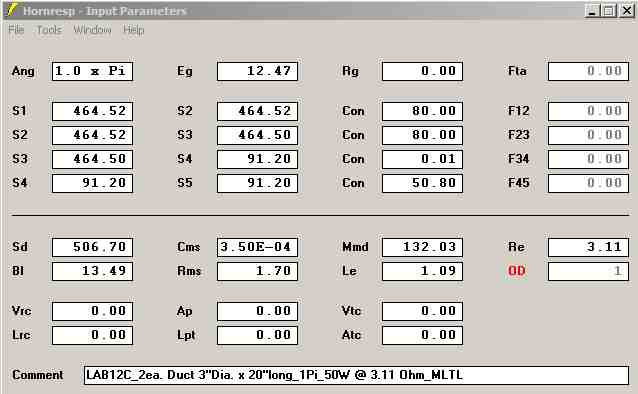

1) Hornresp is an excellent free software program which can help you compare most sub enclosure types. No software is actually capable of designing subs, software can suggest alignments for various driver choices, which makes it possible to compare simulations without having to purchase the drivers and build the enclosure.
Hornresp
2) Box volume is tied to a variety of driver parameters, but in general bigger boxes require less power to achieve the same SPL (sound pressure level).
3) Smaller drivers with the same excursion as larger drivers have less displacement, the more displacement the more SPL capability.

I would recommend you go the DSP route, then you can just build whatever box is convenient and fix the response to what you want afterwards.
There are even nice DSP plate amps nowadays.

Hi toffee123,

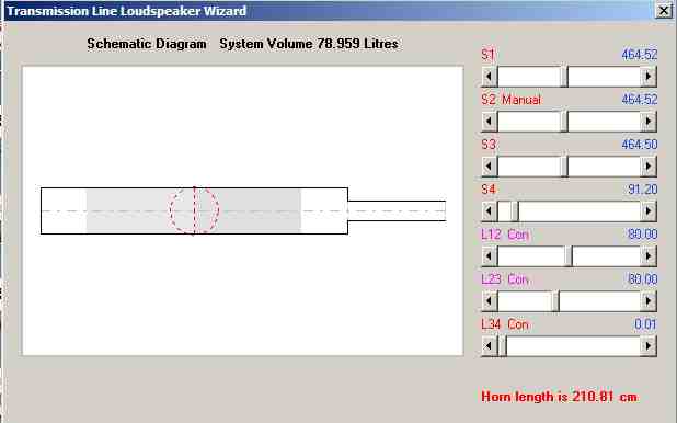

The LAB12 is a very versatile driver. It's been used from dual driver front loaded horns all the way to small single driver sealed boxes, and anything in between.
If you are looking at a tall box w/ a small (but not too small) footprint take a look here:
http://www.diyaudio.com/forums/subwoofers/143714-lab12-tapped-horn.html
particularly Posts # 181/188 and 251 for tall tapped horns w/ a small footprint.
Then there are a number of mass-loaded transmission lines in this thread:
http://www.diyaudio.com/forums/subw...ded-transmission-line-od-ml-tl-design-bj.html
For sealed boxes you might look at an internal net volume range from 40L to 70L. For a vented box try V_net=90L w/ 2ea. 3"Dia. x 20" long duct ports. These are net internal volumes, no driver, no braces, no ducts...
Finally, take a look at gedlee's multi sub approach here, practical information in the link in w/ Post #5 (this may involve some tracking down of the information):
http://www.diyaudio.com/forums/subwoofers/134568-multiple-small-subs-geddes-approach.html
Whatever you do, take Art's (weltersys) advice from Post #2, and download Hornresp .

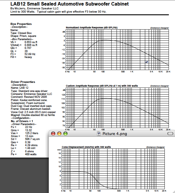

I actually reduced the size of the enclosure to match what was on parts-express's recommendation. In this case, it said:
OPTIMUM CABINET SIZE (DETERMINED USING BASSBOX 6 PRO HIGH FIDELITY SUGGESTION)
Sealed Volume: 0.9 ft.³
Sealed F: 355 Hz
Should I ignore? How does one determine the box volume? The box that I was thinking would be 2ft3, with internal measurement of (1ft x 1ft x 8.75ft)/2 = 2.18ft3 then minus the bracing, driver etc.,

An 18-inch bass driver - I personally wouldn't even go there. The cone is so big you got two issues to contend with: One is unwanted "waves" developing ACROSS the cone material, and the other is flabby muddy response. They are just too big.
Two drivers with effective response from 40 Hz to (whatever) in the same enclosure would have an effective response from 20 Hz to (whatever). They don't even have to be in the same enclosure, simply aligned in the same plane. I personally prefer the multiple smaller driver approach. It just works much better and is probably more cost-effective.
There are benefits to using multiple smaller drivers instead of a large driver. 2 or 4 small drivers react faster and give cleaner, tighter base than a single large driver. Their voice coils will probably dissipate heat better, not a small consideration in the bass region.Smaller drivers can have a higher upper frequency response limit than larger drivers, but in the "sub" context, reaching to the usual crossover region of 100 Hz or less is no problem for most 18", so there is generally no sonic advantage to multiple small drivers compared to a larger driver with the same Sd. That said, multiple voice coils may dissipate heat better than a single voice coil, resulting in less "thermal compression".

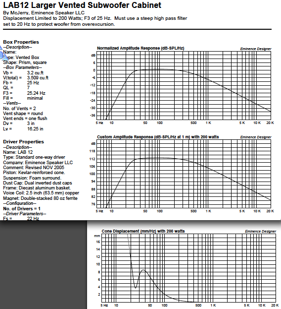

That box size may be appropriate for the trunk of a car (the Lab12"C"was made to take advantage 12 volt amplifiers designed to operate at very low impedance), where cabin gain will make up for the rolled off low frequency, but is not appropriate for a relatively large room which won't provide low frequency gain.I actually reduced the size of the enclosure to match what was on parts-express's recommendation. In this case, it said:
Sealed F: 355 Hz
One determines box volume by multiplying height x width x depth, then subtracting the bracing, driver etc. Your example seems to be only half of what it should be.

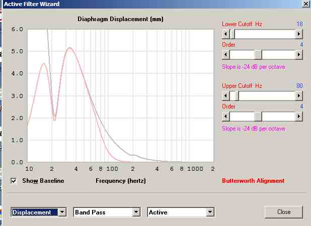

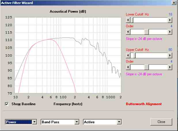

Driver TS parameters, box volume and design all determine frequency and phase response. As TB 46 says, the Lab 12 is a very versatile driver- I have used them in dozens of different enclosures, each fitting different design goals.
Here are two examples of quite different responses in simple cabinets, using tapped horn designs can increase output another 6 dB compared to the larger ported design, but will occupy slightly more volume.

If I would to use a sealed 4ft3 enclosure (triangle 12"x12" internal) and desire to have 2 drivers, would Lab12 still a good choice? or would some other driver be more suitable?
LAB12C Corner Enclosure - MLTL
Hi toffee123,
Well, as you seem determined to go w/ a corner enclosure:
I have not found a good technical drawing for the LAB12C, so I'm using my old sketch, and even w/ your 12"/12" internal dimensions you have to move the driver forward (thicker baffle) at least 1/2" to make it fit. That may be a good thing, even doubling up (or trippling) on the front baffle w/ 2ea. 3/4" material would not hurt a thing.
With the aspect ratio that develops from using this type of corner box the standard vented enclosure design software will not show the resulting pipe resonances, but Hornresp will. Also, in Hornresp you can design your enclosure as a MLTL (mass-loaded transmission line). I'll attach an example, you can expand on that, the individual dimensions are quite tolerant to being changed, same w/ the damping material.
By the way, I used 50W into 3.11 Ohm in a 1Pi environment, and even then a single driver will give you about 110dB @ 1m. The bottom end diaphragm displacement is easily controlled w/ a 4th order HP set @ 18Hz.
Two of these should give you all the bass you want, a third small sealed sub close to the listener's position might help a lot w/ the room modes.
Hi toffee123,

Sealed two LAB12's (6 ohm version) in well stuffed 3.3 cuft would be fine.
The LAB12C needs to be used vented, with its lower Qts than the LAB12.
rgds, sreten.
rgds, sreten.
