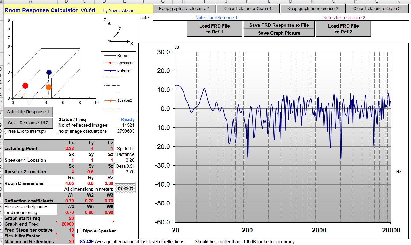

Josh,
Detailed information on your listening room(size-shape-doors-ceiling), seating locations, rug?, acoustic treatments, and positon of large furniture is a good first design step.
free: "Room Response Calculator v0.6d by Yavuz Aksan"
model soundstage for: HT 120" screen vs. seating positions

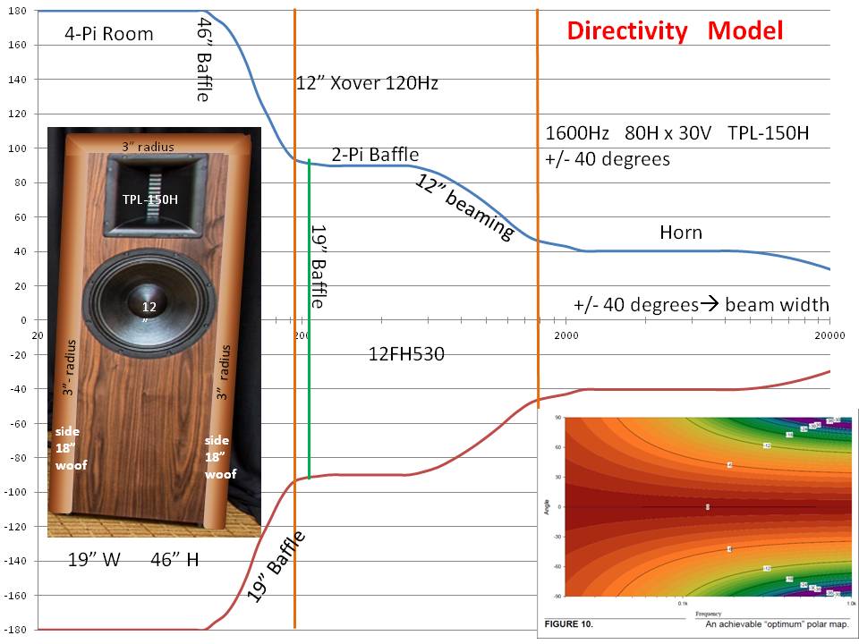

Thanks to Dr. Geddes, many believe that deciding on a controlled directivity curve(function) for your room is a good third step. (wide dispersion dome vs. horn/waveguide)
http://www.gedlee.com/downloads/directivity.pdf
What commercial speakers do you currently favor: (size, shape, construction, efficiency, frequency range, dynamics)?
MAYBE: Research and design speakers for a coherent 5.1 HT speaker system, BUT spend your intial limited budget(~$2K) building just the R-L stereo pair.
Active vs passive size comparison: waveguide with 1"CD + 12" midbass + two 18" woofers

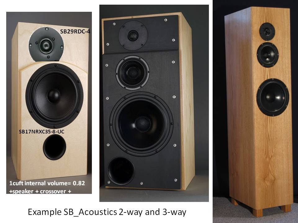

SATELLITE BUDGETING
For (future) center and satellite speakers, modest cost SB_Acoustics drivers in 2-way and 3-way designs are popular because of excellent measurements and reviews.
2-way ~$170 each $110_drivers and $60_crossover parts. ported F3 ~40Hz before room gain
3-way ~$250 each $180_drivers and $70_crossover parts. ported F3 ~30Hz before room gain. Stand or FloorStanding.
These are the lowest cost designs I would invest my time to build.
Excellent construction details on Troels expansive website. Jozua also recommended.
SBAcoustics-3WC
A range of crossovers (LR2, LR4, BW3) are published for these SB_Acoustics 2-way and 3-way configurations.
https://www.tweekgeek.com/bmf-1/
https://www.pinterest.com/localhifishop/tweek-geeks-bmf-speaker-in-the-making/
The Intrusive 1899 DIY Sound Group
SBAcoustics-3WC
