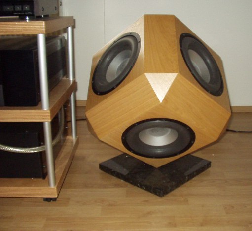

I've posted a few other times asking for design help on this project and recieved very helpful feedback. Now I'm asking for a "ROAST" please give me any pros or cons, likes or dislikes to this 26 sided enclosure shape (rhombicuboctahedron) when used for a sub.
Rule out any complications in construction, I created a Excel program that will determine the exact exterior dimensions for all sides of this shape given any internal volume I plug in. And I own a cabinet shop to build them in.
So far I've built blank .75"MDF enclosures in the following sizes: 1.3cu.ft (10" baffles) , 1.62 cu.ft (10.5" baffles), 2.8cu.ft (11.5" baffles) and 3.2ft (13" baffles)
This enclosure will comfortably hold between 2 and 6 drivers.
Please fire away at this design...I asked for it!
thx...Chris

Why such a complicated shape? In many cases people mention diffraction and reducing standing waves inside the enclosure - without realising that the wavelength is likely to be in the range of 3 to 17 metres and the shape of the box won't make much difference. If each woofer requires a box volume of say 20L, well then the combined volume should be 120L, unless appearances are deceptive and that box is bigger than it looks. I assume the huge black boxes that look like amplifiers will power this beast to keep you warm in winter 😉 ?
I'm assuming your sub is designed for "SPL" - high volume, lot's of stress on each woofer, and if one of them were to stop working, then that wouldn't be particularly good for other 5 woofers either....Unless you made 6 separate enclosures in anticipation of failure. Ok I tried being harsh, but that's the best I could do.

Erm.... not quite true, the shape is inherently
more rigid than an equivalent plain box.
In fact the shape poses somewhat of a drawback in that the fairly large amount of living space it consumes
This is only due to the choice of the base mounting, a
standard box cube could be set onto a base this way.
Personally think it would look quite nice with a
single driver face down and 4 feet on that face.
The well known Linkwitz Transform would need to be used,
isolating each driver is also a choice needed for plain boxes.
Personally I can't see any wrong with the box design
at all, as long as getting the pieces cut is not a hassle.
In a normal orientation it will look small for its size.
Has some similarities with Tannoy's six
sided truncated triangular speakers.
🙂 sreten.

The foot print that this enclosure takes up is surprising. if set on one of the larger sides like a typical sub enclosure would sit the dimensions of the pictured box is 18" x 18" x 18" Whent the cube si truncated in this fashion and set on one of the small corners (like the one in the pic) its footprint turns into 19.5 x 19.5 x 19.5. So it really does not consume much more space than a box.
Admittedly this enclosure was built based on aesthetic. While it may not fit the design aesthic of most homes I wanted something that would work in my home (modernist architecture).
This enclosure allows for great flexibility. You could, if crazy enough place drivers on all 6 sides.
I will gladly provide the exterior dimensions for people if they provide me with a target interior volume.
Can you guys recommend any driver arrangements. I have a bunch of these enclosures to experiment on.

I’m a big fan of unconventional and unique enclosure designs, so I love the looks and the design. However since you asked for critiquing I will have to mention the one drawback I see, Price, 4 to 6 woofers and the power required to move them to reference levels would be IMO too much considering you can do the same thing with a single woofer and 2 passives in the same size and shape box.
I really like the way the box looks and the stand shows it off nicely, but the cost must be astronomical.

Please recommend some more driver configerations. I mentioned 4 or more drivers but 2 are fine or even 1 plus a PR is absolutely fine. I agree that the cost is too high for practical applications if you load this sub with so many drivers. However, the way the sub sits really screams out for at leats 2 of the exposed side to be occupied by either a driver or PR.
I might not have been too clear about my goal.
My total target budget for this project is $600
The cost I can produce this enclosure for is $275 out the door
What driver + plate amp configeration might work well on a budget or $325 (not including the prefinished enclosure) in your opinion?

This subs was built to do the same thing as any sub was, to reproduce bass frequencies. And it's probably better than a traditional box for the simple fact that all the sides are as small as possible, making it more rigid than most, unless their built with 1" or 1.5" MDF. Even then, this one is probably still more rigid, due to all the bracing for all those corners.

Any idea what the internal volume calculates out to be? That might help with driver recommendations.
It is a gorgeous piece of woodwork, and i am a big fan of enclosures that aren't just plain boxes... funcionaly thou it is pretty much just a cube, which would be easier and less expensive to build.
As to drivers -- i always like to use pairs in push-push (ie opposite sides). To maximize the visual potential you would need to use 4 smallish drivers with relatively small Vas. Perhaps 4 of the ApexJr 8" subs. You could get away with 1.35 ft^3 net volume.
Excluding shipping costs that would leave you $185 for a plate amp -- enuff to get Steve's big plate amp (with $25 left over for shipping).
