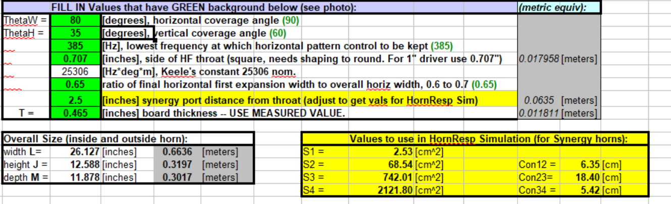

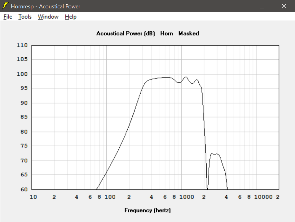

Objective:
1. Pattern Control down to about 400 Hz or below
2. Needs to be able to fit within about (28W x12.5H x 17D) inches - the internal dimensions of the top section of my klipsch belle inspired clone.
3. Intend to use a pair Klipsch Belle Bass Bins below 400 Hz
4. I picked the GRS 5SBM-8 ( GRS 5SBM-8 5" Sealed Back Midrange ) intending to use a quad of them
5. Highs will be either PRV Audio D290Py-B (PRV Audio D290Py-B 1" Polyimide Horn Compression Driver 8 Ohm 2/3-Bolt) or Tymphany DFM-2535R00-08 ( Peerless by Tymphany DFM-2535R00-08 1" Compression Horn Driver 2/4-Bolt 8 Ohm ) or even the Dayton D250P which I own (and happen to like) ( Dayton Audio D250P-8 1" Polyimide Compression Horn Driver )
6. Intended crossover freq based on 1/4WL of tap length (2.5") = 1346 Hz
a. Need to see if this is physically possible
b. Do I need to account for distance from compression driver diaphragm to horn throat - effectively reducing the tap length by the same amount (or reducing the max crossover frequency accordingly?)
Any thoughts / criticisms welcome .

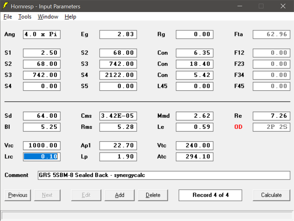

FWW, I pulled the T/S params off another post as I don't yet have hte GRS mids to measure.
Also, can someone explain why what relevance Vt and Atc have for MEH / Synergy horns. I thought all I would have needed to pay attention to were Ap1 and Lp.
Lastly, I'm a bit confused by the rule of thumb mentioned here - I think I satisy it but am not sure if I'm optimal or not .
https://www.diyaudio.com/forums/mul...e-bandpass-mid-unity-horn-29.html#post2668437

Suggest you use the Multiple Entry Horn model, rather than the OD option.
I find the MEH model confusing to use . I'd be glad to write up a tutorial if you can spare some effort to clarify my questions on this thread

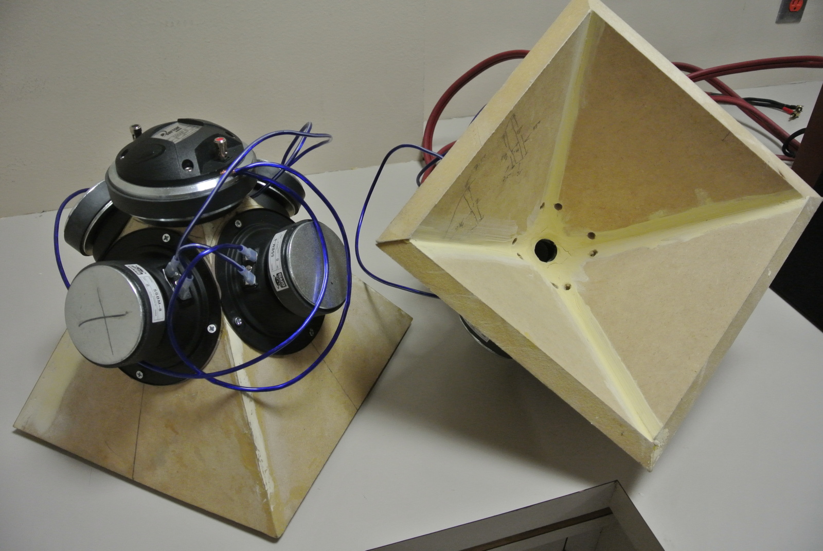

Hello Zobsky, I will paste some info I found regarding MEH on diyaudio. Maybe you will find answers (and more questions 🙂 ) in this text. Here it goes:
If you can't get a 3" mid to go higher than 900hz on a Synergy horn it's time to find a new midrange IMO.
This is not the case. In every case I've found the tap in point to be the reason why the mids drop off too early.
Even piece of crap Curtis Mathes mids can work well into the 2KHz to 3KHz range.

Most people are using flare rate and cutoff frequency interchangeably. A driver tapped into a Synergy style speaker will not play LOWER in
frequency than the local flare rate/cutoff frequency. A driver tapped into a Synergy style speaker will normally play up to a frequency where
the circumference of the cross sectional area of the tap is equal to one wavelength.
Example: You have a mid tap into the horn where the area is 60cm^2. To find the local flare rate/cutoff frequency you use Horn Response to
calculate the length it takes for it to reach 120cm^2 (a doubling of area). Lets say it takes 4cm to go from 60cm^2 to 120cm^2 in our conical
horn. Highlight the horn segment in Horn Response and press the E key on your keyboard to change the horn profile from conical to exponential.
The flare rate will now be displayed. In this example it should tell you the flare rate is 474.37Hz. This is how low you can expect the mids to play
provided there are not issues with your horn build. Now to figure out how high it will play. We can calculate what the circumference of a circle
with an area of 60cm^2. It is 27.45cm long. a 1248Hz sound wave is 27.48cm long. Therefore we can expect our mid to play reasonably well
between about 470Hz - 1250Hz. One last detail is the cancellation notch. If you space the mids too far down the horn, the notch will over ride
everything. If the notch occurs at 1000Hz, than that is highest you will get out of the mid.

re' Also, can someone explain why what relevance Vt and Atc have for MEH / Synergy ho
Vtc and Atc affect the steepness of the acoustic low pass filter that is formed by the bandpass chamber. Trapping too much air under the cone lowers the cutoff frequency. They also interact with the port area and length. Play with all these parameters to optimize your mid's response.
If you require any clarification on how to use the MEH functionality in Hornresp, I would be only too happy to oblige.
As a starting point, try reading the Multiple Entry Horn Wizard section in the Help file, and then create an example design using the Input Wizard, accessed from the Help menu.

By the way, I had a lot of trouble understanding how to use the multiple-entry-horn wizard in Hornresp, too: https://www.diyaudio.com/forums/subwoofers/119854-hornresp-554.html#post4364005
But when I finally figured out the secret handshake, it worked quite well. It's probably worth your time to make it work at least once.
IMO Cask05 has a good point (post 7). Also see note below.
Conflicts with the above 🙁2. Needs to be able to fit within about (28W x12.5H x 17D) inches - the internal dimensions of the top section of my klipsch belle inspired clone.

This driver configuration has been done before.
Suitable midrange cone, for bandpass mid in Unity horn.
See post 1658 (picture)
Note that you could improve the driver positioning. He placed the mids so they were centred on their horn walls. The flanges touched, which limited how close to the throat he could get them. If you offset each driver by ~2cm from the middle of each horn wall, you could pack yours slightly closer in.
You could also tighten it up by grinding / sawing some material off the flanges.
Posts 1654 and 2033 in that same thread are pertinent to your other questions.

FR plots from that earlier build (post 2033) indicate the mids would need 12dB of HF boost for a cross that high.
To me, that much response sculpting requires active eq. Or you could use a more robust HF driver to cross lower down. Or you could do both. I prefer both.
Agreed. My guesstimate is > 1kHz.It's going to lose vertical pattern control at about 600 Hz or higher, depending on the actual height of the horn mouth with flanges (which are assumed to be there taking up real estate).

NOTE (1)
A minor trick to simplify the construction (if using basic tools).
I recently built a basic Syn prototype with dimensions very close to what Cask05 recommends.
I picked 90 x 65.52 degrees (horizontal control to 400Hz, vertical to 750Hz).
Using these angles set the angles (z) and (r) in Synergy Calc to 45 degrees and 22.5 degrees. I own router bits with these angles - it makes for an easier build than going with 60 degrees vertical.
Chris

Confused - which thing do you think is too low?
It's of course not really too low for a 1" compression driver of good quality to cover. But if you're going to do that, a 1.4" to 2" compression driver of either single or dual diaphragm type can eliminate the need for the cone midranges, the very close spacing of the midrange off-axis ports (which can lead to anomalies in coverage and frequency response near a 1-2 kHz crossover point), and the issues that I've seen with the crossover design to pull it all together with flat response and still have very good phase/group delay through the most sensitive frequency bands of the human hearing system. I'd rather get farther away from the throat of the horn with off-axis ports and leave the job of the HF crossover to the compression driver manufacturer (e.g., BMS dual diaphragm) or even eliminate it altogether using a single Be-diaphragm compression drivers of 1.4-2 inch size. The distortion is lower than 1" drivers. I also find that it's easier to control crossover amplitude/phase and combined directivity effects in the horn the farther the off-axis ports are located from the throat.
