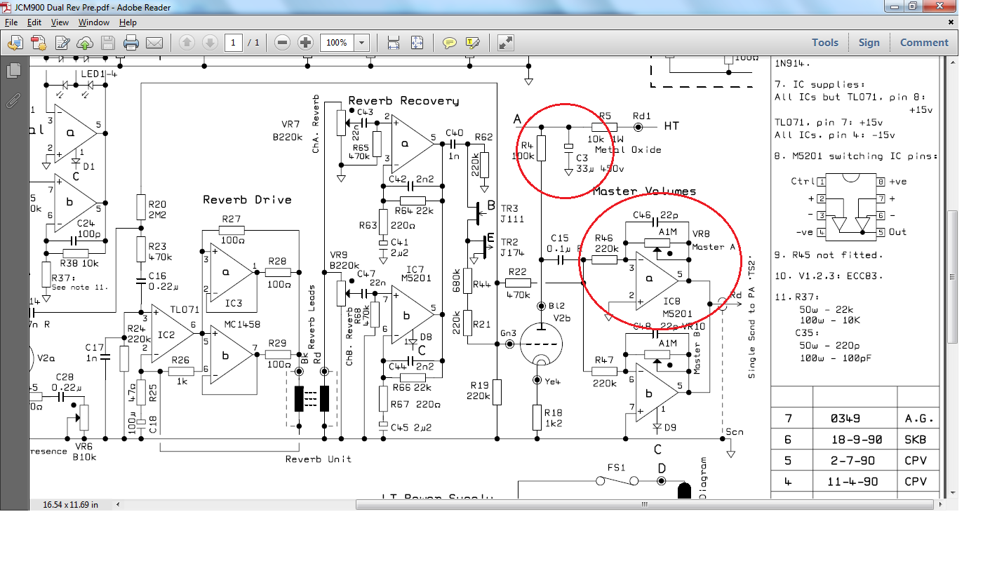

Can you please critique my basic analysis of the master volume design in these amps. My amp has developed a hum problem, and during the course of tracking it down (still haven't, more on that later), some questions have arisen in my mind, funny that.
My questions center around the implementation of the 1Meg pot in what appears to me as the feedback loop of each OpAmp. Actually I'm not even sure if it's in the feedback loop, as it's different to the Tubescreamer gain feedback loop, for example.
I have not decided which extreme of the pot dictates full volume or no volume. Logic says to me that when 'shorted' there is an easy path for the guitar signal around the OpAmp, but then there would be no amplification factor and I'd have to assume that the OpAmp is being used purely as a switch.
The reason I'm analysing this, is I'm trying to narrow down where my hum is emanating from. My hum is occurring with no guitar inserted, and only when I turn up the master. This happens with both channels. Am I correct in assuming that the hum must be emanating from further upstream in the preamp? The main dual-section caps were replaced not long ago just so you know.
My shortlist of usual culprits:
1. C3 preamp filter (changed, no improvement).
2. Low voltage supply caps and Zeners (changed Zeners as there was a slight voltage mis-match, no improvement, will entertain replacing caps C21, 22, 31, 32).
3. A noisy OpAmp.
4. A leaky coupling cap passing some DC between stages?
I have substituted all valves.
Obviously I have not invested in a scope yet...it's on my sizeable want list and is juxtaposed with paying bills, feeding that cat and self, etc.
Any insights appreciated.
View attachment JCM900 Dual Rev Pre.pdf

The volume control is a classic 'Baxandall' active type and does indeed work by altering the feedback factor. You get minimum volume when the pot is at minimum resistance.
Having the two opamps in parallel is done to increase drive ability, however at face value (as drawn) it is very poor design indeed because even the slightest gain imbalance will cause one or other opamp to effectively work into a 'virtual' short circuit as it tries to force current into/out of the other opamp. Hard to believe it is actually like that in reality, however...
Opamps in themselves don't hum so they can effectively be discounted.
Try removing both R20 and R23 and seeing if the hum disappears. If it does then the problem is most likely in the part of the circuit to the left of these parts.
Ideally you need to use an oscilloscope to look at what is happening. The problem could easily be in the power supply, perhaps the HV supply to the valves.

I must say I'm not sure what you mean by "increase drive ability". Can you elaborate? I always understood this to be a switchable master volume design.
Sorry Mooly again you are not in the Guitar World.Having the two opamps in parallel is done to increase drive ability, however at face value (as drawn) it is very poor design indeed because even the slightest gain imbalance will cause one or other opamp to effectively work into a 'virtual' short circuit as it tries to force current into/out of the other opamp. Hard to believe it is actually like that in reality, however....
Those Op Amps are NOT in parallel.
M5201 is a *channel switching* dual Op Amp, so a blessing in a channel switching Guitar Amplifier.
Basically a TL072 but both halves, which have a common output pin: #5, are never ever "in parallel" because either one or the other is ON or enabled while the other is OFF, depending on control voltage on pin 1
Hard to believe but that´s reality 🙂

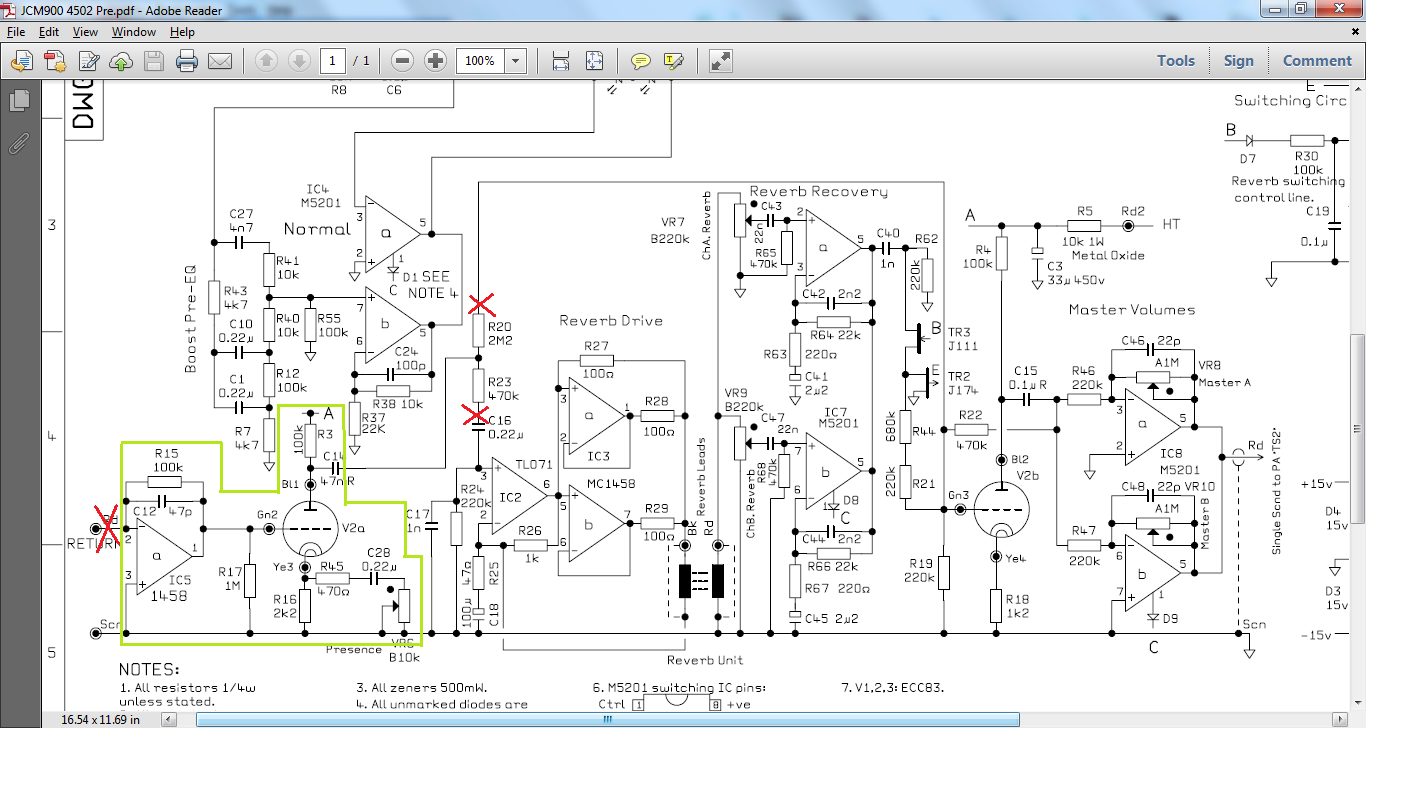

Regarding this amp, I have:
1. Lifted points indicated by red crosses in this new attachment, hum still present, still changes with master volume.
2. Disappears with V2 pulled.
3. Lifted C15, R22 noise gone.
4. Lifted R21, 23, noise still present.
Could something within the green box actually introduce noise through the HT (A)?
I can't see how noise can be introduced any other way, as the only other connections are ground connections. Maybe a bad ground connection?

Lets try and work with these logically:
So you have R20 and R23 lifted and hum is still present. That shows hum is entering after this point.
Something bothers me here and that is the point I mentioned earlier in that C15 and R22 are drawn as being connected together. That doesn't compute to me... given that the final opamp is a switchable one and so either one or the other opamp is feeding the output, the diagram seems to show that both opamps receive the same signal.
Can you just do a quick check and confirm or otherwise that these two components are or are not not joined.
If they are joined then what is the difference to you as a user when you have Master A or Master B selected. Both opamps use identical circuitry and component values. I can't see any differences there, even the pot is marked as being wired in the same direction.
If there was a ripple component on the HT line (marked A) then logic suggests that would still couple to the opamp via C15 and whether or not V2 was present. Yet it is quiet with V2 removed.
Is V2 back in place now or not?
We also need to know what those opamps are doing (that common connection again) and which opamp is active.
At this point I would also suggest trying C15 and R22 individually to see if the hum is entering via just one or via both.
Lets concentrate on that before considering anything more.

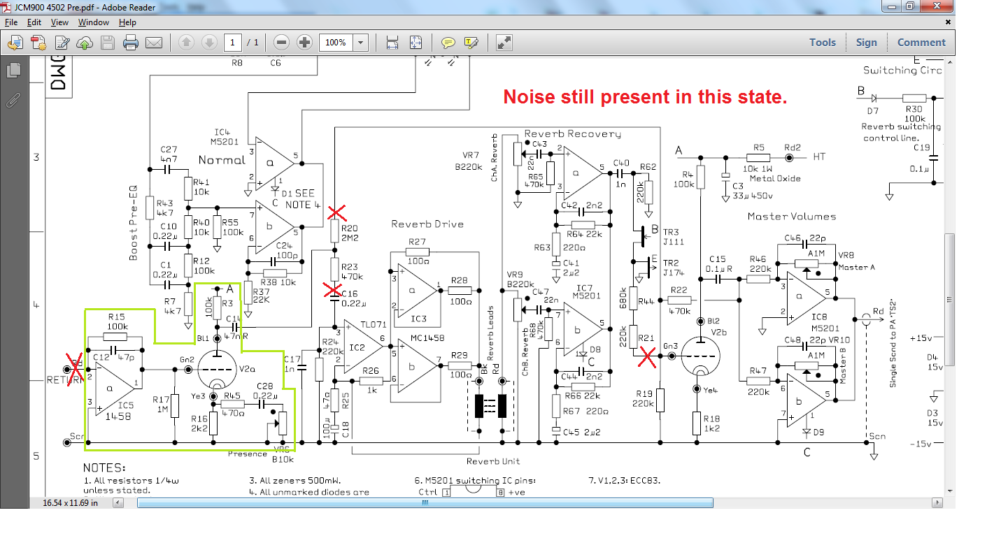

So we know that with C15 and R22 fitted (and V2 in place) there is hum and with C15 and R22 removed it is quiet.
1/ Now fit just C15 see if there is hum or not. Yes or no?
2/ Remove C15 and refit R22. Hum, yes or no?
Hopefully that will give a clue as to the route the hum is entering.
If it is via C15 then is it possible there could be some problem with V2 itself and that it is allowing the filament voltage/current to couple into the audio chain. Valves can suffer from heater/cathode leakage and shorts and I'm assuming the heater supply is conventional AC. You mention it was quiet when the valve was pulled.
Have you swapped the ECC83 around as a test. Try using V1 in its place and leave the V1 position vacant.

Thanks for all your contributions Mooly. I replaced R4, R18, and the noise is gone. I'm not sure which did it and at this point I don't have the energy to find out. Maybe one of the joints was dry.
