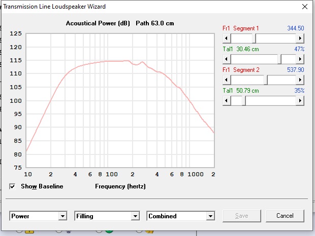

Hi there, I am attempting to design a subwoofer enclosure that will be part of an active crossover 3 way project. This will be my first transmission line project, so I'd like to check with someone with experience.
I'm using A single Dayton DCS205-4 8" driver. I'm aiming for f3 between 25Hz and 28 Hz. The spl graph looks too good to be true, espessially when filling is applied. As this is for a 3 way I would like to get enough bandwidth to be able to X-over above 200Hz.
I don't have the driver yet, so the t/s parameters are from datasheet.
The distance between port and driver is 63cm which takes out the drop from 198 to 280Hz. Will I be able to dampen the peaks with wadding material? Im hoping if i can smooth them enough, then FIR filtering or a few biquads can do the rest with DSP.
I'm fairly new to Hornresp, does it simulate the driver as a point source? If so, given that the cone physically extends over a portion of the pipe, will the real enclosure correct the harmonics in the same way?
Speaker displacement could be an issue, so I will have to be careful with the lowpass design. I have attached images with and without the filter.

HornResp cuves hard to read if you don’t damp it.
F3 is a meaningless number to humans (ref Toole). 😛pkay F6 and F10
The simulated response looks to be underdamped, do not forget about room gain.
As well, 2 (or more) subs are much better than 1. With 1 you will have maximum room modes, which will significantly affect the response you get thruout the room.

Thanks Dave!
I've added some more filling and attached an image. The room is 7m at its longest so the fundamental frequency should be roughly 24Hz ?? What sort of fall off should I be designing for?
This will be a pair of subs, each as a bass cab underneath a 2 way.

you are more interested in the smallest room dimension, it is th eone that causes the most problems higher up.

Good to know, shortest dimension is 3.7m, so more like 50Hz.

Would you recommend re tuning the box higher, or would I be able to get the desired slope more easily with the DSP (this is part of a larger project including a ADAU1467 and class d amps)

I've used the DCS205, in my "Boom Unit" build. Nice driver. But you should use its semi-inductance parameters in your sim
you have modelled your speaker with only Pi*1 (90°) radiation, that would be in a room corner and has +12dB more bass output.
Usually free standing speakers are measured 4*pi.
Another thing is the damping of a TL. Very complex with different materials and densities. Difficult to model with Hornresp
Any folds are not possible to model either. The App is just one dimensional, very good for short straight horns only

Usually 2xPI for subwoofers. Most box modelling programs assume 2xPI, unless you specify otherwise.
2Pi implies no baffle step, only when you have the speaker inside the wall, flat surface.

Subwoofer boxes are usually located on the floor, not mounted up on a pedestal, hence 2xPi space is the best way to model them.
Baffle-step is something entirely different - and usually not really applicable to subwoofers, unless it's a really BIG subwoofer, such that the "step" occurs within their passband.

Well sort of. If the step of a woofer placed against a wall is less than a quarter wavelength there is essentially no transition, no baffle step, and one needs a speaker that is well damped.
