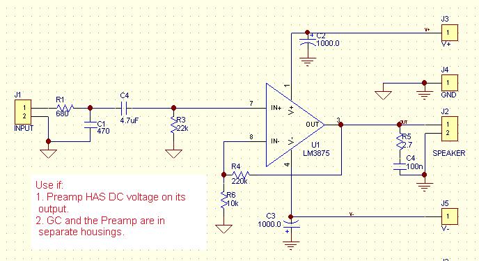

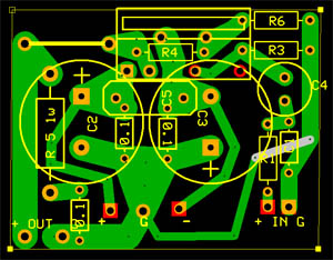

This is my second attemp of PCB design for LM3875 Gainclone . The design is very perliminary . finally , it will be able to accept various coupling caps or resistors size .
I filled up un-used area as common ground and implement the ground star concept . Components to IC distance kept to minimal .
Pin 2, 5, 9 have to be removed from IC to avoid short circuit .

is it made with express PCB? you could double up top and bottom for the higher current lines, that is unless you are just using their program to make your own boards 😉 anyhow. I can not see anything wrong with it but i am no expert.

It is not really a good idea to use ground planes on power amplifers. The stray capacitance involved can cause instability and in power amplifers you need to define where the low frequency currents will flow.
For example in your circuit the charging currents from decoupling caps share the same path back to the "star" as the feedback resistor and the input resistor. This is not a good idea.

Hi Felix, you must get ground point of R3 to the same ground point like have R6 and this " dual ground point " lead by quite separated trace directly to the geometrical middle between main caps. To this separated trace you must also connect input ground. 😎

Power traces + - are too thick. Input gound you must lead directly to the middle between main elyts - you can't use " skip " of ground trace, lead it below input pins.
that is not a "skip", its just because i forgot it was highlighted when i printed the screen.
When you say power traces are too thick, do you mean just the ones between the in and the Caps, or also the ones from the caps to the chip. and what is the reasoning behind it.
i would move the 0.1uF caps closer, they should be as close as possible to the IC's power supply pins.

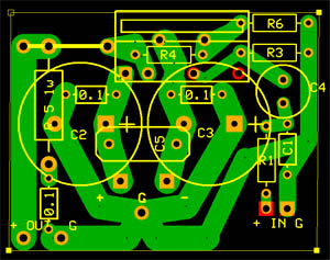

ok, but why? they are allready quite a lot thinner than the other traces, why do you think they are too thick?
No, they are not lot thinner, but only 1 / 3 , what is about 1 mm and it is not enought . This traces must be the same as output trace. Why do you need so small PCB, that you give any devices to the bottom side ? If you will think about better, you will give on this area of PCB all components to the top side. Remember to the possible repairing !
I think he meant to make them thicker, same as output trace. I was a bit confused too, about that, but indeed the voltage supply traces on your board are about 1mm in one part and then the suddenly grow larger. You have still enough space to even them out.
I'm also not sure about that ground trace (from signal input to output). It seems weired the way it's now, why not route it along the edge of the board and make it a bit thicker too?
Some of you might argue, but I run this wire, in my amps, in many different configurations, but I never noticed any practical difference in performance, so now I'm just using the shortest path I can find.

It's fine the way it is as far as GND configuration is concirned. If you can increase the size of the -/+V traces should be much better, BUT you can achieve similar result by just spreding a thick layer of solder on them, that will make them effectively thicker=wider. You can even run a piece of cupper wire soldered along the lenght of the +/-V traces. That'll be even better.

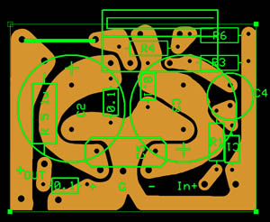

Changed it again, taking advice:
"move 0.1 closer to chip" (theChris)
"put ground around the edge" (Peter)
"make power traces thicker" (everyone!)
I am leaving the 1000u caps on the back of the board, because The dimensions fit better for my case that way than having a larger board.
Also i was thinking of having the copper side up anyways so it will be easy to remove the big caps if i need to. (havent decided yet)
I can always do it both ways and see which is better for me, simple flip horisontal in photoshop 🙂

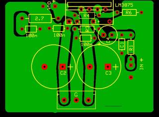

Smoothed the edged of the traces, cant have those pesky electrons bouncing off corners and causing bad sound

You must connect input groud to the geometrical middle point between both grounded poles of elyts ! Your last design will have hum !
