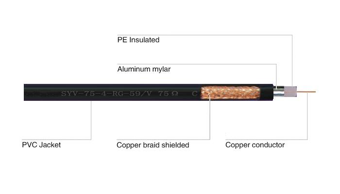

Hi I am trying to source some coax with the following specs...
wondering if it rings any bells for anyone?
75 ohm
Silver plate over copper,
single strand 0.6mm core,
Teflon dielectric insulating material between core and silver plated copper braid.
White Teflon outer covering
Any Ideas?

1:Application,
Applicable to video field, communication system and signal controlling system; video monitor circuitry, broadcast signal control, public TV antenna, closed-circuit TV monitor system; wireless telecommunication, transmission system and unilateral control or internal wire of high-frequency machine.
2:Product Description
Characteristic impedance: 75Ω
Twisted single or multiple strands of bare copper wires as conductor
Solid polyvinyl insulated
Aluminum shielded outside
Bare soft copper wire or tinned copper wire braid shield
PVC jacket
Keeping working temperature under 70℃ for long-range operation

Not sure what your cable is but it appears similar to Belden 1505A - a very common cable in the broadcast industry. 1505 uses foam center dielectric. 8281 uses solid poly but is quite 'ornery' to work with. Go to the Belden site and see what you can find. There are lots of different 75 ohm cables.
