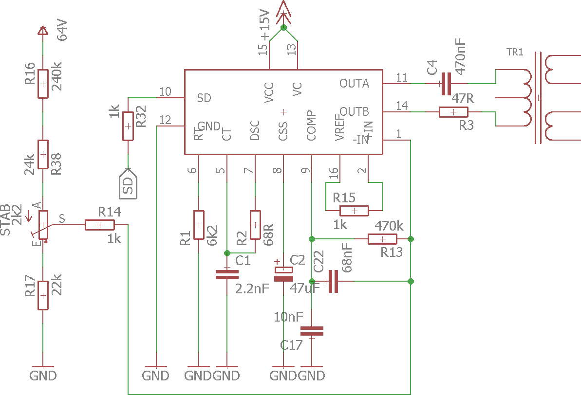

Can You check my SG3525 230V smps driver? It's stabilized +/-32V, but stabilization is connected between + and - output voltages (negative rail is connected to driver ground). The controller has a separated power supply 230V/15V. There's also a output couplet inductor, so output voltages would be equal.
I'm not sure if stabilization will work good. I meat the way of connection R13/R15 and C17/C22 and their values.
Circuit in attachment, sorry for my english 🙂

Hi... I guess, tell me if I am wrong, that this is going to be an offline converter and you will be using a half-bridge power stage driven by a pulse transformer, T1.
The following may or may not make sense but since you have mentioned the use or a Coupled Inductor I have faith.
In the first place it looks like you have connected the reference to the wrong input of the amplifier. It should go to the non-inverting input whilst the feedback goes to the inverting input.
Sometimes it can go the other way around but I think that is the right way in this case.

Thank You for Your anaswer, Sir.
It's a lot of knowledge. Unfortunately, it's probably not my level 🙁
Yes, it's offilne half-bridge converter. I saw many SG3525 circuits and in the most cases, Vref is connected to non-inverting input (pin 2) and Vout to inverting input, but I dont know how it works in SG3525.
Should I connect comparator pin to ground with capacitor and resistor in series?

Oooops. My bad. When I looked at your circuit I got slightly confused with the label orientations on the error amplifier input terminals. You have got it the right way around.
Yes... the rest of my answer looks a bit complicated but, beyond the conceptual stuff, it is more or less just algebra if you can avoid getting too worried about the dT terms.

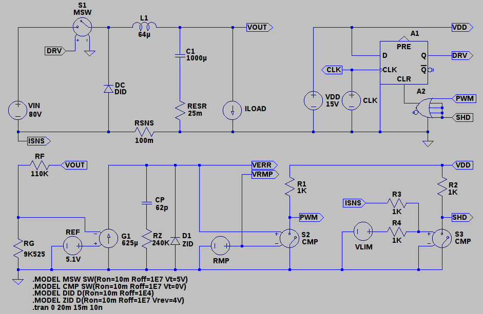

Your Half Bridge is a member of the family of Buck Converters. It is isolated but it works or behaves in the same way that a non-isolated Buck Converter does.
I have attached an 'ideal' model of one. Download the .asc file and open it in LTSpice.
Picture 1) is the circuit.
G1 represents your error amplifier with a forward transconductance, gm, of 625uA. CP and RZ are as shown in the 3825 data sheet. S2 is the PWM comparator with RMP being the Ramp.
There are some other things that you might ignore. S3 is a current limit comparator. Kind of like the Shut Down pin. SHD and PWM drive the latch, D-Type. In your half bridge things will be slightly different. I've used them here to stop the model losing the plot.
Otherwise the other component values plug into the equations given in my previous post apart from the IRt/C. That is the Ramp Slope. In the model this rises 3V in 9.5uS which is or would be the same as 100uA in Rt with Ct set to 317pF.
RZ = LOUT.IRt/gm.VREF.ESR.Ct
RZ = 64u.100u/625u.5V1.25m.317pF
RZ = 253K
With VIN 80V and VOUT 64V the duty cycle will be 0.8

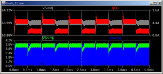

Picture 2) is the circuit in regulation with a 1A-5A load.

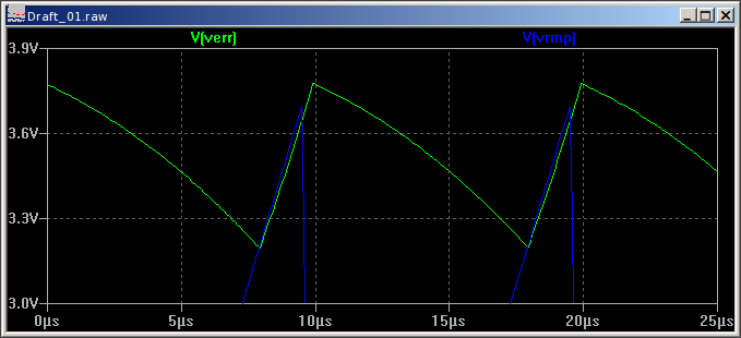

Picture 3) is the output of the error amplifier compared to the Ramp.
As suggested the goal is to achieve Slope Matching and then the rest falls into place. Again you have to worry about how things may be non-ideal or otherwise vary, in particular the ESR of the output capacitor.
Otherwise, as described, the method gives you the 'right' answer and the highest possible bandwidth for this type of converter.

I saw something. You got 80V as Vin, so I guess You took 120VAC as supply voltage, while I use 230VAC, so Vin should be about 160V.
Yes.. Thanks.
Unless R14 makes it easier to lay out the board then it is not strictly needed. However it in combination with your feedback resistors presents an impedance to one input of the error amplifier.
Ideally you should present the same impedance to the other input, in your case R15, to balance and remove the error from input bias currents. Do not make R14 and R15 the same value.
As an approximation R17, 22K, dominates so R15 would be 22K. Of course since you have an adjustment in place you might not care so much but it is always nice to minimise sources of error as and when you can.
You might wish to consider not using the pot at least not as shown. It may be a minor concern but if the wiper goes bad you lose feedback. Make R17 too big and include the option to add a higher value, Adjust on Test, resistor in parallel with it.
R13/C17 are in the right place but you will need to calculate the correct values. I think you may know that but it looks like you have not yet finalised the complete circuit. You might choose to lay out the board with spaces for them and select them later.
Basically pick a 'silly' value for C17... 220n and a low value for R17 then, assuming you have a scope, measure the ripple/slope at the output of the error amplifier and compare it to the Ramp. Increase R17 until they almost match and then recalculate C17 based on the previous sums.
...Yes I often mix up 3525 and 3825. The latter is a similar but better and more flexible high speed controller.
Elsewhere in your circuit:
The gate drive components on the secondary side of the pulse transformer seem to be slightly confused.
Your current limit/shutdown transformer is not connected correctly and you might wish to consider using an LM393 instead of the LM324.
Your main transformer and the output inductor appear to be 'off the shelf components' or you have not as yet finalised them.
Unfortunately, I do not have an oscilloscope. But I could choose these values "on the ear" until the transformer stops making sound.
Yea, I know there is something wrong with connections. But I don't know if using LM393 is required? I mean, if LM324 is to slow to shut down SG3525 on time?

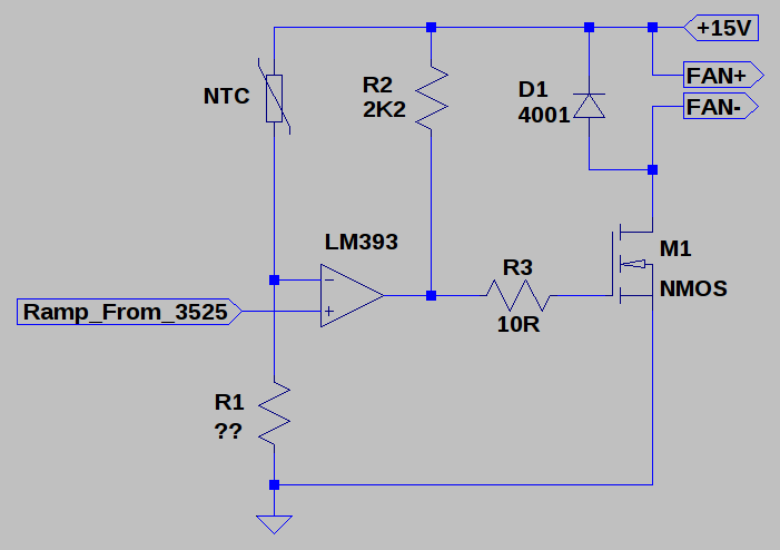

Oh.... as you probably know the LM393 is a 'proper' comparator so not only will its response time be faster, 200nS with 100mV overdrive, it is also a specified/know figure. The LM324 may work and could be easier to interface but there will not be much difference in cost.

Problem is in the PCB layout. I don't have enought space to place two DIL8 chips. Btw, it's comparator with latch, so one pulse is enough to block SG3525.
I noticed the additional components around the LM324 to make it latch. LM358 is the dual LM324 but you can also get an LM392 which I believe is an LM358 type op-amp and LM393 type comparator in the same 8pin package.

My bad, I forgot to say I need 4 opamps. 2 for comparators and 2 for fan drivers. I know on the circuit is used only one. Maybe there is some 4-channel comparator in DIL14 package? And can I use comparator as opamp?
Okay, forger about it. I managed to fit everything on the PCB, I mean LM358 as opamps and LM393 as comparators.
Excellent!
You would not normally try to use a comparator as a, linear, amplifier since they are designed to be inherently unstable. However it may be possible to implement some sort of self oscillating thing. Of course you might also consider using them as pulse width modulators given you already have a RAMP voltage available from the 3525.
I don't have space, I used the rest of it for an additional chip. But since the SG3525 contains an amplifier in it, I would like to use it.
