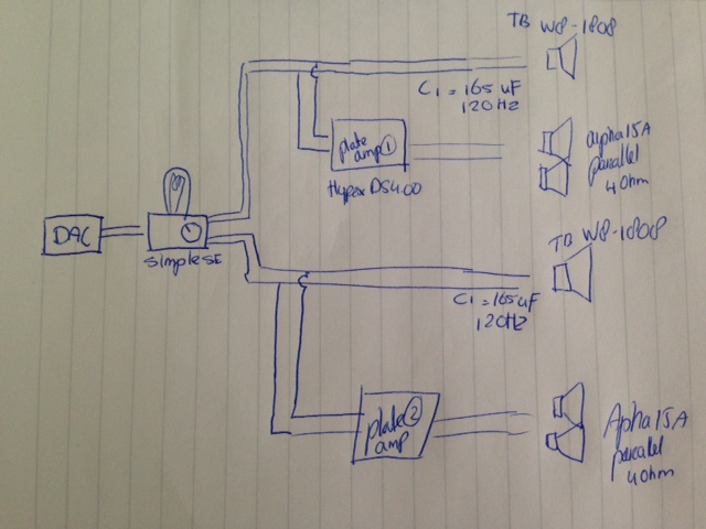

Jock, I feed full signal to tube amp, so I limit low frequencies to the open baffle just by one capacitor, that is enough.
Got it, I will go for the same setup then. This way I can control the volume with the tube amp and tap of the tube amps output as an input for the plate amps.
Could you suggest a capacitator as a starting point for the Tangband W8-1808 and/or give me some advise on where to start or what to look for? (not my expertise at all)

I use ~150-160 Hz...some people might find that too high, but they do not realize I always use two subwoofers, and they are placed right under the open baffles, so technically, those are not subwoofers per se, rather just woofers of multi way setup.

For simple estimation of cap required, I use this...
2-Way Crossover Designer / Calculator
For 8 ohm and 150Hz it comes to ...~130 uF (micro), I use bipolar cap for crossovers in parallel with high quality MP cap.

Looks like a nice plan.
The dirty little secret of Open Baffle is that we put woofers in a box for a good reason. To prevent the loss of low end. You have to account for that when you don't use a box. The woofer will have a rising response on an open baffle of reasonable size. The crossover has to be designed to take this rising response into account.
What you end up doing is trading away woofer top end to get a flat response. That means lowered sensitivity, often as much as 10-12dB lower. It's the trade off of open baffle bass.
There are things you can do to help make up for the bass losses, and you've got at least two of them gong in your design. High Q woofers and more of them. 🙂 The high Q woofers like the Alpha tend to have a fat bottom end that helps make up for the rising response. The other trick is setting the woofer low pass point very low. By setting the electrical low pass filter very low, the acoustic response will tend to come more in line with what you'd want to blend with your midrange or tweeter. You shave off midrange from the top of the woofer response to get a proper acoustic response.
That's the basics of getting a good tonal balance out of Open Baffle. Finding that low pass filter point that puts the woofers where you want them. Many people don't understand this fully, it took me a number of years to get it thru my own thick head.

In the picture below here's a summary of the amplifier setup and Capacitor from what I have learned so far.
Building the Simple SE amp I learned there's a world of 'audiophile' capacitors (ended up with claritycap) and I am sure the same goes when it come to capacitors for XO's.
Can you give me some direction towards what is or are capacitors that are 'generally accepted' as good value for money that would fit the project?

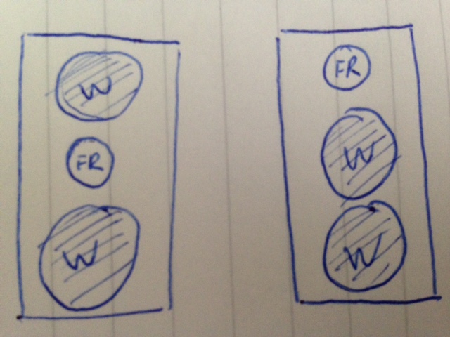

Another question is that I see the full range or mid speaker mostly placed in two positions, see sketch. One is on top of the woofers, the other is in the middle. What is the effect or difference between the two setups?
