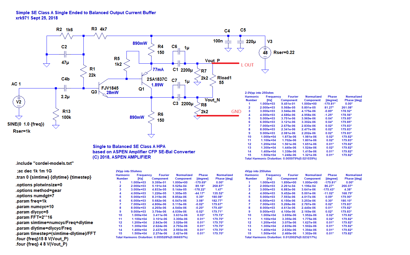

Now, I want to build the 'Balanced Drive 2 Transistor SE Class A Headphone Amp', but I want to support both balanced and single-ended outputs. Can I use the marked red wire as an output single-ended?
