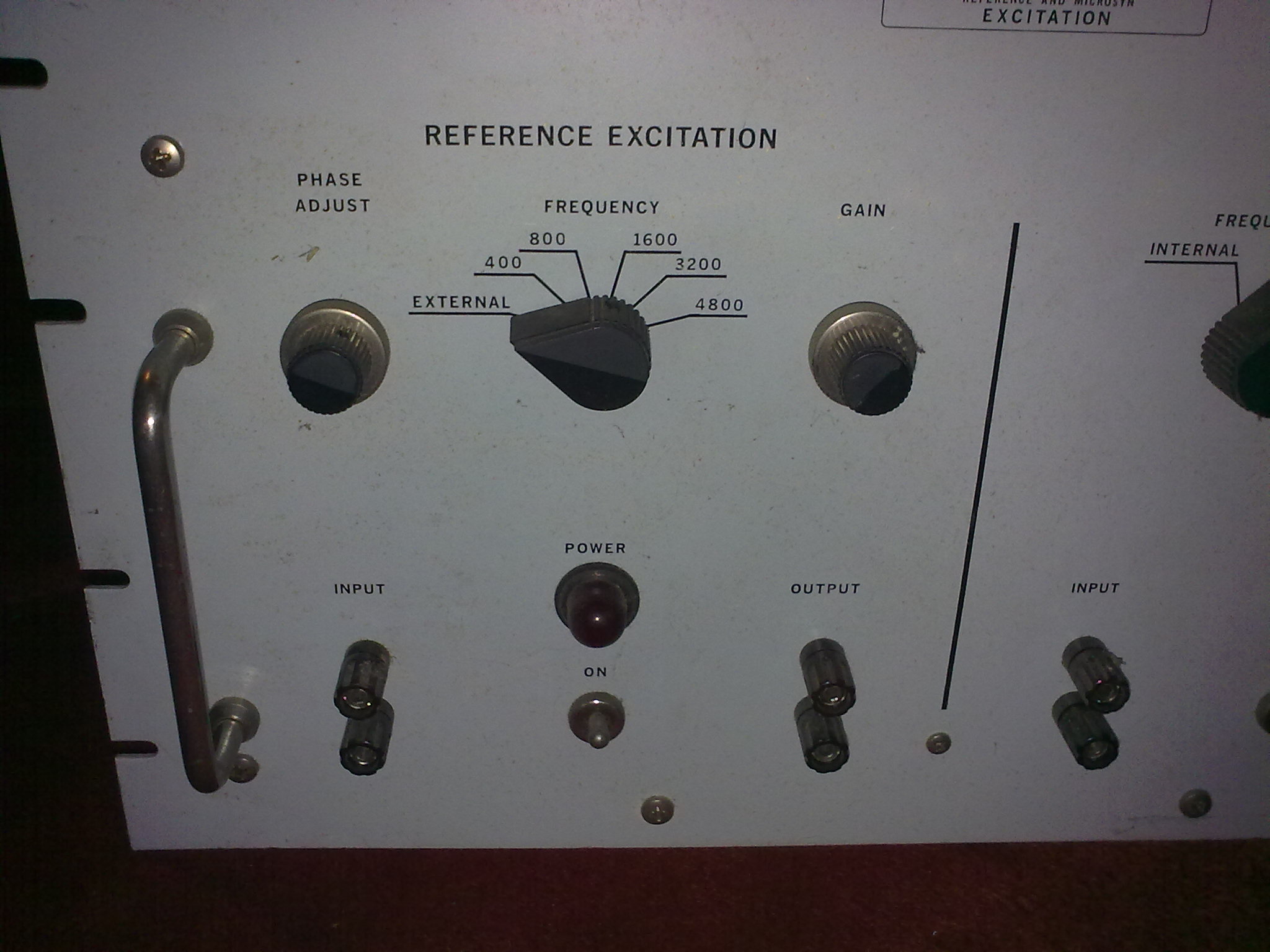

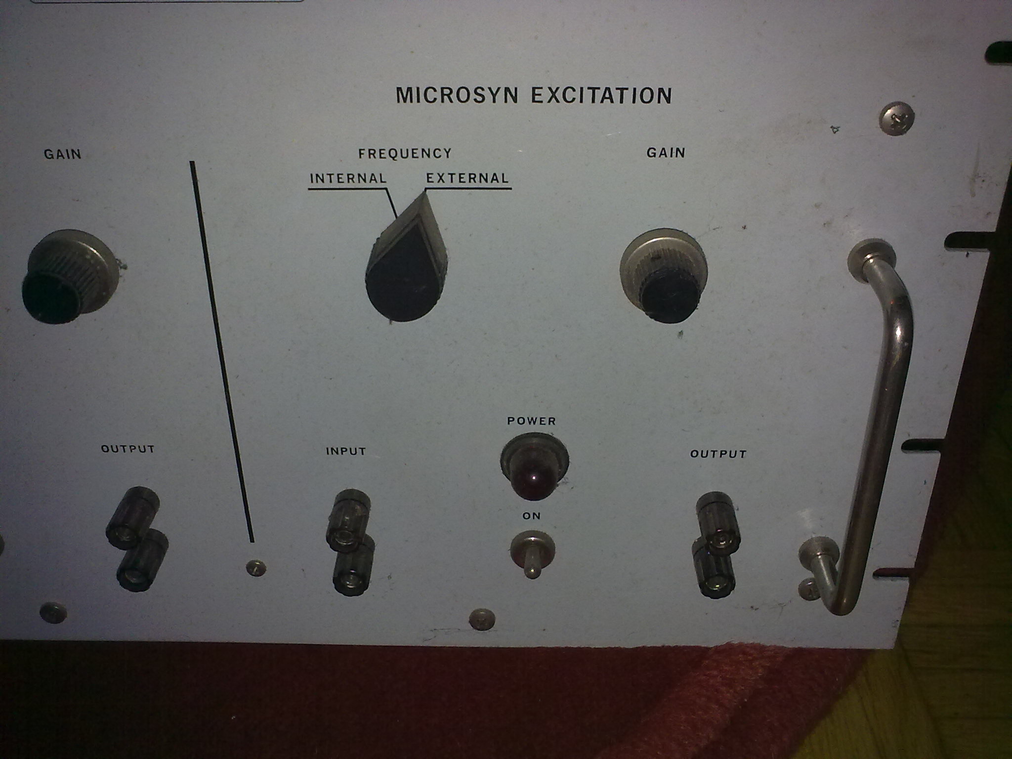

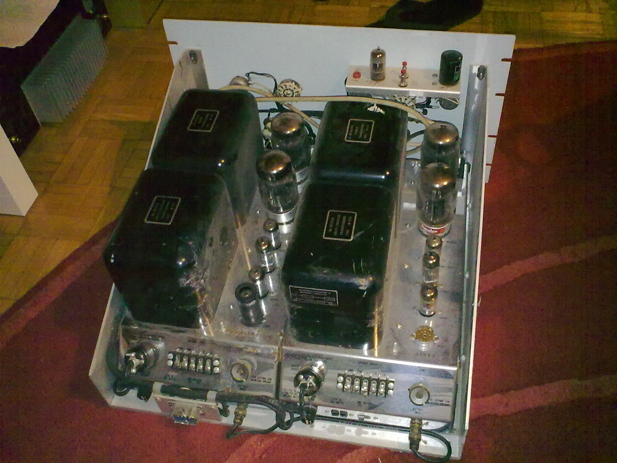

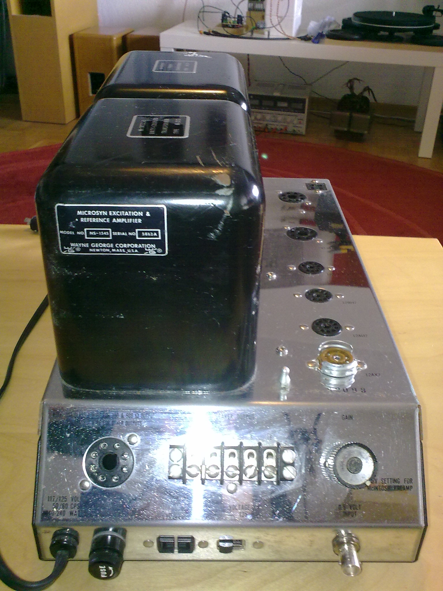

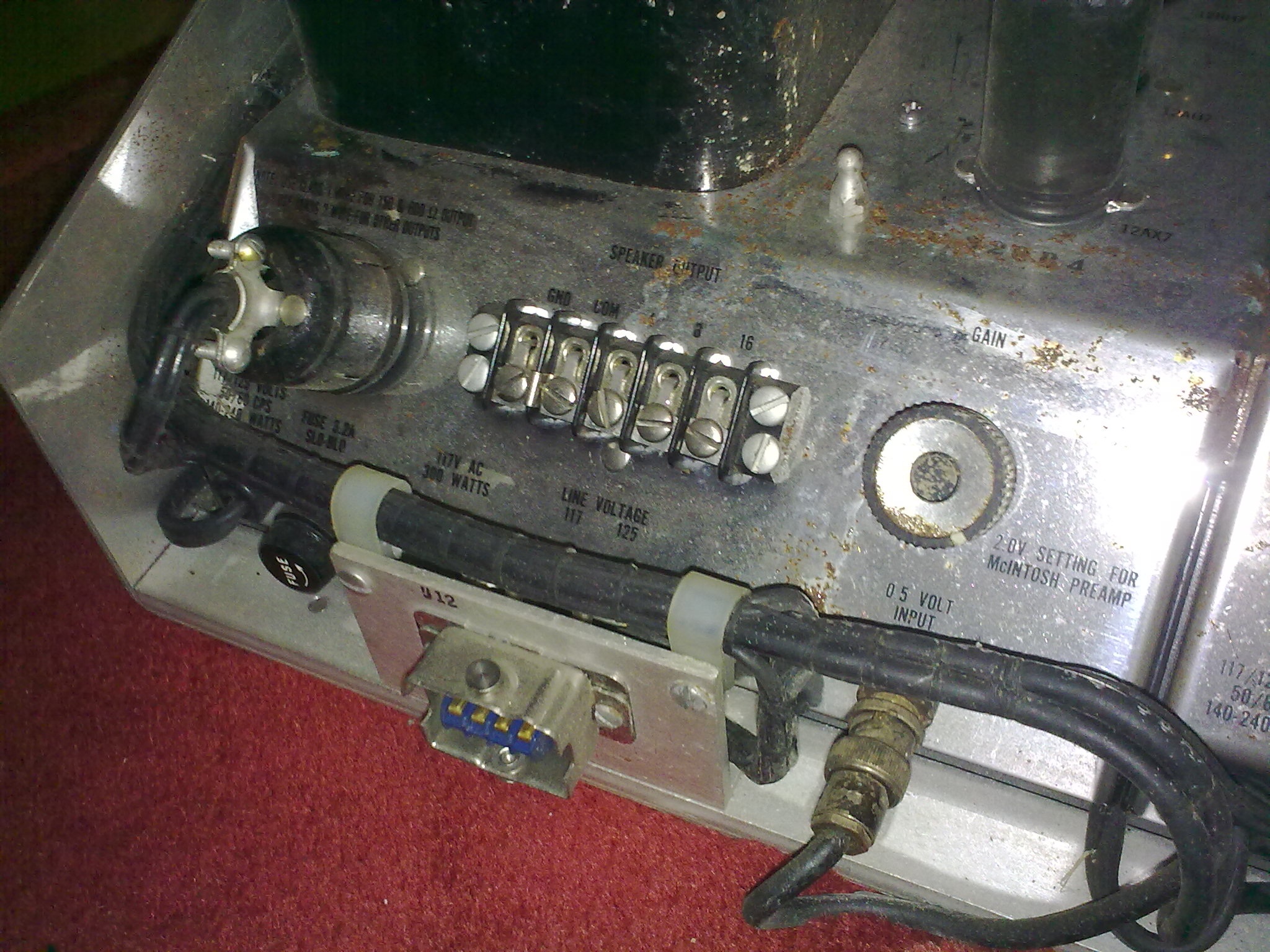

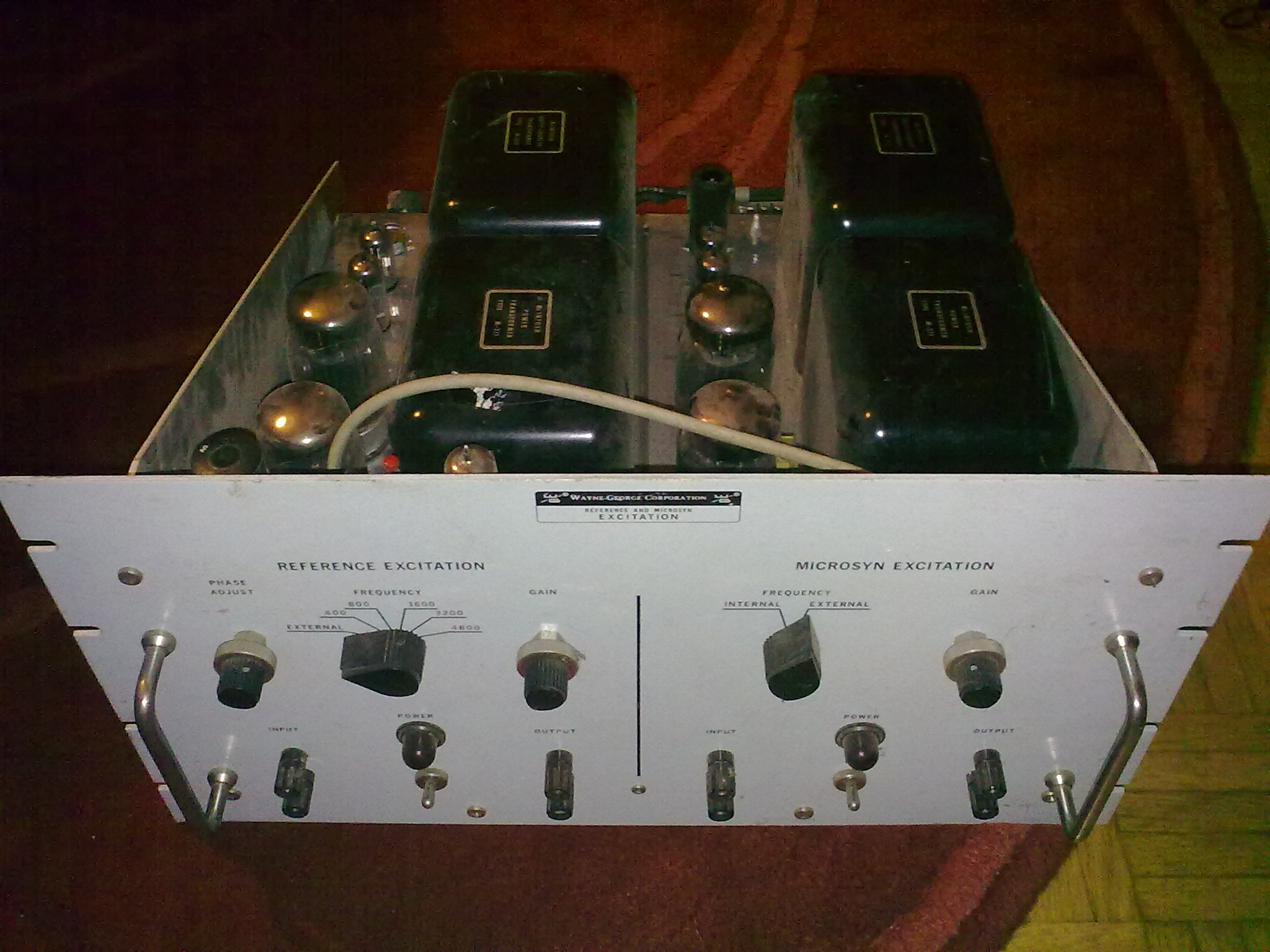

In short, I got this from a friend. It looks like commercial product that uses two massive (OEM?) McIntosh amplifiers. It's really heavy 🙂

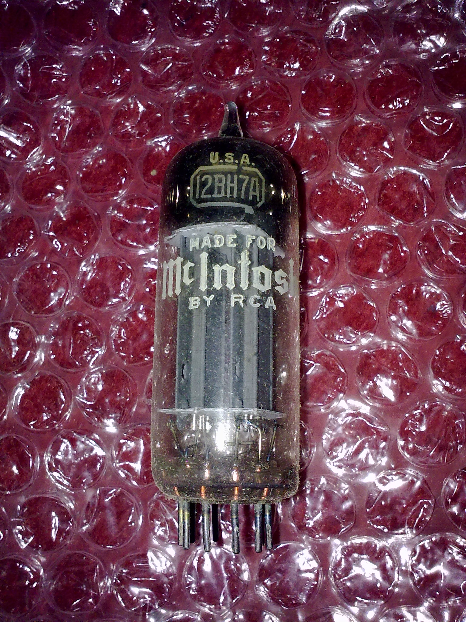

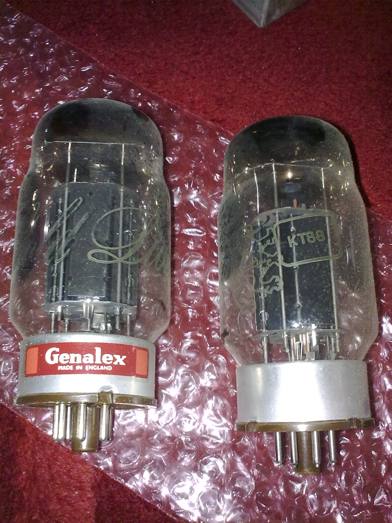

The tubes are 12AU7, 12AX7, 12BH7, 12AT7 and two KT88. The input is BNC and the print next to the potentiometer (with switch) reads "2.0V setting for McIntosh preamp. There is a speaker output-strip with labels "GND,COM,4,8,16". There is also an output-socket that seems to be feeding some higher-impedance loads.
I can make more pics tomorrow. Can anyone identify this beast?
Could the amplifiers be operated @ 240VAC 50Hz with a sufficiently large step-down transformer or would the 50Hz cause trouble (less efficiency)?

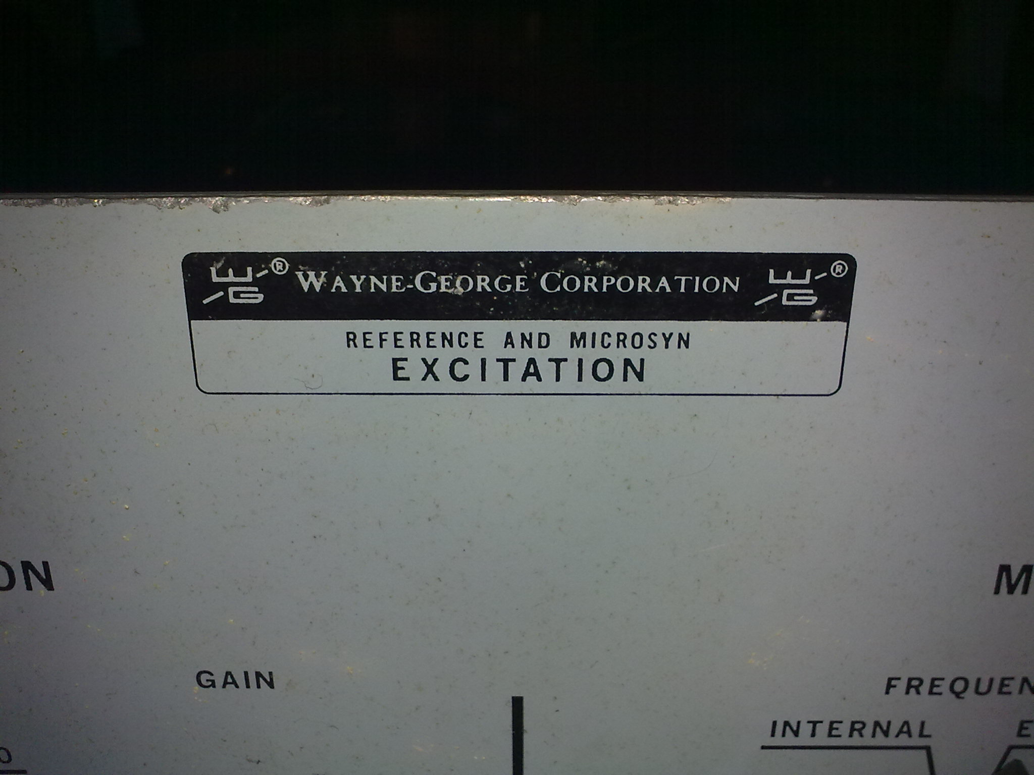

Looks like some kind of lab-grade signal generator...maybe you could remove the frequency-determining part of it and run them full range 🙂

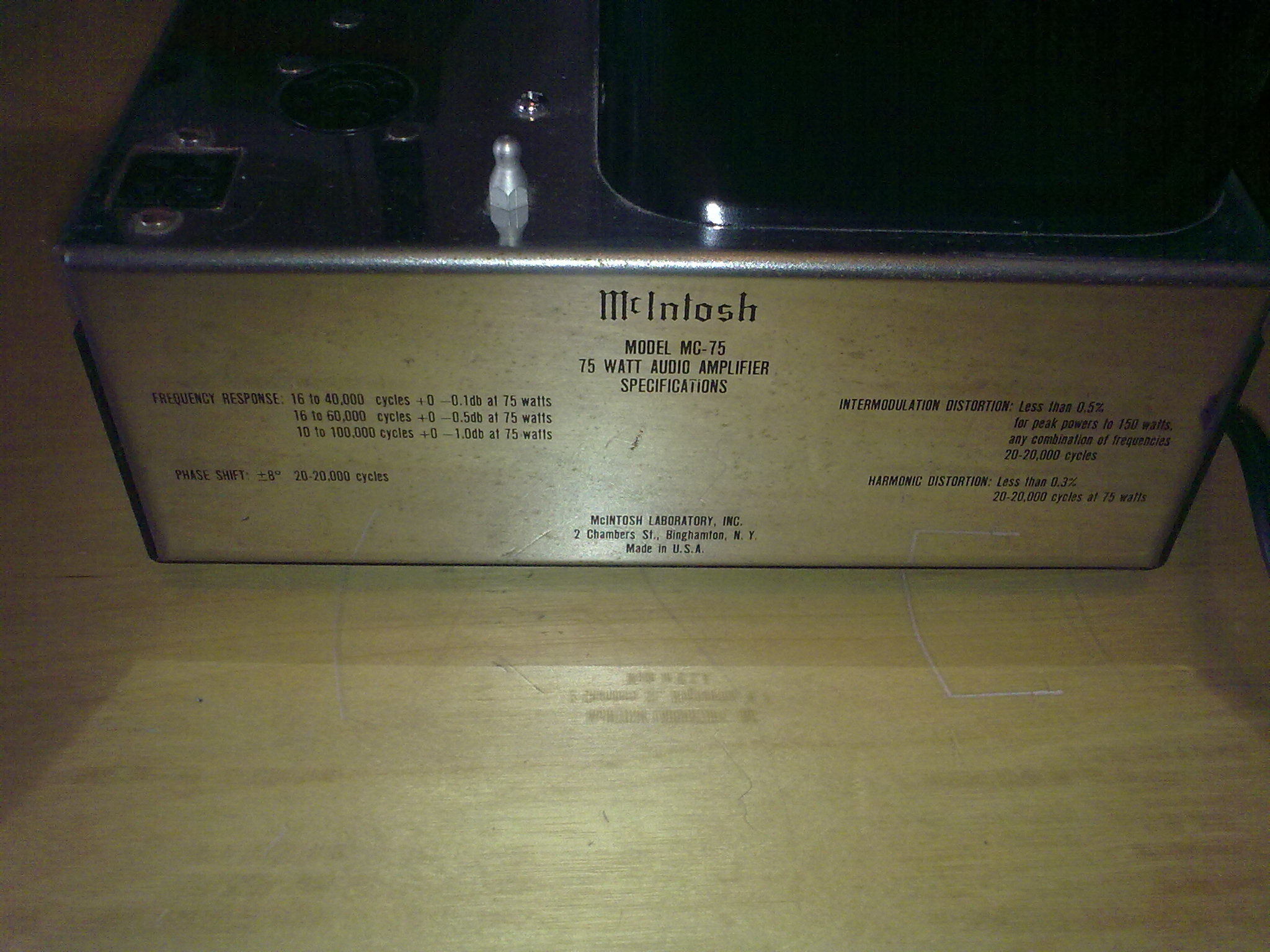

You lucky dog!! They are in fact McIntosh MC75s The output and power transformer numbers clinch it. I'm sure because they are the same as mine.
I do not think it was uncommon for them to be used for non-audio applications. The one I showed above was from a collection we had in a University engineering department. They were used, in our case, as small shaker amplifiers for vibrations testing.

I'll venture a guess and say that's some sort of instrumentation, with a pair of MC75 based amps in it. The MC75 schematic is here.
McIntosh did not skimp on "iron". I don't think you need worry about 50 Hz. mains. Buy a pair of Allied 6K175VCP or equivalent 2000 VA step down autoformers. "Mac" circuitry is Class "B" and you don't want adverse regulation effects in the autoformer. Thank Kevin K. for that tip.

considering that you have two of them , just wire their mains in series ( taking care of phase ) and plug them in 220V wall outlet .

Zen, you've given consistently good to great advice, until now that is.. 😱
These amplifiers run near class B and their power consumption varies significantly with the signal level applied, given that they are also two separate amplifiers with their individual component tolerances there is no way to assure that the voltage delivered to each amplifier is consistent in a series connection. VERY BAD IDEA!!!😡
A few McIntosh power transformers may have had 230V windings, but on American Hi-Fi equipment this is comparatively rare and for export only. These probably do not...

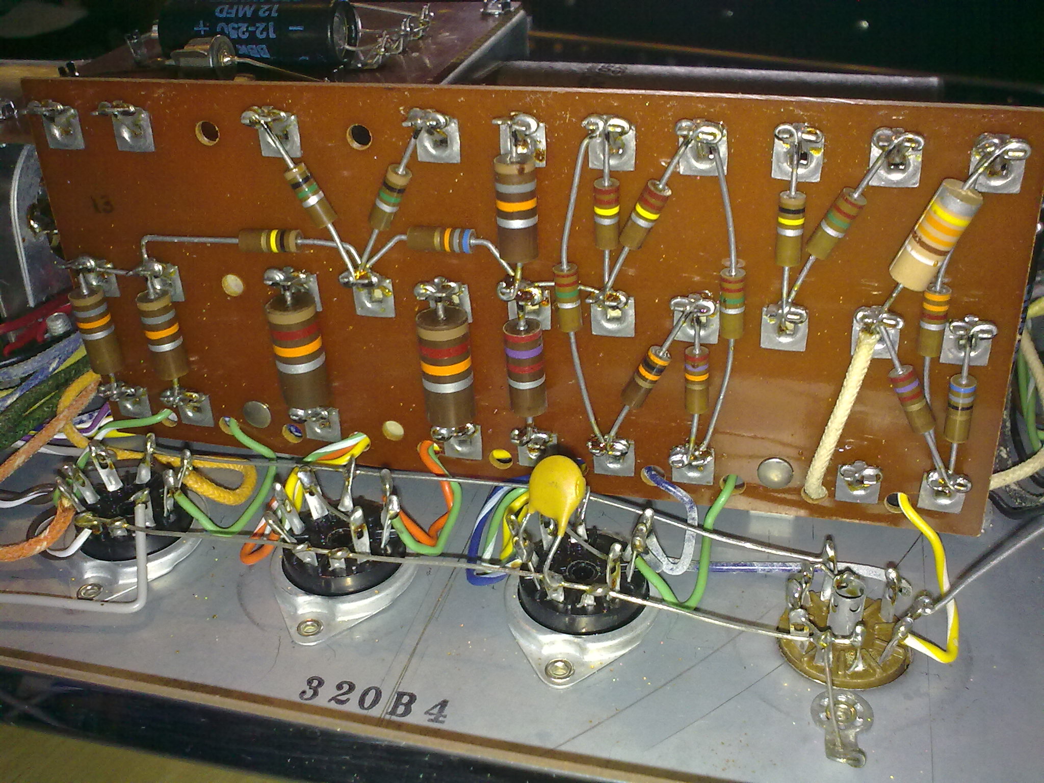

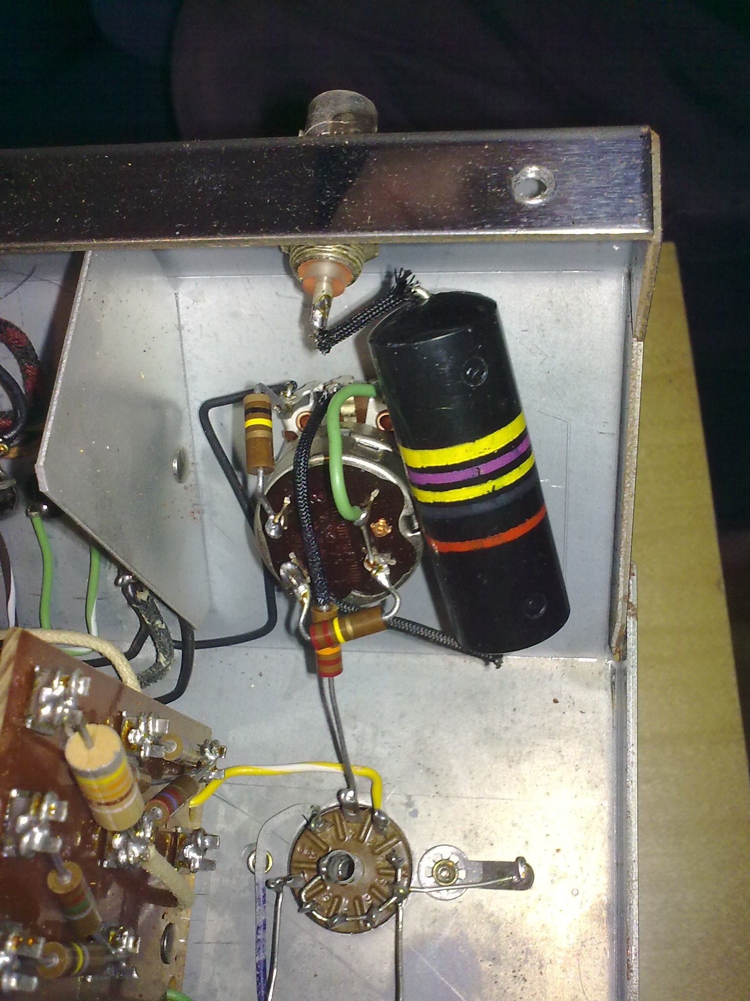

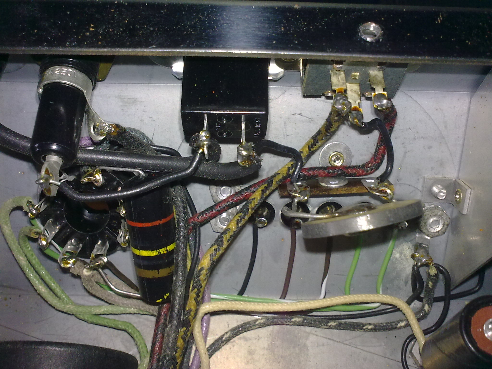

I found time to pull them from the 19'' unit and clean them a bit. Found some nice tubes 🙂
The insides look clean, despite the usual elektrolytics leaking.
Now I have like a hundred questions planning the restauration:
1) Any chance to link the serial number to a production date?

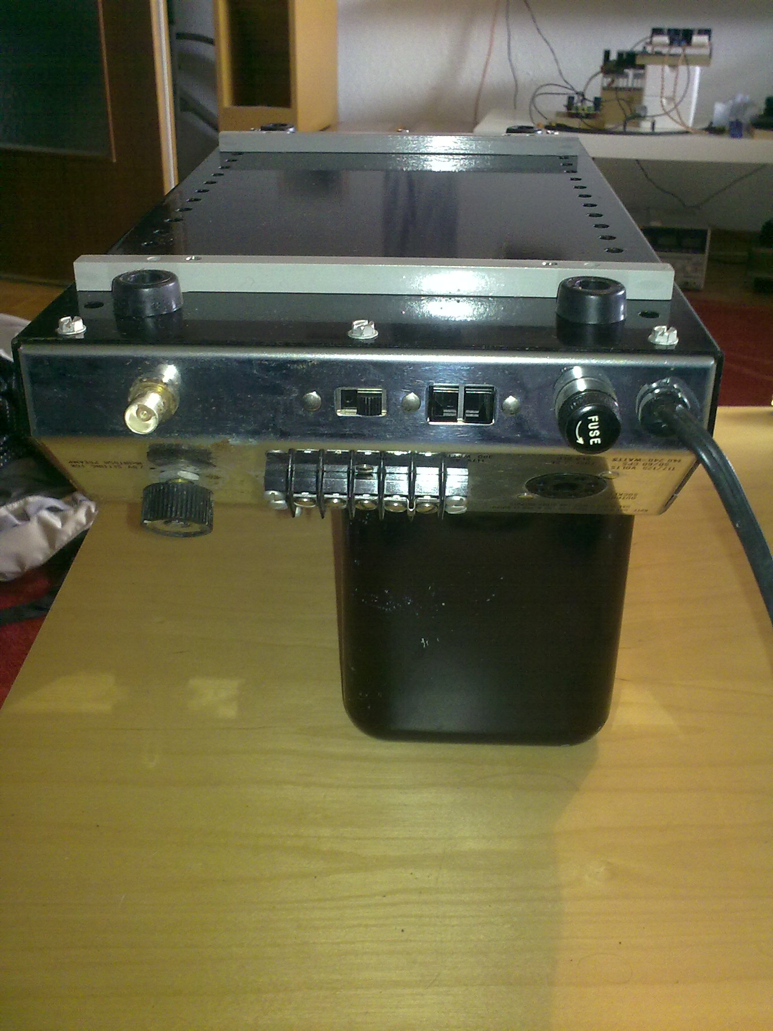

2) The circuit's ground is directly connected to the chassis at the input (see picture) and the chassis is supposed to be connected to earth-ground. Can the connection circuit_gnd -> (chassis=earth) be made with a thermistor? This is common practice in (Pass inspired) solid state amplifiers (see f.e. http://www.firstwatt.com/downloads/F3-service-manual-sm.pdf).
3) Does the circuit's ground connect to the chassis somewhere else? I've already noticed that it does so at the input as the BNC-socket is not insulated.
4) How is the earth connection usually made? My units' power cords just have two wires. Maybe the rack the unit was once mounted in had an earth-connection.
5) How do people usually fit a switch? Or just use a switchable outlet strip?
6) The thermistor in series with the primary...it must go. Any info on a suitable replacement? The cold value apparently is ">25R" but what about current and hot value?
7) Any recommendation regarding what to replace the selen rectifiers with? Just any big fat diode that fits the bill?
8) I'll most certainly replace all the electrolytics. Any info on where to source them? Is it worth using film caps at the output tubes' kathodes (12uF250V)? I'll also replace the film caps.

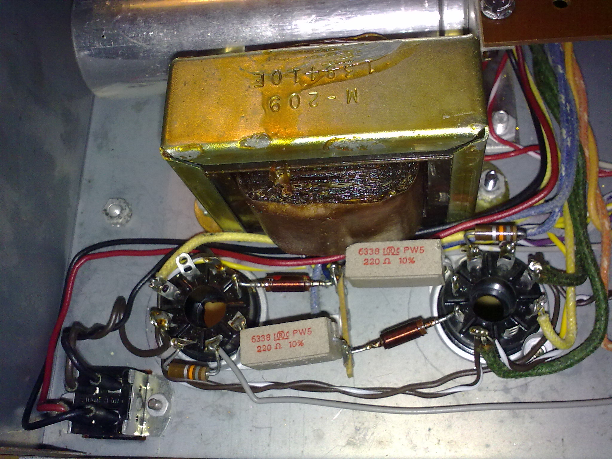

9) Any info on the inductors at the output tubes' anodes? Ah, just seen it, 2.2uH (found in the manual from Antonio Ceretti American Vintage Audio Equipment). Should I replace them too?
10) Why is the circuit AC-coupled? Can I omit the switch/pot?
11) According to the schematic notes in the service information (again found at Antonio Ceretti American Vintage Audio Equipment) most of the resistors are rated at 1/2 W. Would you replace these resistors (1W MOX?)? What about the higher power ones? They seem to be 220R/5W wirewound. Should I replace them with MOX types?
