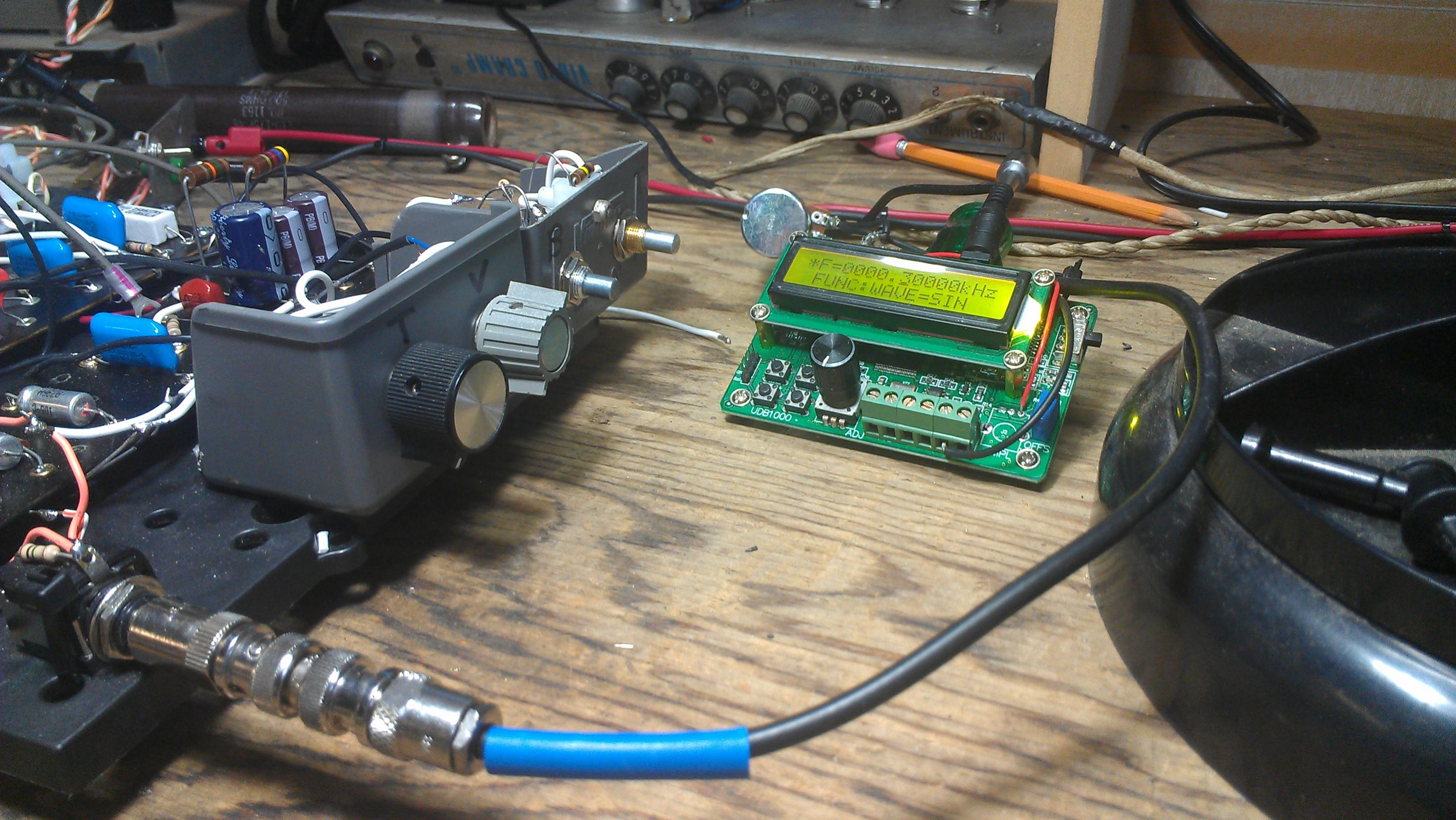

Having too much fun! have some 6Y6s and 6K6s, want to see what lower power tubes do. Am looking at tube data sheets, plate voltages, cathode bias, plate dissipation, AND power supply loading. Realized I had been using my Champ-sized PT (70 mA) on this Deluxe breadboard. Am drawing 80 - 100+ mA..... OK, so how do I reduce the supply current demand? Plugged in two 6K6s, tube data showed similar plate B+ and cathode resistance (400) to 6V6s, and the amp worked well, only 32 mA plate current at 345 V on plate (6V6s ran at 41). Still too much draw on the supply. This is where I know just enough to be dangerous..... Thought I could lower the plate voltage with dropping resistors on the plate leads. Installed two 1800 1W guys, and.....one 6K6 showed 317V on its plate, the other 372!! And then the amp started fading (have a 4 ohm spkr cab and 4 ohm dummy resistor switchable, and a sig gen at guitar level providing signal). Current draw from the supply dropped off. Shut it down. Removed the plate resistors, everything still works. Hmm... How can I lower plate supply (other than a whole different xfmr/tube or SS setup? Preamp tubes use that 100K to set plate voltage... The 6Y6 needs only 200 V of plate voltage... Any thoughts? Thanks! Jeff

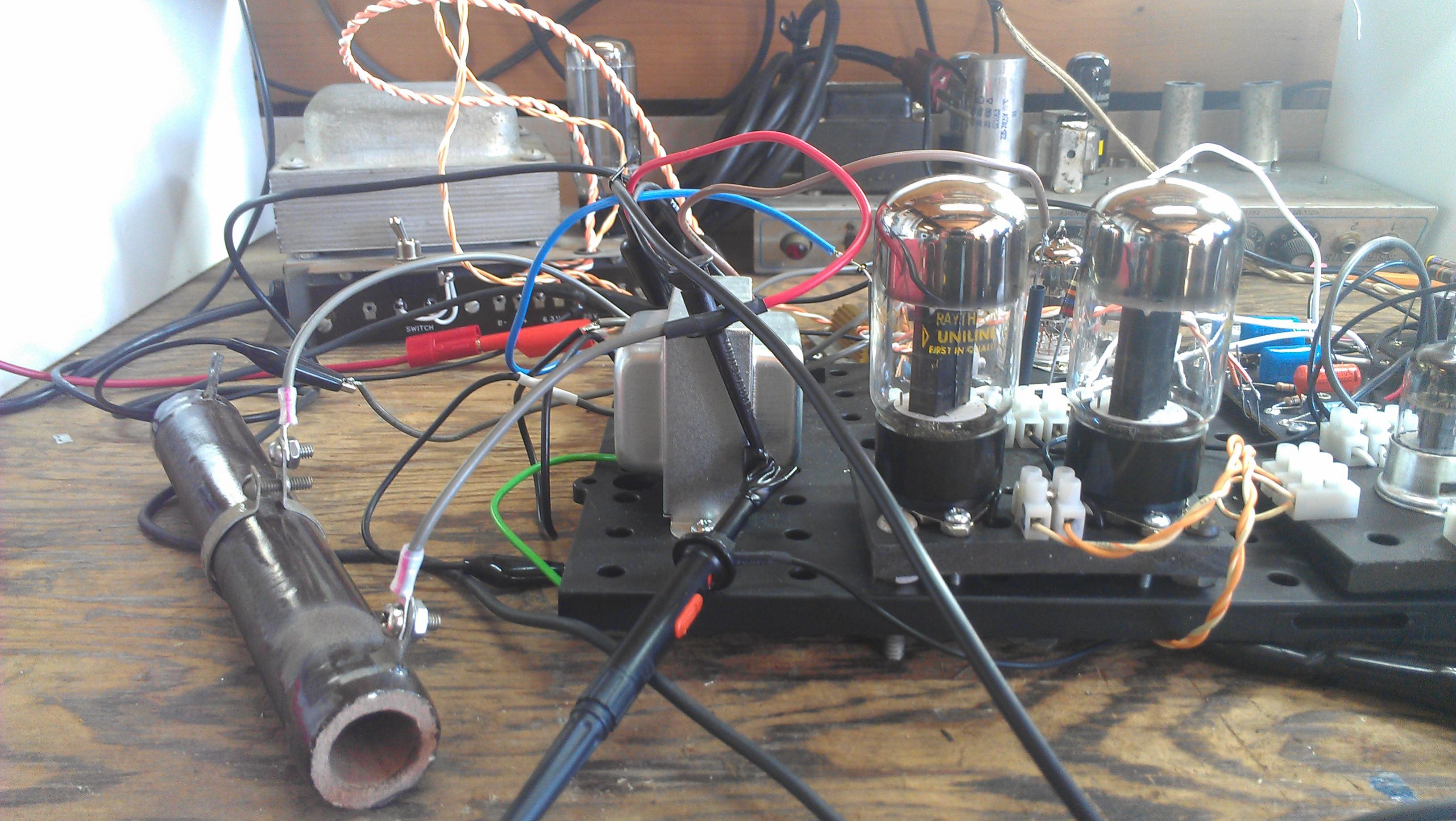

Thanks for all the interest and ideas! And yes I'll post some sound clips, when I get by breadboard back to it's original configuration.... The massive PT in the pic is from an old Hammond organ - it had 2 6V6s PP and about 40 other tubes, so it should handle my filament needs! Also shown is a 500 ohm 175W adjustable power resistor, for reducing plate voltage, and a 4 ohm 50W dummy resistor and speaker switchboard...... Next pic shows 2 6K6s, next to a Weber W041318 OT (6600 pri, 8 sec, 25W). Another shows my preamp and pwr section gain pot module, and a tone stack module (bass & treble pots) - currently not in the circuit (lifted the ground). Finally, 3 scope shots (off the dummy load), with medium gain settings, preamp pushed, and both preamp and pwr section pushed. I want to run a bunch of tests with different power tubes, with different plate B+, cathode bias, etc and record PT current, plate current, breakup characteristics, total wattage, etc. Then when I want to build an amp for a specific use, I have a better idea what parts to put together. I have 6Y6s, 6L6s and a pair of little 6AQ5As as well. This could take a while.... And then there's changing the PI....

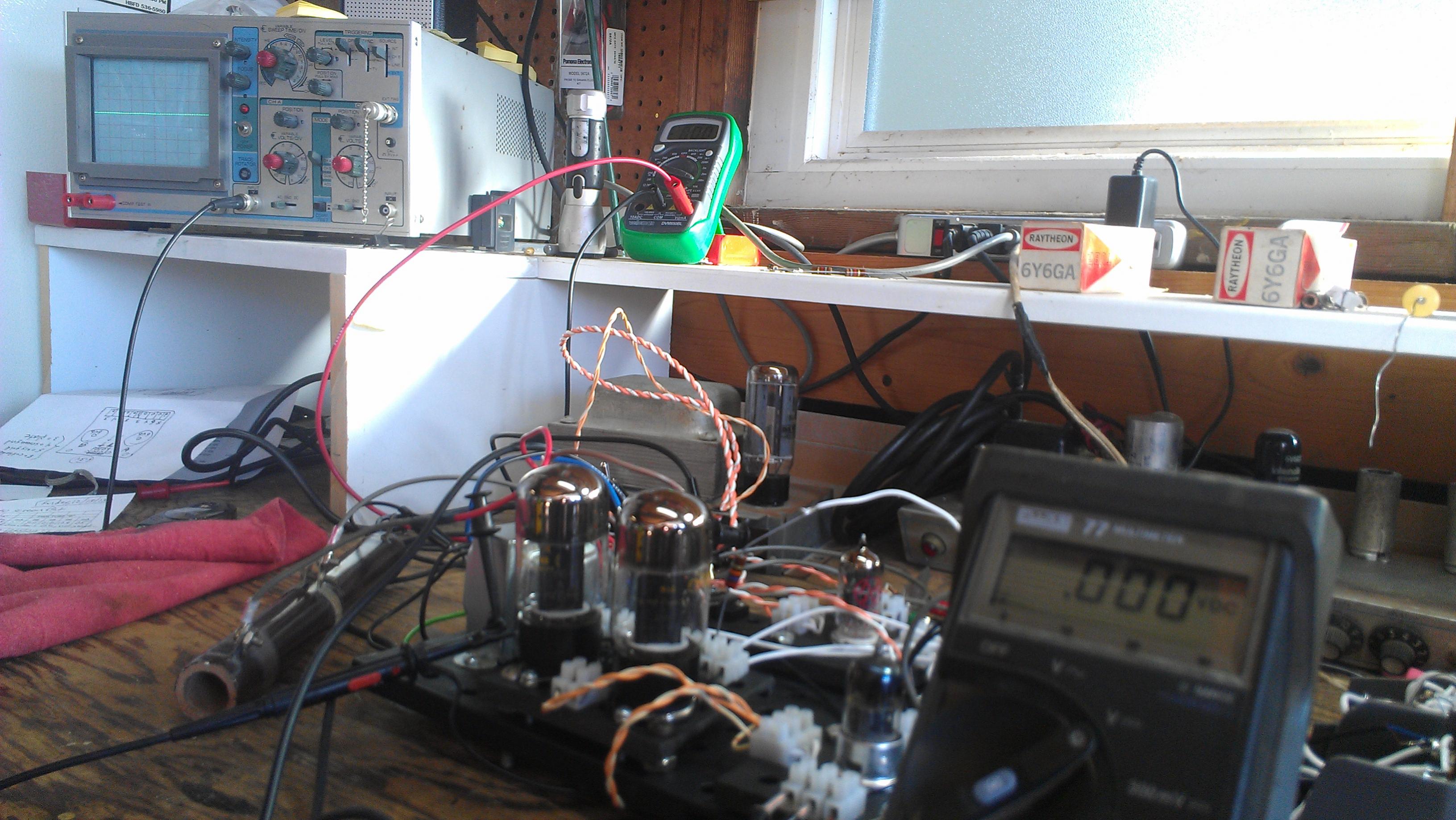

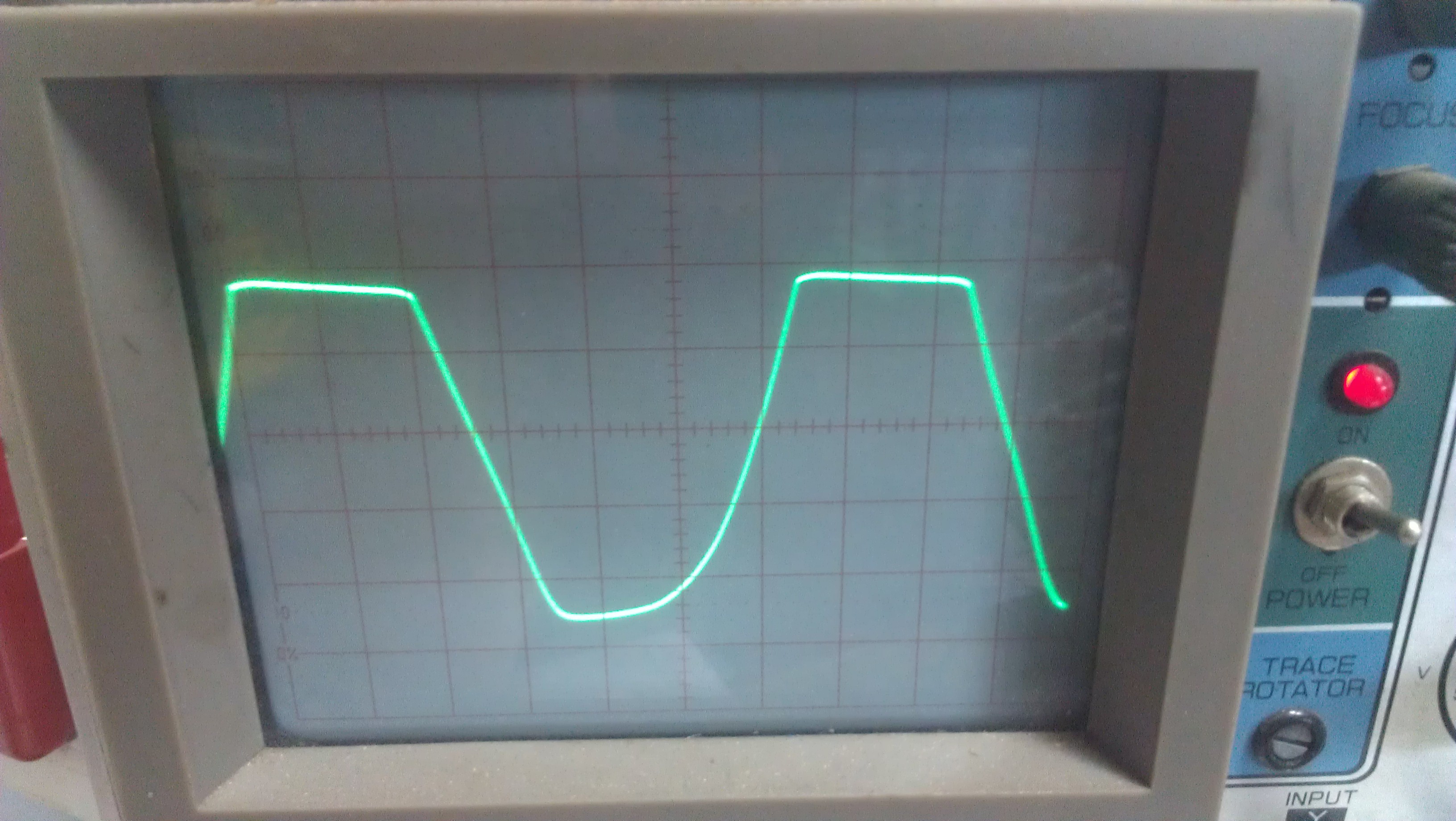

News Flash.... first test: lowered B+ to 6K6 plates from 360 to 312 VDC (added 1000 ohms to OT center tap), and lowered screen (glad I remembered to!) from 285 to 216 (added 5600 ohms). Fired it up, plate current only 25 mA (ea tube) and power supply draw was only 63 mA (no signal) to 71 mA (max signal)!! Breakup came earlier on scope, guitar had more distortion than I'd like, but bias adjust should fix that. BUT.... I have a 15W Deluxe that I can power with a Champ PT (that was my goal).

You are correct - I just wanted to be sure screen voltage stayed below plate. I lowered the plate B+ more (turns out my 500 ohm power resistor is actually 2500 - measured it - the "2" must have faded...) down to 236V, leaving the 5600 added screen dropper. Screen stayed about 213V (OK). Plate current went down to 23 mA (per tube), which calcs out to 5.14W/per tube: (Vplate-Vcathode) x plate current. I had 12.5Wx2=25 watts with 6V6s, with 356V plate, 17V cathode, and 37 mA plate. This was with no input signal (didn't seem to change with signal - these are DC watts not audio power?). One thing I did notice when I reduced the plate B+, clipping came earlier, and closely comparing the scope at max gain (for lowering plate voltage) showed a reduction of the peak-to-peak height. Is this "Headroom" diminishing? I need to learn more about that. Stuff like voltage swings, etc I see online. I gotta lot to learn.....

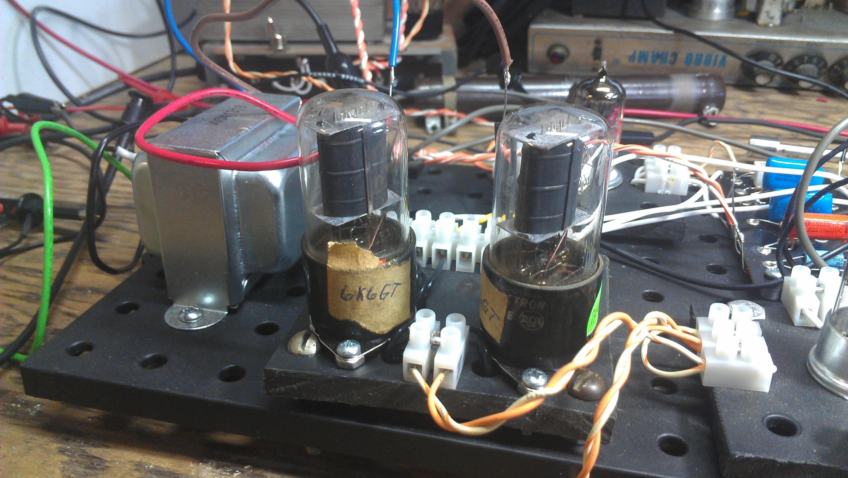

FMB: By the way, the first thing I did with my 6K6s is just swap them into this 6V6 breadboard Deluxe amp. Was running 350 Vplate, 18 Vcathode, they stayed about the same (with 6K6s), but plate current went from 37mA to 32, giving about 10.5W/tube. I'm measuring my plate current through 1 ohm 1% resistors. The reason I'm playing with lower plate voltages (besides just seeing what happens) is that I have a pair of 6Y6s, which run at 200 Vplate and 135 Vscreen, but plate diss is 12.5W (each!). Thats my next test.

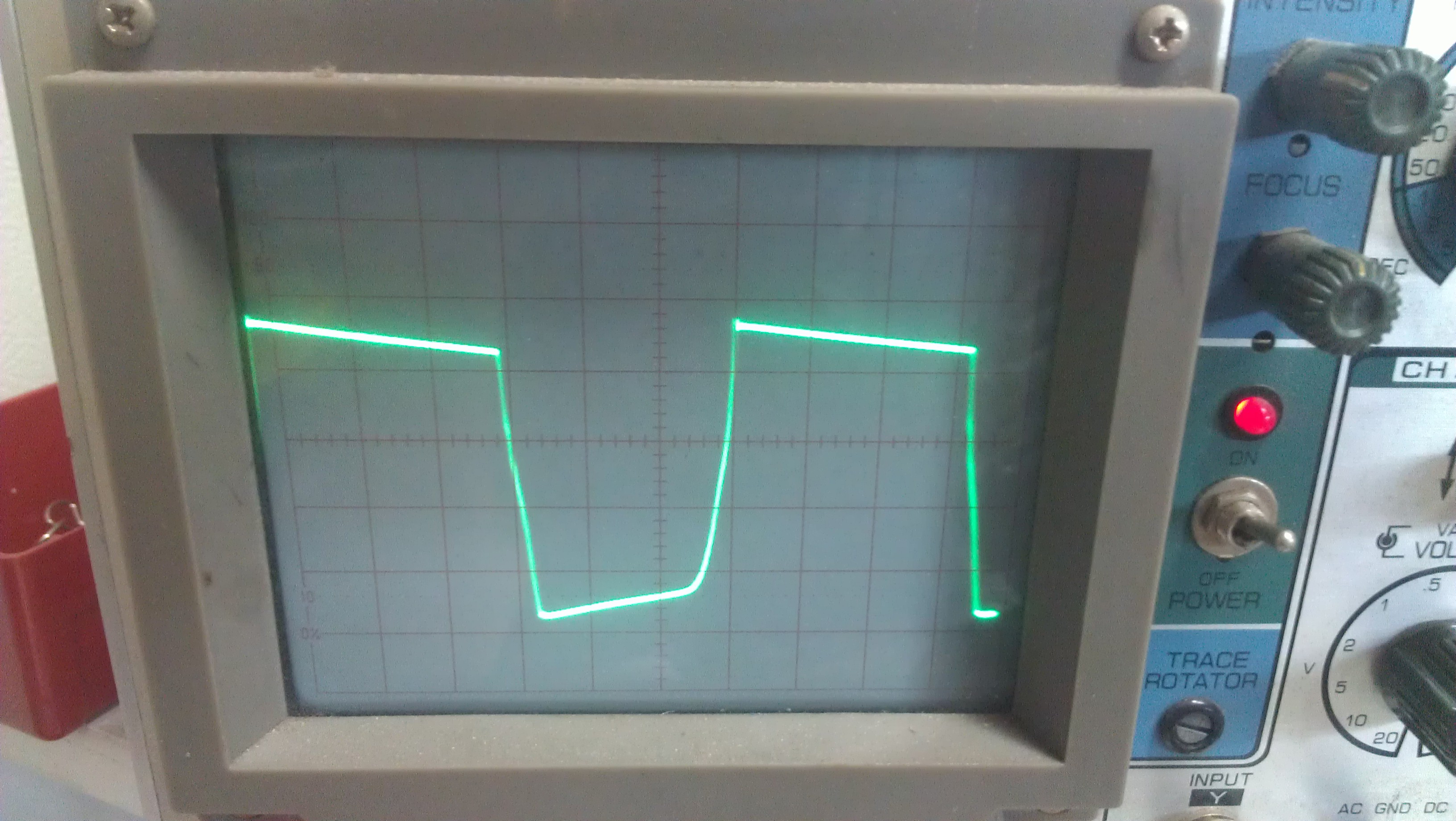

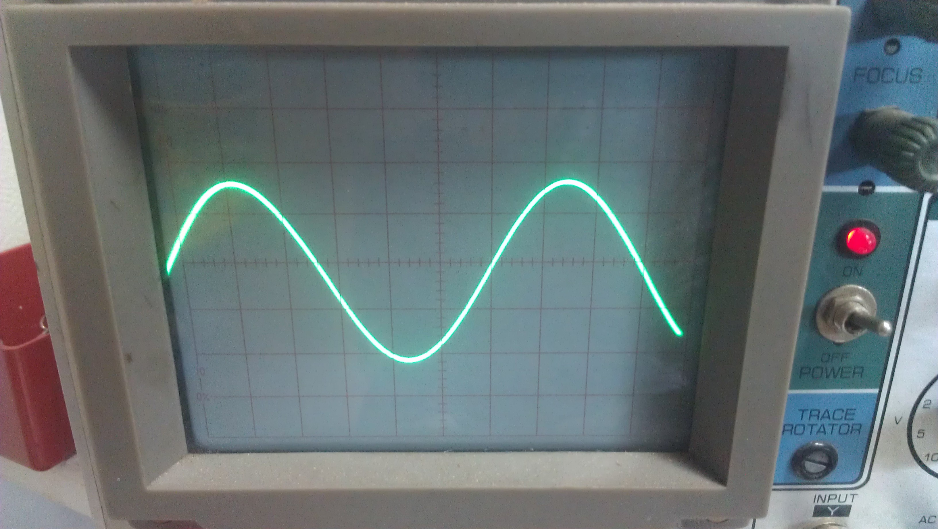

Was able to lower my plate B+ from 350 to 208 volts, with my monster 2500 ohm power resistor (see pic), and ran 5 tests on two 6K6s, at different levels, noting plate current, supply current, and a 400Hz sine wave on the plate and spkr. Even ran the plate 50 volts lower than the screen! Just to see what it did.... Then having a low Vp available I plugged in my two 6Y6s (see pic-they're big bottles!). Tube data specs 200/135 max plate/screen. Closest I could get was 233/176 (plate/screen), but got 42 mA plate current. Getting a bit tired of making square waves though, will start adding grid stop resistance to the PI (have none now!), to clean up the signal. Play with cathode bias too. My breadboard has gotten so "Frankenstein'ed" I hope I can put it back to normal (I have that data too...somewhere!).
