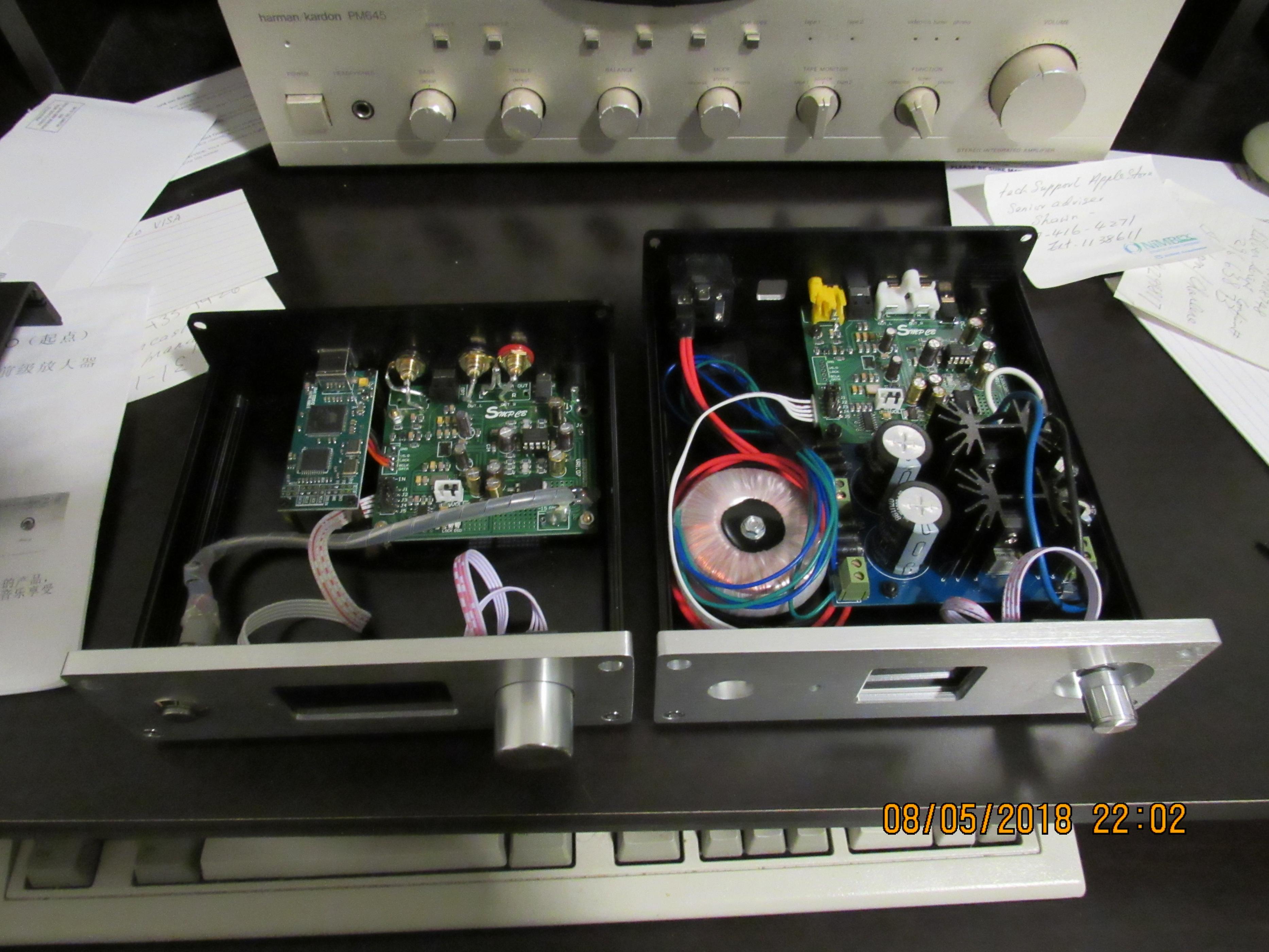

Add HDMI input to ES9038Q2M DAC
These are the DAC that I want to add the HDMI input to:
https://www.diyaudio.com/forums/digital-line-level/314935-es9038q2m-board-223.html#post5509898
The biggest problem to add the HDMI to I2S board is the case modification. Cutting the rectangular openings is not easy with only hand tools.
One of the ES9038Q2M DAC has the clone Amanero USB. The board has its own MCLK so it so be easy to feed it I2S from the HDMI board.
Thank you for all the insight and suggestions. I may just try the $30 board.
