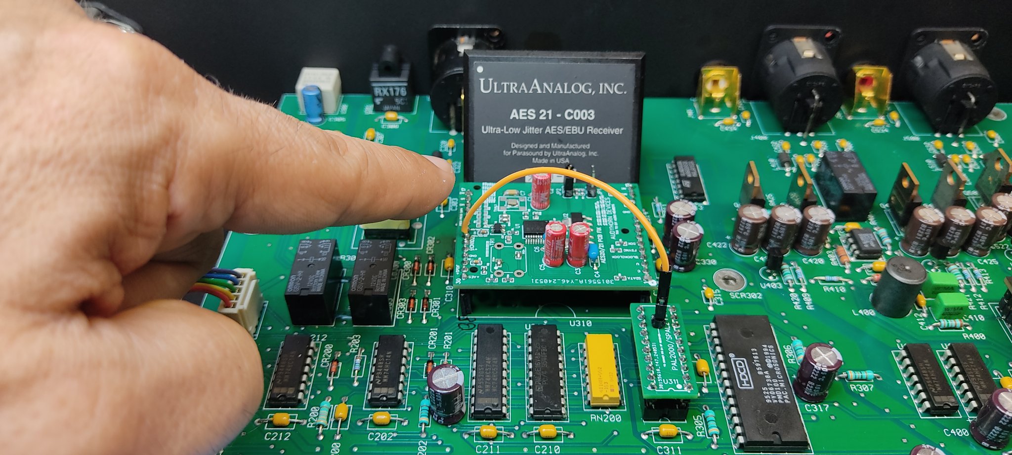

Hi think you need df1706 filter upgrade:
https://www.ebay.it/itm/37344062133...b-EMIomQxa&var=&widget_ver=artemis&media=COPY

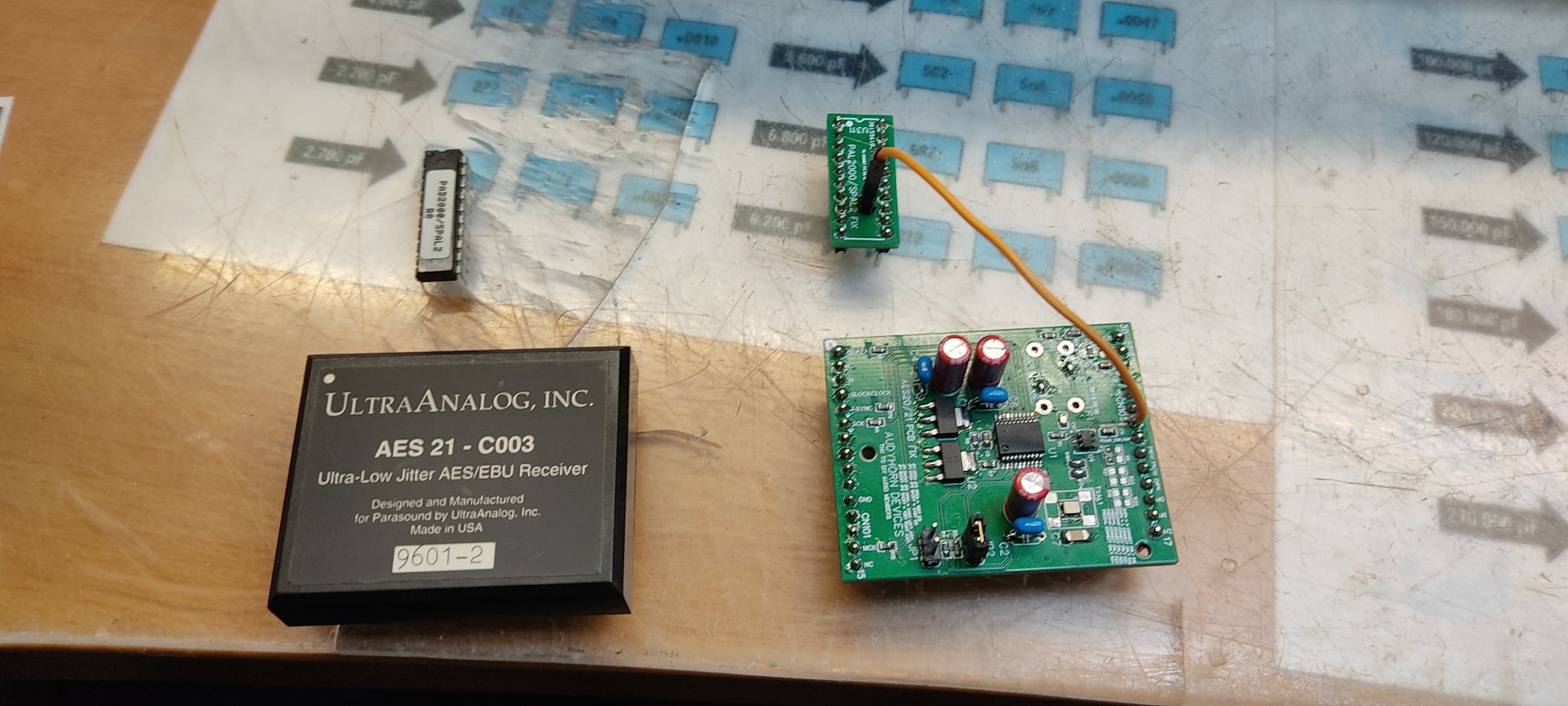

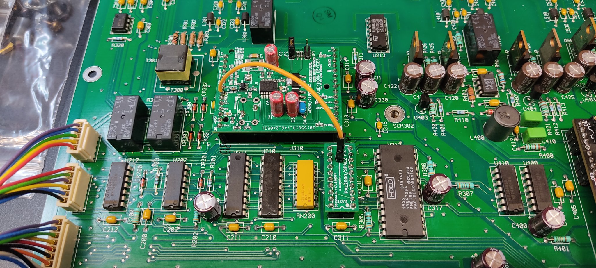

Plus new receiver , please see pictures

1) The socket uses very high quality parts, the best that I have found on the market for every SMD/TH parts.Hello Tonixp
Great. Now where can I find the SPDIF module to replace the AES21 module ?
I could perhaps use I2s to bypass SPDIF module.
For the wm8804 ic , I order genuine parts from a reputable vendor (they are of course expensive).
The resultate is very nice!
But the problem now is that I don't have ago the equipment to test the new sockets because the Parasound DAC 2000 it come back to Holland .
So as soon as i can , i will come back on this item for project also a check control quality pcb .
Please stay tuned .

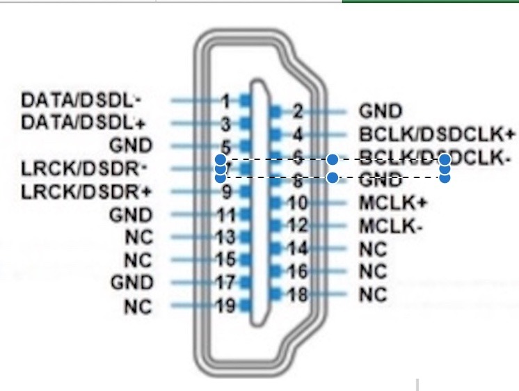

2) Yes you can also bypass the spdf module but you need a 4 wire PCM format signal.
LRCK
BCK
DATA LEFT
DATA RIGHT
Also a RJ45 or HDMI connector fixed on rear panel and a appropriate source by the way.
This Is a balanced i2s format.
It Is used to transport the i2s from source to D20400 DAC module.
Next step Is to convert this format in PCM format.

The most problem of i2s unbalanced trasporto Is the lengh of cable (max 30 cm).
So :
1)you have to continue to use balanced type.
2) you have to convert in pcm format and bypassing digital filter you will obtain the max bit and sampling rate performances of AD20400 that i don't know.
