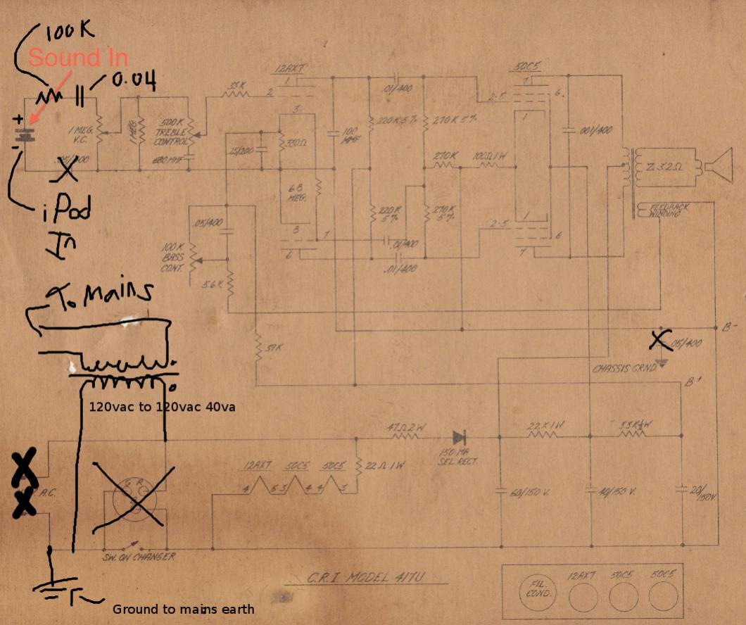

i modified the circuit will this work i just want to make sure
so if i isolate the amp and ground the b- can i plug the ipod with 100k and 0.047uf in series with signal input into the amp's signal input
I assume you mean you are going to use a proper isolation transformer. You don't need to do anything with the B- under such a case, although grounding B- through a 3 wire cord is not a bad idea, and would add an extra measure of safety as long as it is connected to an actual safety ground.. (not a cheater)
Note that you should replace the electrolytics, probable selenium rectifier and all of the coupling caps before you use this. All are subject to catastrophic failure due to age. The electroytics can explode, and the selenium rectifier when it fails will emit extremely toxic smoke. Coupling cap failure will ruin your output tubes.
The selenium rectifier can be replaced by a 1N4007 or UF4007, that 47 ohm resistor may need to be slightly increased in value. I'd replace those 150V electrolytic caps with at least 200V parts.
The interstage coupling caps will be ceramic disk and not so prone to failure as as much as they are just terrible for audio coupling.
Change them to MKP or other film caps of the same value, 200V or greater rating. Your B+ power supply will end up around 175V so anything over 200V is fine.
The input caps in the circuit up to the first grid can be film caps above 25V, as the grid is close to ground.
Personally, I'd bypass the treble circuit and just use the volume control.
