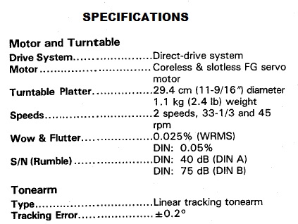

My Kenwood TT has quite respectable performance with decent specs, obviously whoever planned the design work thought things out carefully.
(Unlike some of the crap produced today)
Notice the platter weight etc. - it doesn't need some 3 inch thick solid monster platter like those behemoth designs.
And the W/F specs when tested in the shop are within the claimed amount at 0.03%.
The key thing is the coreless and slotless motor - this means no cogging and is probably necessary to get this sort of performance with a lightish platter.
