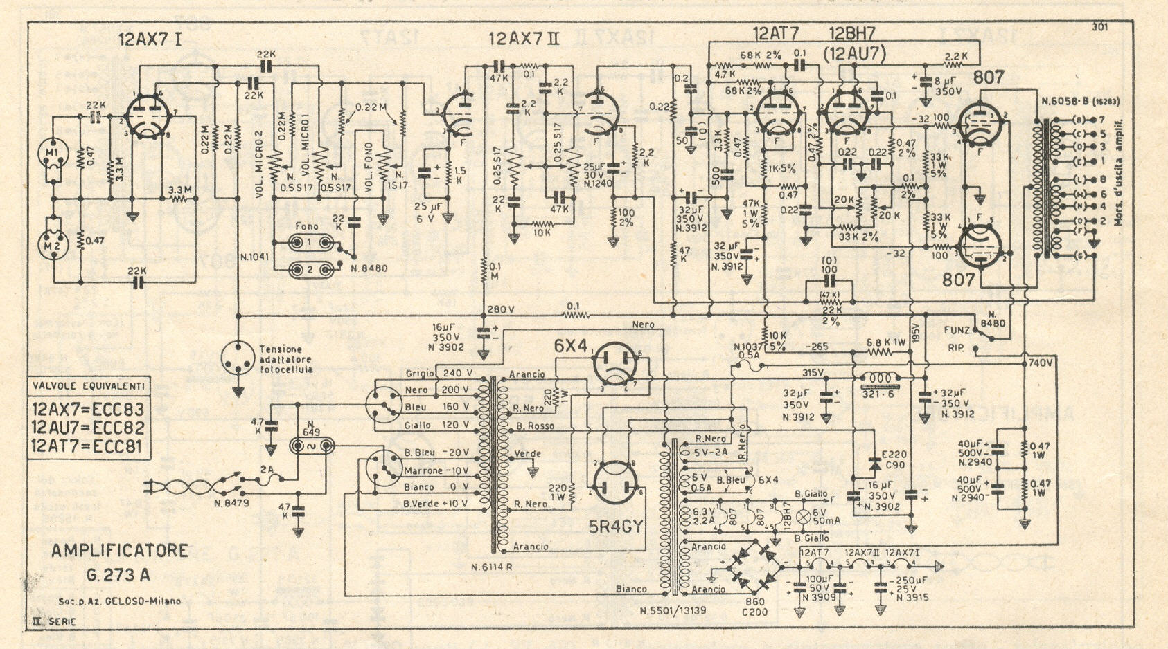

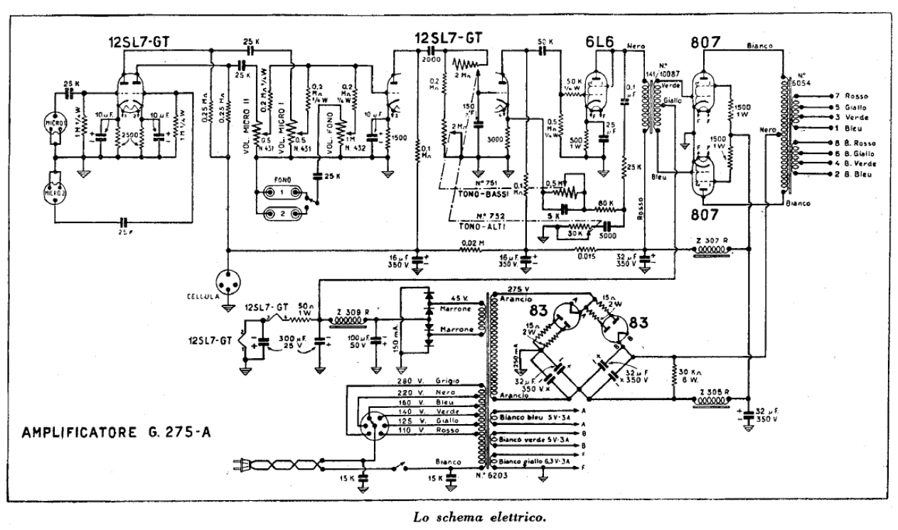

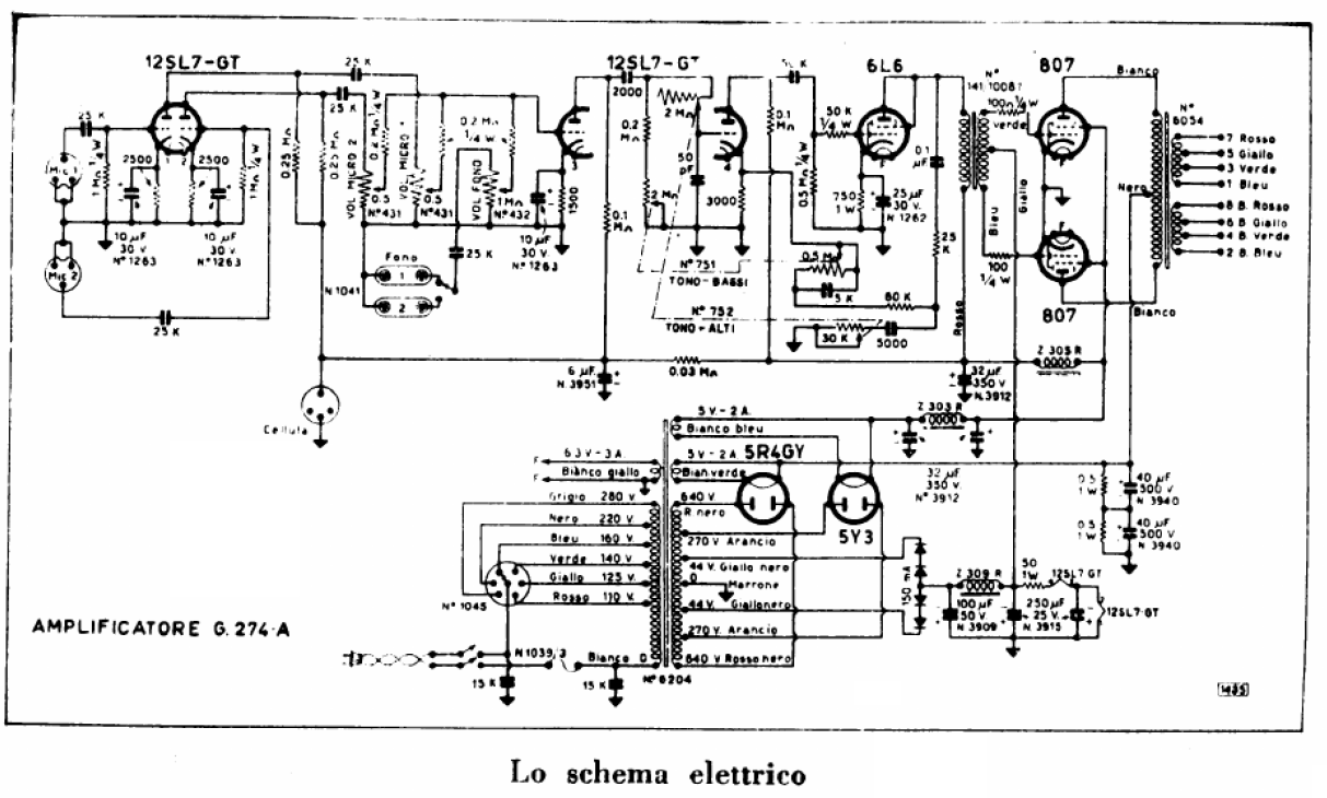

There are some interesting Geloso amplifiers that drive the 807 into AB2. In the 3rd one, the G275A, I think it is clever how the heater supply for the 12SL7 driver tubes is combined with the bias supply.
