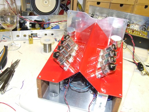

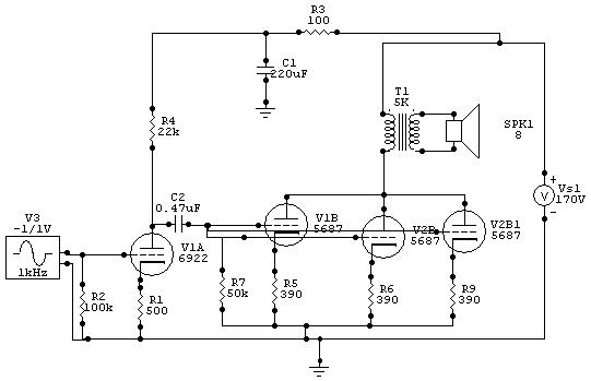

I'm building another lightweight for my workshop. B/c of what I have on hand, the output will be three bottles of 6DJ8s in parallel, or six triodes. These tubes are prone to oscillations so I have decided to use plate stoppers to connect the plates together. But then I wonder if I should add some small resistors on each cathode as well? I need to connect the cathodes with something anyways, and using a 20ohm CC may be just as good as a wire.
(I have a bunch of 20 and 50ohm carbon comps, and I will use 50ohm CCs on the plates)
Any views on this? Am I overdoing it with stoppers on all three electrodes?

Well, I finally got my 'shop-amp' done. I skipped the plate stoppers, only used the usual grid stoppers, and separate cathode resistors, which I suppose act as 'cathode stoppers'. Being a flea power amp, it makes just under 1watt, I havent bypassed the cathode resistors since I dont need the gain. That gives some local NFB, which I don't mind, and ensures each triode operates within estimate.
I used what I had laying around, which is how most of the amps I build for myself end up being built.
I paralleled 3 5687 triodes in the output and used some 5k:8 Edcors I had. Unfortunately the only PT I had only gives me 170volt for B+. But the work shop only needs a watt so no real worries. With this low B+ I really don't need 3 5687s, but I don't like V-6s.
As is it sounds pretty damn good. Measurementwise it has nice low distortion till I pass 2.5V rms where the higher Hs start popping in. Max swing is +-4V into 8ohms. The 5687s wont let the plate voltage swing lower than about 80V without higher harmonics showing up. With some grid drive I imagine I can swing them a little lower for half a watt more, but I'm not that desperate.
Either way, sounds really nice, highly recommended but if doing it again I'd buy a new PT with proper B+ voltages, somewhere around 250-300volts.
The Edcors are great for the price, they are the real cheap XSE-15 types, and I measure -3dB corners at 15Hz and 54kHz. Not bad for those OTs.

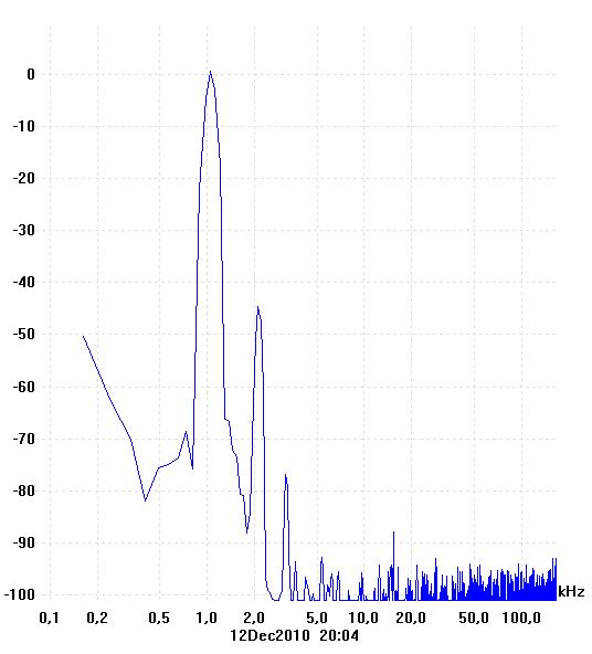

Hmm, my 'go to' scope has max 166kHz BW🙁 (It's an old trusty 16bit Picoscope). I guess I should unpack the old Philips scope, but that thing is a monster.
Just to keep this incredible thread going, here is the FFT of a 1kHz testsignal.
