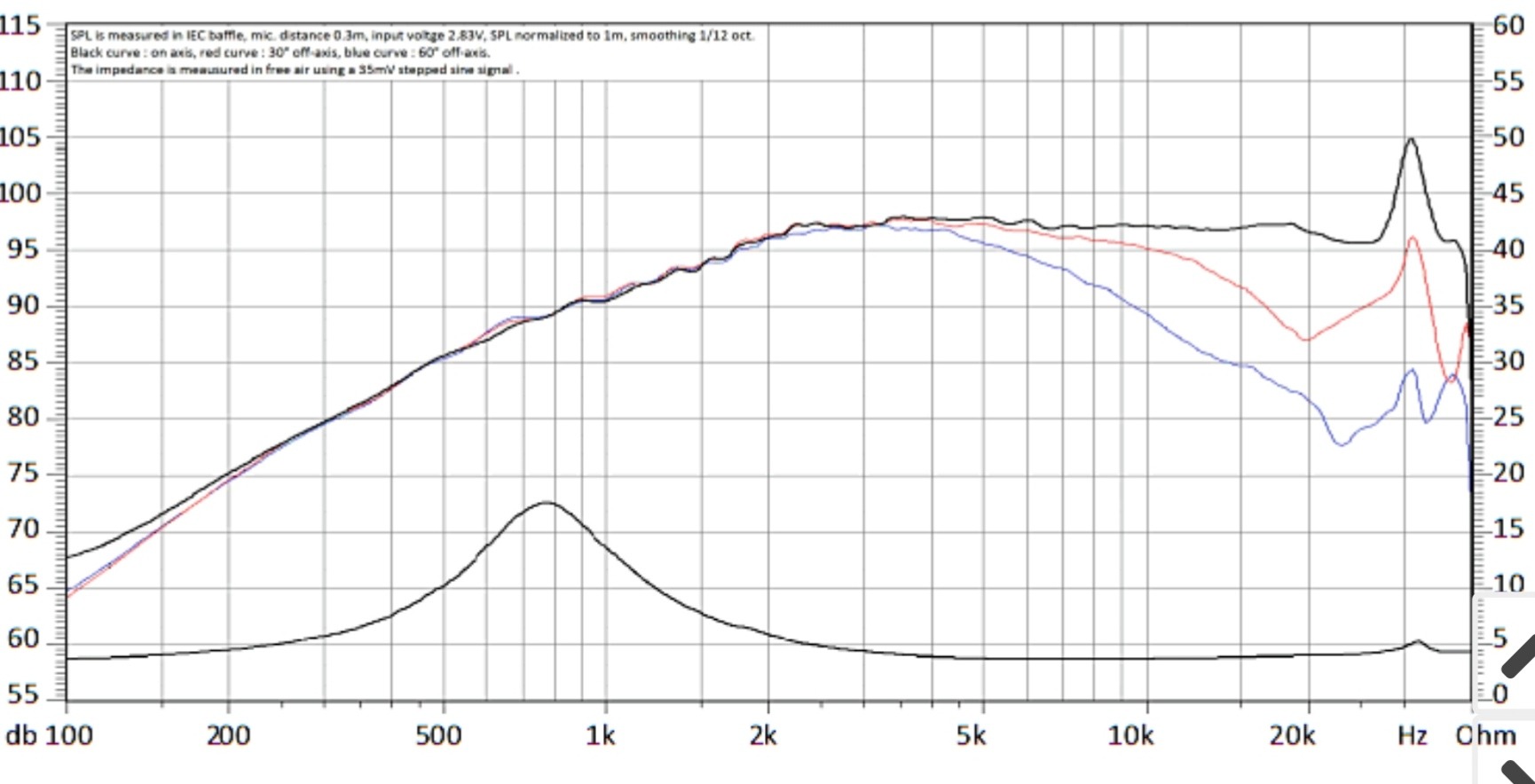

I have one SE 300B amp, with Lundahl Output Transformer , with 3K primary and only 8 ohms secundary, and 4 ohms speakers.
I'm afraid you may need new speakers, unless you are happy with the way it sounds with 4 ohm speakers. I'd expect distortion to be quite a bit higher.I have one SE 300B amp, with Lundahl Output Transformer , with 3K primary and only 8 ohms secundary, and 4 ohms speakers.

Which speakers do you have? Maybe they are actually higher in impedance than their nominal rating.I have one SE 300B amp, with Lundahl Output Transformer , with 3K primary and only 8 ohms secundary, and 4 ohms speakers.
Most loudspeakers have lower impedance at some frequencies versus their nominal ratings.
Take an Ohmmeter or DMM and measure the DCR of the speaker terminals.
The impedance at very low frequency, well below the ported tuning, or well below the closed box woofer resonance is about the same as the DCR.
The impedance at the impedance dip of a ported tuned speaker port tuning is about the same as the DCR.
The impedance in the range somewhere from about 150 to 400Hz is about the same as the DCR.

That's a 4 ohm speaker system alright, unless you can connect the two Fostex in series,
and also if the Bliesma is used with a series resistor.
