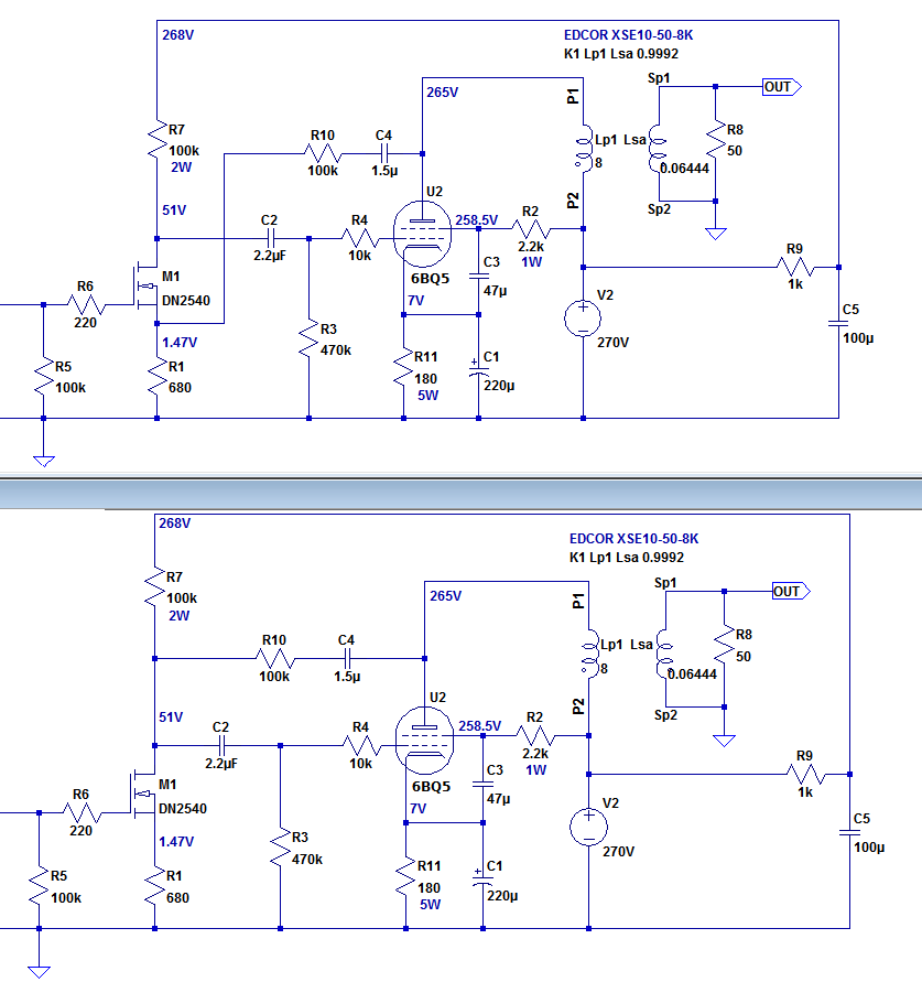

I've been reading the many (many, many, many) posts about local negative feedback around an output stage. I picked up somewhere that local feedback performed by taking signal from the plate of an output tube can go equally well to either that output tube's grid (plate-grid local feedback, aka "Schade") or to the cathode of the driver tube (RCA Tube Manual style). Are these basically the same thing, done differently?
I was also reading about the various ways of putting NFB into a circuit. Series-derived, series-applied, parallel-derived, parallel-applied, in all combinations. I'm sure I'm just being dense, but I'm not following the meanings of those definitions, although I get that applying NFB reduces gain in all cases (as opposed to positive feedback, which boosts gain once applied).
Anyhow, here are two circuits I modeled in spice, to illustrate the question. R10 and C4 feed back the audio signal from the plate of U2. To keep things simple, I AC-coupled the feedback loop from the output tube's plate, so that the high voltage there wouldn't influence DC conditions elsewhere in the circuit. The top schematic is plate-cathode, the bottom one is plate-grid.
So, the question is, of these two ways of applying NFB around the output stage of a simple SE pentode amp, is one better than the other? Is one better than the other in certain situations, but not in others? Are there downsides to using one or the other when driving the complex load presented by the OPT with a speaker connected to its secondary?
Not the same, since Schade is feedback around a single stage.
http://www.electronics-tutorials.ws/systems/sys29.gif
Using the driver cathode is feedback around two stages.
More distortion, more phase shift, error signal derived through a device junction.

Is "Schade" feedback any kind of NFB around a single stage, whether series or parallel applied?
"Schade" feedback is an imprecise term and will mean different things to different people. If you are asking questions about specific different types of local feedbacks it is best to avoid that term, IMHO.
One thing I'm seeing in spice sims is that if you use a triode as the driver stage, plate-grid (parallel?) NFB doesn't work well. Replacing the triode with a depletion mode MOSFET (orders of magnitude higher gm) makes the plate-grid feedback work very well. The MOSFET is also super-easy to implement. Using a pentode as the driver works pretty well for plate-grid NFB, but never as well (or as easily) as the depletion mode MOSFET.
However, if you must use a triode as the driver, then plate-cathode (2-stage, series) NFB works very well, at least in the sims.

Yes, it makes sense, as many of us have been saying for years, despite Kitic and the RH followers who insist otherwise... Use a pentode or MOSFET for the driver if you want to use plate-to-grid feedback.
You want to use something that is a very linear voltage to current converter working into a vertical load line. If you look at triode characteristics, you can see that a triode wants a horizontal load line, but a vertical one will give awful results as far as linearity goes. Pentode is much more linear into a vertical load. Cathode degeneration will further improve that linearity but will reduce gain.

Here's the original 1938 paper by Schade at RCA, see figure 33.
http://www.clarisonus.com/Archives/TubeTheory/Schade 1938 Beam Power Tubes.pdf
It's shunt (also called parallel) feedback that is applied around a power output tube.
It's not that you -want- a vertical load line for the shunt (Schade) plate to grid feedback, it's just that it is mostly unavoidable in the shunt case. The feedback resistor, with the large opposite phase plate signal on it, makes for a low impedance node where it connects with the driver plate. (which has opposing phase, they fight each other, trying to hold V variation to zero)
Optimum case: Often designers will put a Mosfet follower after the driver plate, with a series source resistor to the output tube grid plus the feedback resistor (and cap) from the output plate. That way the driver tube can have a desirable high Z load, and the series source resistor and output feedback resistor make for a very constant divider ratio for the feedback effect.
The triode driver case has variable plate resistance causing the N Fdbk divider ratio to change with current as well as badly loading the triode with low Z. But putting the Mosfet follower and series source resistor after the triode driver plate can fix those problems.
The pentode driver is not a free ride either, since it has a 3/2 (or more likely 2.0) power law V to I conversion from its grid. So some cathode degeneration is needed to linearize that.
The Mosfet driver with high gm is even easier to linearize with some source degeneration. But a common source mode driver will have input capacitance issues. While the follower modes are relatively safe.
Tubes naturally like high impedances for linearity. So the shunt (Schade) feedback is somewhat of a misfit unless using the Mosfet follower fix.
Schade series feedback (using an interstage xfmr) is the natural high Z scheme. However, good interstage xfmrs are expensive and cause phase problems for any global N feedback.
Sorry, that is incorrect. Schade applied series feedback through a clever interstage transformer setup that allowed him to change feedback ratios by changing out resistors. It is not a setup that lends itself well to building amplifiers but it was useful in demonstrating the benefits of local feedback in the output stage for his white paper.
Look carefully at the schematic of his setup and you will see that a portion of the output voltage signal is applied in series with the input voltage. I too assumed that it was parallel applied feedback at first, since everyone here was calling parallel applied feedback "Schade" feedback.
Yes, in the original paper, but since very few use interstage transformers now,
it's mostly applied as shunt feedback.

The most elegant way of implementing "Schade" feedback is a simple cathode feedback winding, which is the series feedback case. It's just not very flexible if you want to change the ratio.

Right, like Audio Research, Mac, Luxman. I used similar circuitry in some custom amps
that I built and sold in the 70s. Needs a healthy driver stage though.

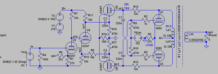

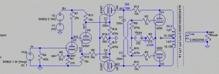

Below is an interesting twist on the usual (often called Schade or shunt Schade) local shunt N Fdbk scheme. This was posted by Goldenbeer last year.
It uses -crossed- shunt feedbacks (a P-P design) to apply POSITIVE feedbacks to the driver loads via bootstrapping. (the P feedback resistors become the driver load resistors) This can be used to slant the driver (triodes) load lines in the opposite sense from usual. (neg. impedance loads) Which can be used to produce opposite 3rd harmonic distortion versus the final (class A necessarily) output stage (for 3rd harmonic cancelling).
This avoids the low Z loading problem of a conventional shunt "Schaded" triode driver as well, and provides additional loop gain for a global N feedback loop. (or for another encompassing local N Fdbk loop) (see post #45 in link)
I haven't seen any further developments to this concept in the form of an actual amplifier. Check the end of that thread for a possible caveat due to global N Fdbk maybe losing control at frequency extremes and some fixes.
Would be interesting to hear from Goldenbeer about any further developments on this interesting driver scheme.

This is definitely tricky multi-loop feedback design in motion here. Not recommended for the timid or beginner designers. Hard to ignore however, doing a lot of stuff better. The P Fdbks alone will increase the output impedance, so some encompassing N Fdbk(s) required to lower Zout, and prevent possible oscillation.
