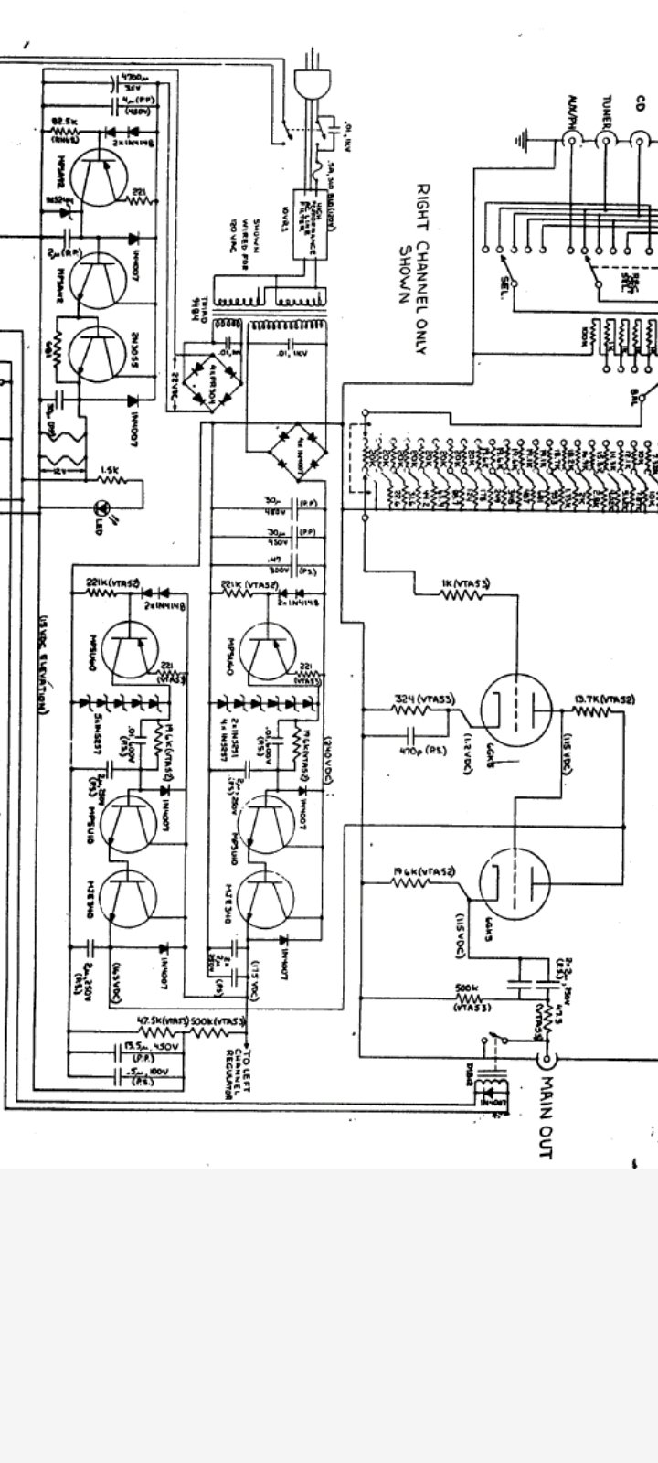

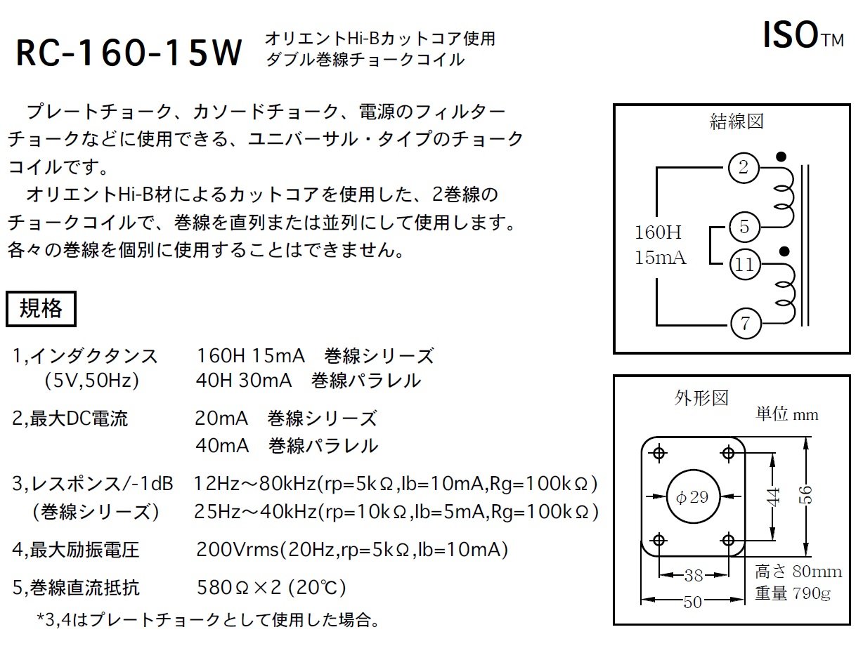

If the circuit has a 13.7K plate load resistor in the circuit and want to place a 160H plate choke with 1160R DCR there. Would it be possible as the DCR isn't around 50 ohm or so?
Therefore, I can leave the 13.7K plate resistor there and connected the plate choke to that. But how?

You set the tube DC bias point using the choke DC resistance which is relatively low.
The choke has a very high ac resistance. The total ac load that determines the ac gain is the parallel value of the choke ac resistance and the parallel resistor.
Since the resistor is normally very much lower ac resistance than the choke, the resistor determines the ac load and the gain.

I guess it would be a wise idea by replacing the plate load resistor with the Tango plate choke, and lower the B+ supply.
However, I have a plate choke on hand which is 50 ohm DCR, Would it be a good idea to use it with the plate load resistor?
What is the point of adding the choke if you keep the resistor? The AC plate load will be determined by the resistor and the DC by the choke.
The PS supply will need re-adjusting and perhaps the CF resistor too... a bit too involved for perhaps no gain at all.
Btw, which CJ preamp is that? 6GK5 tubes? And what's the choke inductance?

Hello!
It is CJ Premier Ten.
Regarding the inductance, I have no idea what should I choose. Normally,ba plate choke with high inductance like 160H should be used for 6GK5. For sure, a low DCR like 50 ohm.
However, I have no idea under this circumstances.
If I use ONLY plate change kevwothout plate load resistor, then it would be a Tango plate choke and it is what I have on hand.

Cannot make head or tails about this thread's objective. The quote from #1 is just BS imho. A 50ohm choke sounds like a PS choke and is very unlikely to have enough inductance for a highish Rp tube. Adding a choke to the above mentioned preamp will require a substantial redesign, unless the choke is in series with the existing plate resistor.
