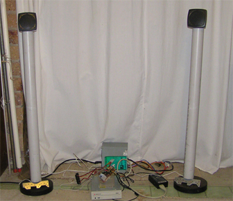

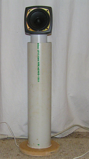

I have mentioned on a few other threads my intro into TLs. After a bit of testing with 3" driver placed on top of 29" of 80mm PVC, suspended from a camera tripod, I hacked the rear satellite housings from an Altec Lansing ACS45, and glued them to 30" of 50mm PVC tubing. I am not using the original Altec drivers, as the suspension is a bit stiff.
The drivers are from a Packard Bell - Diamond Audio Technology PC multimedia set. I have no details of these, and guessed the Fr to be about 130 Hz. I suspect they may be a bit lower, thus the longer tubes. 90-20KHz
They sound great. Bass is thin, but what can one expect from a 3" driver? I estimate 10db down at 50 Hz. But what is there is smooth. No sign of one-note boominess. Midrange and transients are great. I haven't noticed undue ripple in the midrange, though still have a bit too much midrange from the open end - more damping needed.
I started with 2 cotton nylon blend socks in the 80mm tube. Now have a piece of tontine and a sock in each tube.
The system is definately better the the original plastic tuned port BRs. I am still using the amp that was mounted in one of the cases.
Bang for bucks? Plenty. Everything I had on hand, except the 50 mm PVC. Found that on the side of the road a few days ago. It had TL written all over it.
Next stage is to try tapered plugs/fine tuning the length, then a mounting foot.
Once the're finnished, they will be the rear satellites on the main system. (classic Hefner type bridge) So bass and power are not a big issue.
They would also be ideal as near field monitors. Spaced 80cms, listening on the apex,

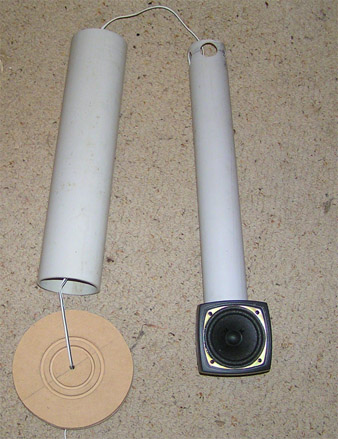

After much listening to these marvels, I decided to convert to a folded TL. Rather than using bends to make a u-turn, I went concentic. A length of 80 mm pipe would provide the same cross-sectional area as the 50mm, with the 50mm inside. Glued to a timber base.
The bits waiting to be glued:
The annular grooves in the base locate the tubes. The smaller was cut with a hole saw. The larger was cut using a arbor in the base, mounted on a drill press, with an 5/32 drill. Poor man's mill/router!!
Before cutting, I checked the resonance. By setting up a telescoping section, I could adjust the length with music playing. What's needed here is a bit of 12 bar with good solid walking bass. Simply adjust the length to get a flat response over the bottom octave on a bass guitar.
I then checked the fr, 103 Hz. My method gave 32 - 33 inches. the finished length is 32.25. So does the formula!

Hi Panomaniac.
The innertube does go all the way to the base. I'm still working on zero gravity.
The 4 holes in the centre tube match the cross sectional area of the inner tube. When assembled, the ports meet the base.
The two annular grooves want to be a good fit on the tubes, and the tubes filed flat and square to get a good joint.
I had thought of a method to keep the centre pipe centered at the top,
so far the glue is doing that. I used an MEK based contact adhesive.

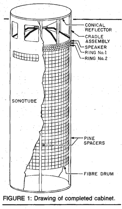

The Sonnotube Dave spoke about wouldn't need the cone deflector for sub base use, and it could be inverted and placed on legs. I have also thought about placing the driver half way down the inner tube. It's easy, but I'll draw it up rather than describe it. In fact its too easy. The cone still radiates to the atmosphere, yet it's not at the end of the tube.

The earlier drawing was in response to Planet 10s comments and link to a sub, and placing the driver down the line. When I posted that I hadn't realised how many other posts had gone up.
