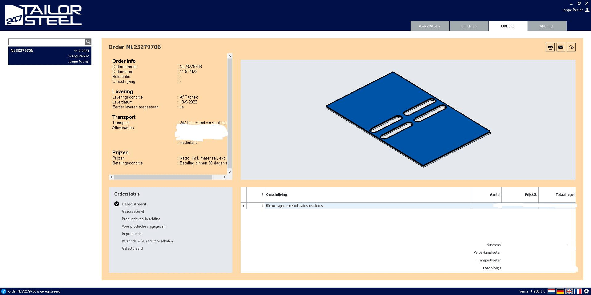

I just orderd some laser cut steel plates, to be used with 50mm long magnets so i can make a panel flat by adding a bunch. or curve it if i want to, and just add plates when i feel it has to be longer.. the steel is 1.25 mm thick and 2 mm longer then the magnets are. just to be save
i ordered some cutters for the CNC to make 1.25-1.4 mm wide pockets , to put the sides of these plates into a piece of MDF to make up the curved panel. this way i can use normal N35 magnets if i make it vertical.
