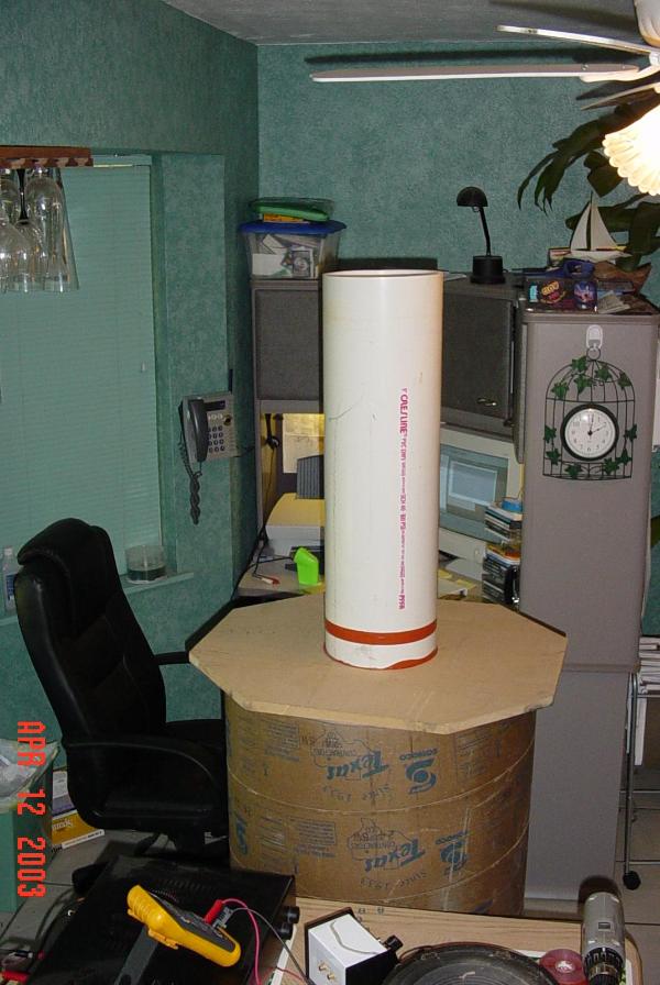

Yes they must be sealed very well, however it's very easy to do, just use some rope-caulk or electrical tape. Rap several times around to fatten the port then just press it into the hole firmly to squeeze the tape or gasket or caulk into the gap, you may need to ad a little on the outside to complete the seal, I use aviation f-4 tape which is a thin sheet of rubber on a roll just like tape that will weld its self together when it makes contact with its self. It’s kinda like instant thin rubber gasket.
Here is a pic, notice the redish/brown tape (F-4) also notice I have 2 different lines of tape. Only about 12" of the port was inside the enclosure.
I was experimenting by flipping the port around which left either more or less of the port inside the enclosure, just wanted to hear the difference if any. Use test tones to tune the Fb, when the cone barely moves relative to just 1 Hz above or below a cretin frequency then that is the tuned freq.
