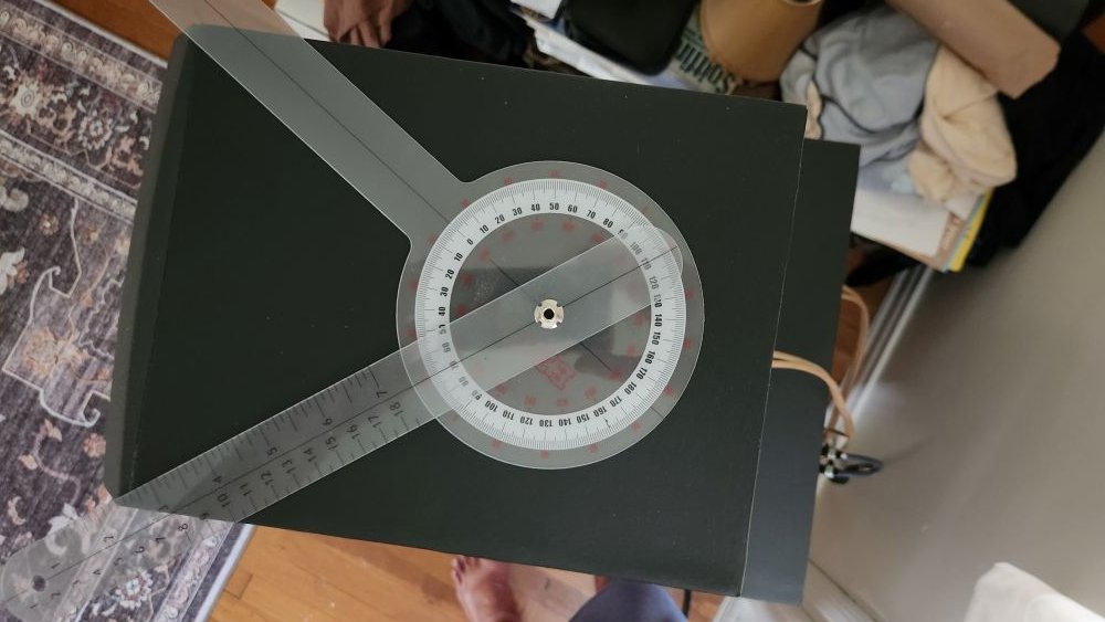

Just moved a pair of speakers into a new room. Did the slap test to listen for any ringing and realized I could use some absorption. Purchased a 6 pack of 2" 2x4 703 panels. Built some frames and covered with tapestries. Did a placement experiment before I built the frames so I had general idea about placement.
So down to the basic question. The norm is first reflection using a mirror from the listening position for cones and domes. I have a horn set-up 70x70. Do you ignore the directivity and stick with the mirror or use the speaker directivity to determine placement?
The panels did a good job of decreasing the slap echo my imaging is good and overall I am happy with the results. Curious about how others using horns have set-up their panels or if they use them at all.

Naturally beyond 70 degrees moves toward diminishing returns but it's not that simple. A close wall can be louder. A horn can vary in directivity.
Ideally you will use the measurement at that angle to assist in making this determination.
I'd start by working out the angle from the speaker through the reflection.

Yes first reflection zone rule of thumb still apply even if 'high' directivity loudspeakers.
The idea is to define an RFZ and despite being more controlled by design the first reflection area doesn't change.
Slap test is interesting to define the 'character' of a room but it doesn't take into account the loudspeaker location and how they interact with the said room.
In fact it's interesting for a recording space less for a listening space. That doesn't stop me to look like a psycho when i run into a room and perform it in presence of other people... 😉
Just be aware of the limitation.

Yes I agree and that doesn't account for Toe-in which will pull the first reflection further down the wall using -6db as the line. You would be looking at aprox. 90 degree's on the polar if you were using 20 degree's of toe in as an example. I tried a protractor on top set to 70 degrees and used sight lines to get an idea of where the stronger reflection point might be.

OK but you would you not have a stronger reflection down the wall? The way I am set-up now I meet the original mirror test it just catches the panel. If I sight down the protractor I almost completely miss the panel. It seems to be working just found it paradoxical looking at it from a Directivity aspect.
Slap test is crude but you can clearly hear the echo/reverb from the crack. Just use it for overall which lead me to build the panels irrespective of speaker placement. Room seemed to lively for lack of a better word.

It's not unusual designing the reflections to shoot over the listening position, but I see you've brought these into a room they weren't designed for. If you have a stronger reflection down the wall, it's going to affect room power more than your early reflection. That may be OK but will take some measurement to be sure.the first reflection further down the wall
Have you measured the optimum listening angle for these?
Yes. A 'laser' pointer on top of protactor help define the area on wall too.
Not sure what you are asking? Are you talking degrees off axis? Kind of like Earl G. has his Summa's at 15-20 degrees for flattest response? I am essentially on axis in a close to equilateral triangle gives me the best imaging, Are you suggesting less toe in? None of the rooms in this house had anything other than living space in mind so the room is what it is, have to do the best with what I have.
Rob 🙂
The optimum angle of the speaker, as you say like Earl. Not the flattest angle. What you want is the most representative angle. After this you can rotate and position the speakers and yourself, adding absorption especially where the plan doesn't fit the room, otherwise a well fitted domestic speaker wouldn't need much absorption.
