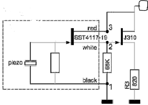

I measured PXE input voltage that feeds the ACH-01 and J310 FET. And i got only 2,15 Volts with the Bias Pot at max when ACH-01 was connected.
Strange since it should only consume approx 60uA according to the supplier.
Voltage at Pin 2 is >6 volts when not connected..
I wanted at least 6 volt (half the supply voltage i assumed) when connected so back to the Weller.
Decreased R9 by stacking another 0805 1k resistor on top to 500ohms and got 2,7 volts.
I measured the supply voltage after R17 and it was 7volts, oops.
I stacked R17 with 680ohms and got 400ohms, and get 3,7 volts!
Great, now i started to get a tiny little output on the scope.
Then i decreased R6 from 4,7k ohm to 820 ohms by stacking with 1k ohm and gained 0,8 volt to 4,5 volts. 🙂 slowly making progress, and i was regretting why i did not buy Cling On? Well well.
I stacked another 680ohms to R17 and get 250 ohm 1k//680//680 i ended up with 3 stacked 0805 resistors and 5,3 volts on PXE in
Finally i tuned the current mirror T2 by changing R8 and R11 from 1k each to 500 ohm, guess how.
Now i can regulate the bias voltage between 2,45 and 5,82 Volt and i think i will stop there.
My question is why the big voltage drop when connecting ACH-01?

The idle current for the ACH01 is much lower then with the starbass series due to the usage of a higher Rsource.My question is why the big voltage drop when connecting ACH-01?
I also built the sensor interface with J310.
I adjusted some values that can be used for ACH-01.
Then there is an issue with DC on the output.
I solved it by adding 3,3 uF on the open loop jumper, and increasing R25 and R26 to 47k Ohms not to disturbing the phase margin at low frequency.
The DC output comes from IC3A and the stage before that.. baybe a DC bias potentionmeter would be handy.. well a cap works..
I have some strong spotlights over my working bench, and the LED+ and LED- in the feedback loop for preventing too high signals (compressor) to the amplifier, they act as a photocell! so if the LEDs in is not getting the same amount of light they interfere with an extra bias voltage over IC3B 😱
It took some time to figure out that also... looking at my scope i saw some DC voltage coming and going while I fiddled around on the board. I ended up painting them! If you put the electronic in a box you will be just fine.
