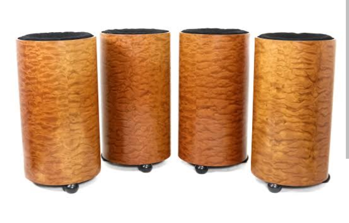

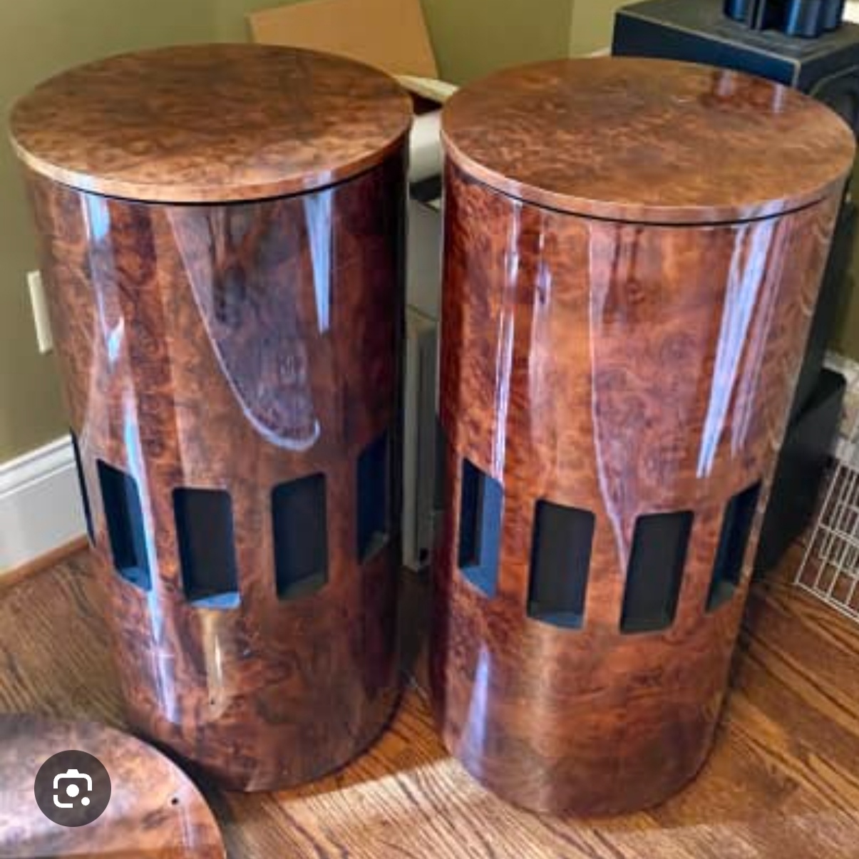

I also found pictures that look a bit different.....how are these different and did they also come with the PipeDream speakers?

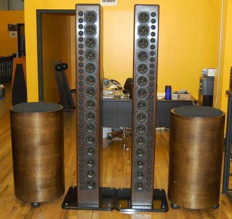

And fore completeness here is the whole set
I’d guess sealed, push-push.
Top ones likely up and down firing, firt one with end mounted drivers, in the second, mounted in the middle firing out the slots. Cylinders are inherently stiff and coukd be cardboard, plastic, or one of the formed wooden cylinders. bCHeap and effective.

So I actually own a set of pipedreams. I still have the subs but switched to REL 212SE subs. They sound great and go deep but just can't compete with newer technology. It was hard to get the Pipedream subs to really integrate well. They have 2 18" subs in each drum. Both point up. They are wired opposite of each other. The external crossover provides eq to help them get way low. I believe they are Eminence drivers. Whatever you're trying to do, good luck.

The biggest challenges are related to the speed. There are so many small drivers in the pipedreams that they really don't need to move much to get output. This helps them be super dynamic and more efficient. It also makes 2 18 inch drivers struggle to keep up. Those Eminence drivers if I recall weren't really built for that either. The magic sauce was more in the crossover / EQ but that's still trying to overcome the driver choice itself.
