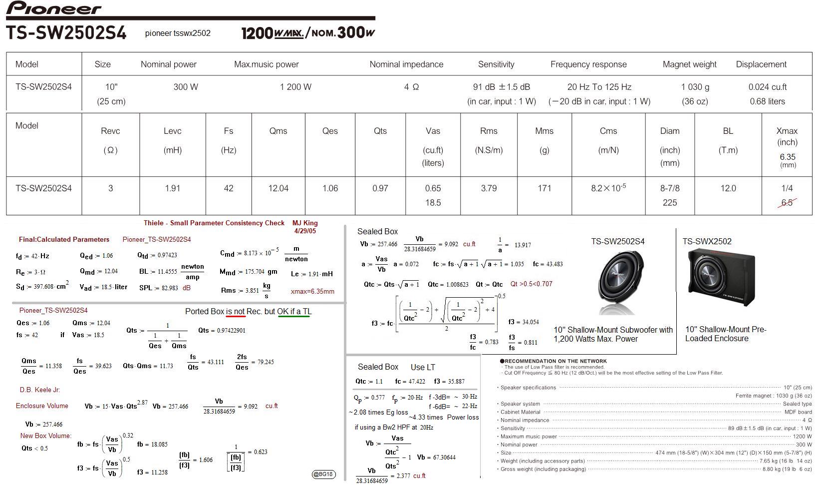

Does anyone know where I can find specs on the pioneer tsswx2502 10” Shallow Subs? I want to use these to experiment and build a plywood box tuned to 30hz and another one tuned to 60hz for home use and maybe a personal experiment and I have these subs...

Hi maLX,'
Google blind?
https://www.pioneerelectronics.com/StaticFiles/Manuals/Car/TS-SW2502S4_InstructionManual092216.pdf
FYI:
