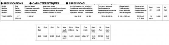

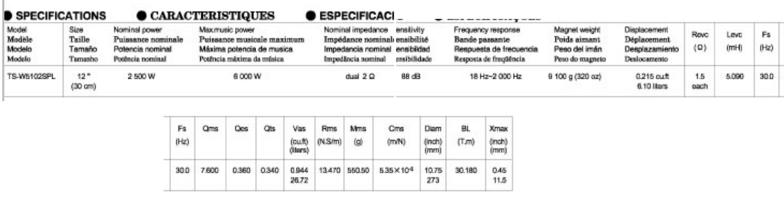

Sorry I can not work without the T/S parameters.

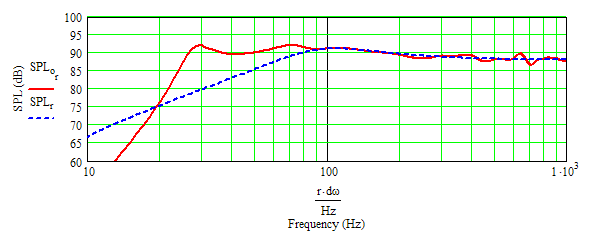

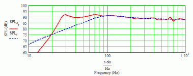

More data for your woofer in a BR.
PIONEER TS-W5102SPL, VB = 15.8 L, FB = 27.7 Hz, 87.9 dB2.83Vm.
F3=41Hz, F6=31Hz, F12=22Hz (free field)

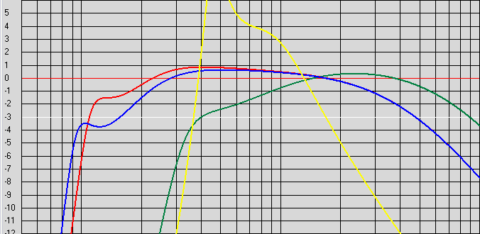

Your sim doesn't account for its huge inductance, so not even remotely accurate without significant EQ. This driver is a 'one note wonder' with specs that dictate TL loading.

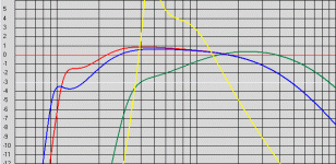

I was planning for 83.7L box with round port 153mm(diam)x200mm(length).
Really?! See yellow trace. Is this for a car SPL competition or.........?
GM
I'd guess what 'GM' is trying to tell you is that..........These car specific subwoofers perform rather poorly.....they really don't go down very low in frequency without lots of equalization & lots of Wattage. When they do get that low, they have lots of harmonics (Different frequencies added to the primary frequency) & sound odd.
These drivers are designed solely for volume & do not accurately reproduce the low frequencies.........as a result, attempts at modeling "accurately" sized boxes brings about bizzare results (Very small sealed boxes).
I'm sure they will pound away just fine with the small sealed enclosure.....just don't expect precise low tones.
I've built a "precision" subwoofer & it was an "accurate" device........Just awhile ago I helped my brother-in-law build the requisite sub-woofer enclosure for his car...according to specs, a small enclosure, High-wattage affair.........Frankly it sounded very poor...but he likes it (Boom, boom,boom). It uses a driver similar to yours.

Well…….yes and no, the high inductance severely limits it for sealed and typical vented alignments, hence a ‘one note wonder’, but I did note it’s suitable for a TL, which by association includes the MLTL and tapped TL/horn.
Anyway, ‘ran the numbers' for an offset driver MLTL tuned to Fs, which shows plenty of gain, but the driver is so deep I don’t believe it will perform as predicted, so will try some different alignments as time permits.

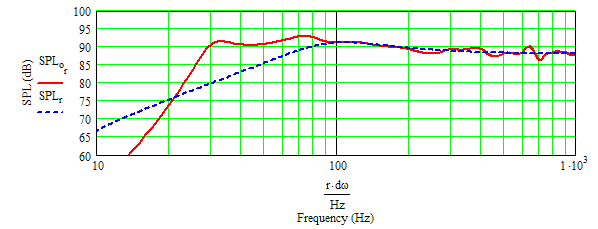

OK, I increased the size of the one fold cab I simmed earlier to allow for this driver’s depth and the simmed response actually looks a bit better overall, but it’s pretty big at ~48” high x ~14.25” wide x ~33.75” deep assuming ¾” [19 mm] thick panels.
Ignoring any room boundary gain, at a glance it looks like it can handle ~1500 W before exceeding Xmax, so should be able to ‘rock your world’ a little.
Anyway, internal dimensions [unfolded] and approximate:
93” high
12.75” wide
15.75” deep
[2] 6” diameter vents x 5” long
driver down from top 29.5”
vents up from bottom 18.5”
The sim has very little damping, so can be smoothed out considerably more if it sounds too ‘loose’ in room. You may also want to experiment with different length vents.
GM

thanks you very much - but that is too big ... I can't fit that in my car 😀
