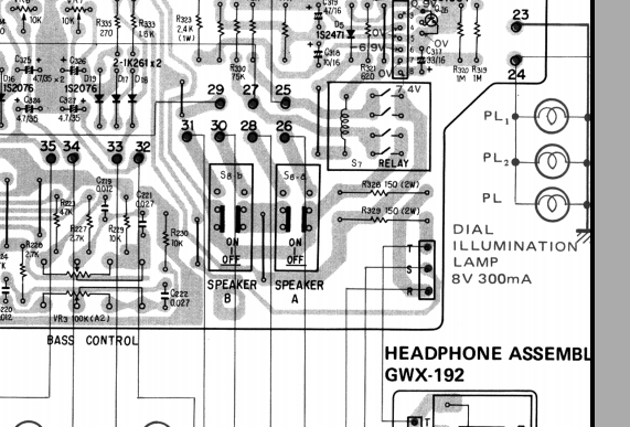

I have this amp and I believe the relay is bad. Amp powers up, but no output to speaker terminals and headphone jack. I'm not sure which pins are the relay coil but checking with an ohmmeter I found no continuity between any pins. Does anyone have or know where I can get the datasheet or pin-out for an ASR-020 relay?

One other thing to check - do you hear a click from the relay a few seconds after power up? The click would be the relay engaging. If there's a click but still no sound then it's probably dirty/scorched relay contacts. If there is no click from the relay then there may be something amiss in the protection circuit.

From service manual, for SX780, here is the foil side of the board, you can see the relay pinout, hope that helps you!

FYI, the initial turn on sequence is as follows:
The amp immediately powers up upon flipping the power switch, no soft start and no click from the relay. This should have clued me into a protection issue.
There is 53Vdc on either side of the relay coil referenced to chassis GND. I probed the PA3004(DC level detection IC) The following is my readings,referenced to chassis GND:

I measured the DC offset directly from the speaker terminals and all measured 0Vdc,also my ohmmeter measured no shorts across spkr terms or around the STK's.
I will check the Vdc on the STK's and post. I found a service manual and data on the exclusive pioneer IC's. Maybe theres still hope. Thanks or all your help so far
Well,looks like the output pins on one of the STK0050 has 28Vdc on them! I will pull the chip and see if I get output on the other channel.

I pulled one STK module and the amp powers up and I get audio on the other channel.I've checked around and the driver stage, and emitter resistors etc all look good. So, changing the STK should be the fix. I'm considering changing both. The good STK is an ECG replacement.

Just to follow up, although it's been awhile since I finished repair. I found a source for STK2060's that were pulled from another Pioneer. I think I paid $15 dollars a pop. This module has two pins for hooking up internal emitter resistors, which I didn't connect. After replacing both modules I stilled had a protection issue. I traced the problem back to an open emitter resistor in the push-pull pre driver stage. I don't recall the locator or value and will post more specific info when I get a chance to review the schematic. Also, this amp had a very stiff tuning knob, which I pulled and soaked in lighter fluid and lithium grease, after several weeks the flywheel was spin freely and worked nicely once installed. Of course the tuning string was a major ordeal!! But I managed to get everything back together, minus a couple of cover screws, Where do screws run off to, anyway?!?!?! Anyhow, it sounds great and my friend is happy to reclaim it!! Thanks for all your advice, Anatech, Welcome and Resistor-John and Nigelwright!!
