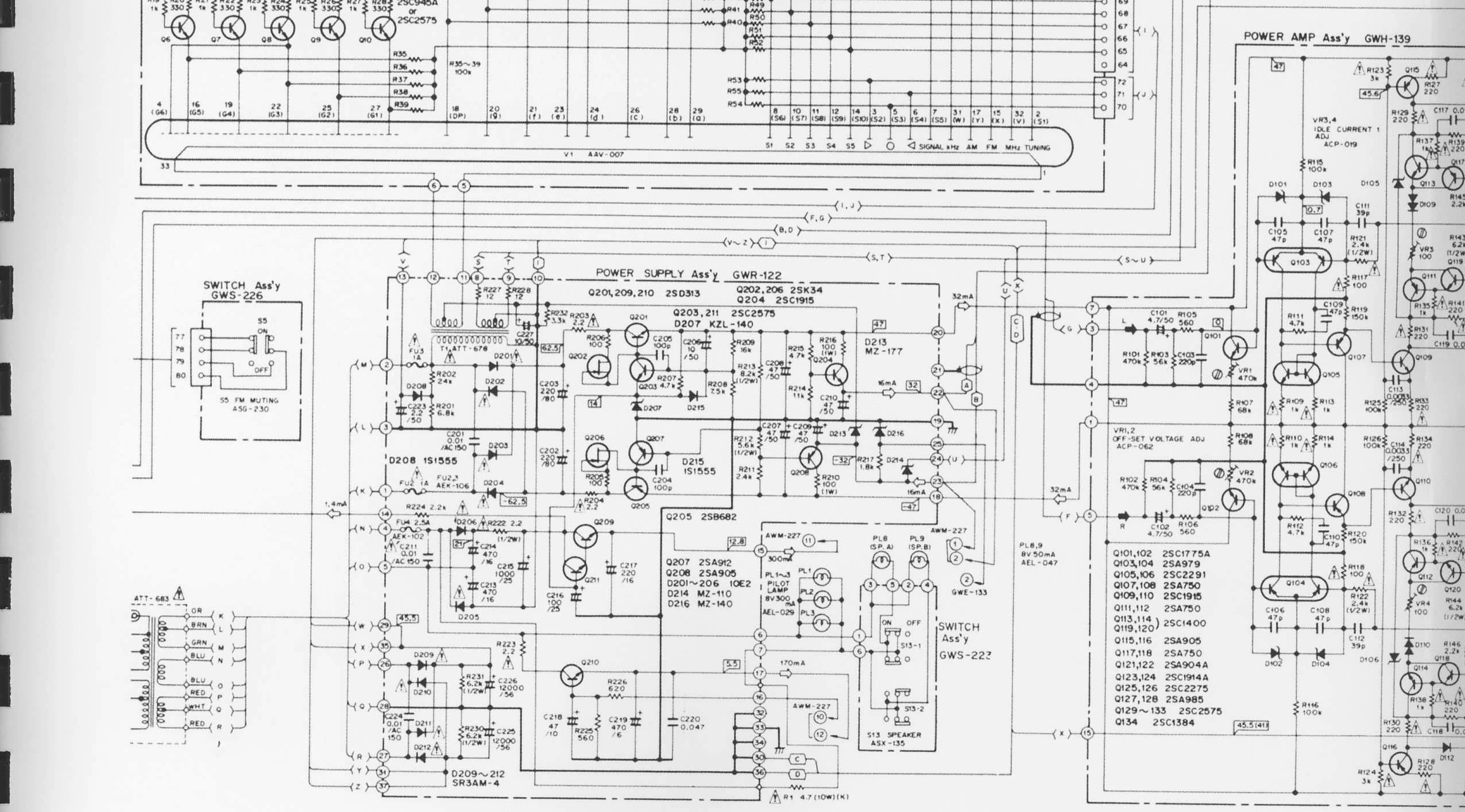

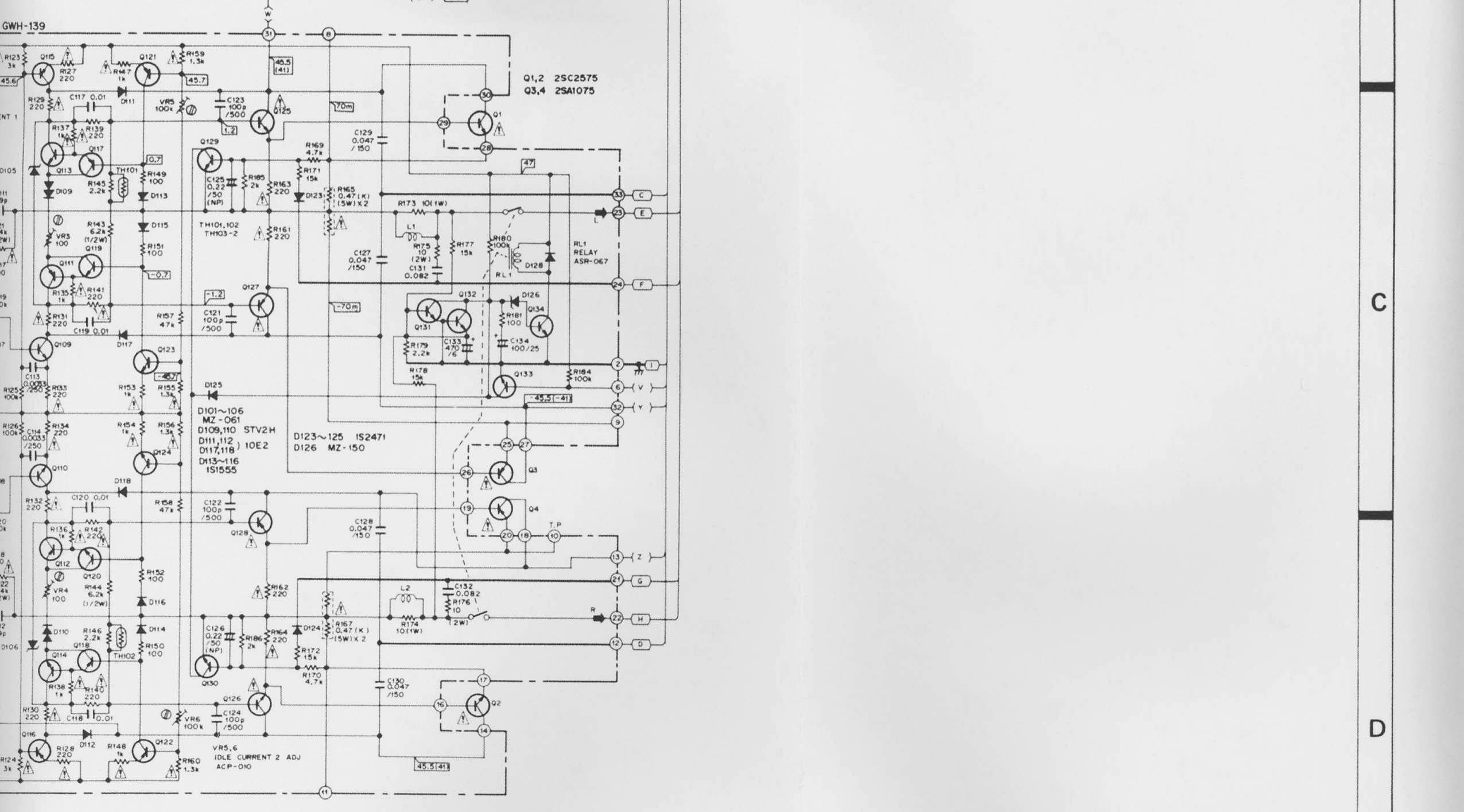

Hello, All experts I just repaired Pio. sx3800.(PSU, POWER AMP, TONE. I removed tuner section because i want to use it as power amp for aux input only) ) it was dead and some components were missing. some components are not available at local market, so i used equivalents. mainly, i made 3 changes (1) i used C5242, A1943 as output tr. (2) i used C5171, A1930 as driver (3) In schematics there is D109 ( STV 2H ) in bias chain, which is outdated and not available, so i used ordinary 1N4007 diode. except these changes rest circuit is original. i checked and set dc offset about
+- 5mv, then set bias preset at middle position , then checked voltages at bases of drivers, it shows 1.10 V( + and -), then i started amp with cd player conected to input and i put 22 ohm res.( series connection) between main power rail for safety. Amp came alive. then i removed 22 ohms res. and powered directly . Amp is working ok. But there are two minor problems. (1) Q115 ( vas ccs) and Q109 (pre driver) becomes hot ( not very very hot) (2) sound is very good (not excellent) upto 40---50 % vol. level but afterwards it becomes distorted. i dont know how to solve this problem because i dont have any CRO or Analyzer. I need some tips and tricks from experts to rectify these problems. kindly help and reply as soon as possible. thanks in advance, sorry for bad english.
