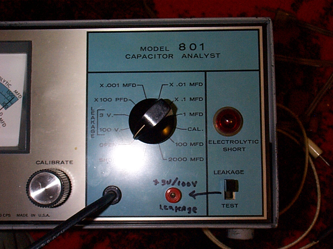

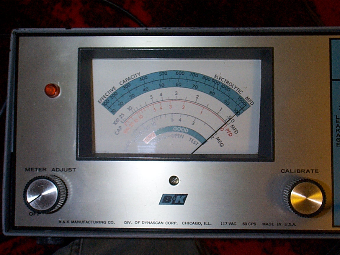

KenPeter, tomorrow I will go to a shop and get a "capacitor analyst", which measures capacitance, I think ESR, and leakage at 100V. I can use it to test caps. I will write down all the obvious oil caps. The two PSU caps are 150V, 100uF, which I happen to have several scavenged switching supply caps that should work (KME pair of 100uF/200V, Marcon pair of same, ambiguously marked pair of 200V/470uF, a soon to be unsoldered Rubycon pair of 470uF/200V, and 5 small Teapo caps, hardly worth mention. I'm betting on the KME pair). I've also got photoflash caps, but I think these have better uses elsewhere...
