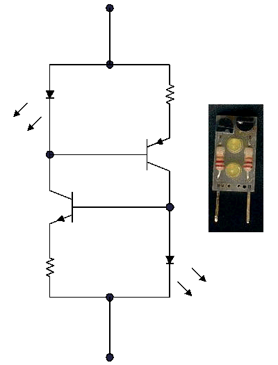

Hi Glenn,
Nice boards. I normally make a current source with about half the transistors and LEDs. What is the maximum voltage they are good for?
Overkill but more reliable in the end. I'd try them in there.

Max voltage can be very high, since the two transistors split the C-E voltage necessary to get your required current. A couple of high voltage transistors and I don't see why this wouldn't work up to a couple hundred volts.
I liked these since it was only two terminals. Higher parts count, but back when I was having the boards made I needed a two-terminal solution.
I've used these a few times, and the original design called for LED's, and that's what the mini-schematic shows. In practice, I found too much variation in LED voltage, and I had been sticking two series'd 1N4148 diodes in there instead.
I could do this...shoot for about 2mA?? That sound right?
Hi Glenn,
Yep, shoot for 2 mA and see how it runs. I guess you want a highish (say 80 ~ 120 Vce) voltage transistor with high gain. Not hard to do, just watch your dissipation.
