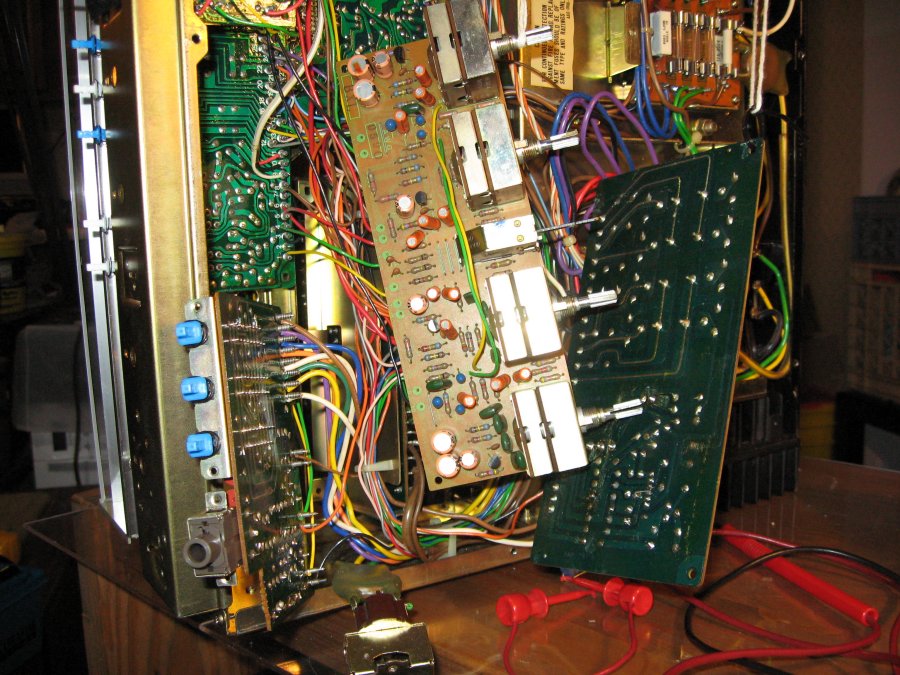

I got this receiver like 14 years ago and I've kept it in nice shape. It's been having some issues though. The right channel doesn't seem to want to come on until it's warmed up for awhile. I'm 99% sure it's preamp issue, since I can run a separate preamp into it without this problem.
Also, The left side will also want to cut out when I use the push button associated inputs. Wiggling them will bring it back. Avoiding them by using the associated tape toggle switched input avoids this issue. The tuner is on a push button input, so that can cut out too until I give it a wiggle-jiggle.
I brought the rcvr to a local family run repair shop that's been around for many years. I told them my issues, they took it and said they cleaned it but nothing really ever changed. Very disappointed needless to say.
I'm not sure where to begin, I don't think I should just spray cleaner into the switches themselves because i don't want to make a mess. Should I try to remove the front panel?
If you have worked on these before or have any insight (or schematic!?), let me know. Any help would be greatly appreciated.

My experience with these old receivers is that the switches may need to be cleaned several times, the unit has to be opened up to get at some of the switches properly. this can be done by yourself if you are adventurous. (and have a service manual) Deoxit has to be sprayed into the switches to cleane the contacts, and the buttons have to be pushed many times with deoxit in there. If you read thru some of the similar posts an AK this subject comes up all the time.

Here's an opened up 1280 from the bottom...

well ... a fine machine but way too complicated unless your are an expert on vintage amps ...
here is a few things to look at
---isolate the problem ( well done so far )
---take samples of a few caps small electrolytics if one is leacky all of them need to be replaced
--- yeap !!! thats a pain in the @ss job to do
--- and yeap all means all ( average electrolytic has about 2.000 h of life and that apply only if not exposed to heat )
--- create a signal tracer..... that will be the cr@@piest computer speakers ( with the small amplifier included) you have ,install a small elctrolytic of 1 mfd/63 volt in the input to isolate dc if you connect there accidently and trace the signal from input to output to see where it gets lost ...
this is the simplest way to do it but still will require to know your way arround it ...
would you like a schematic ??? i will check if i have it .... hold on please ... ok ...i have it ...
e mail me if you want it ....bit small 60MB
kind regards sakis
