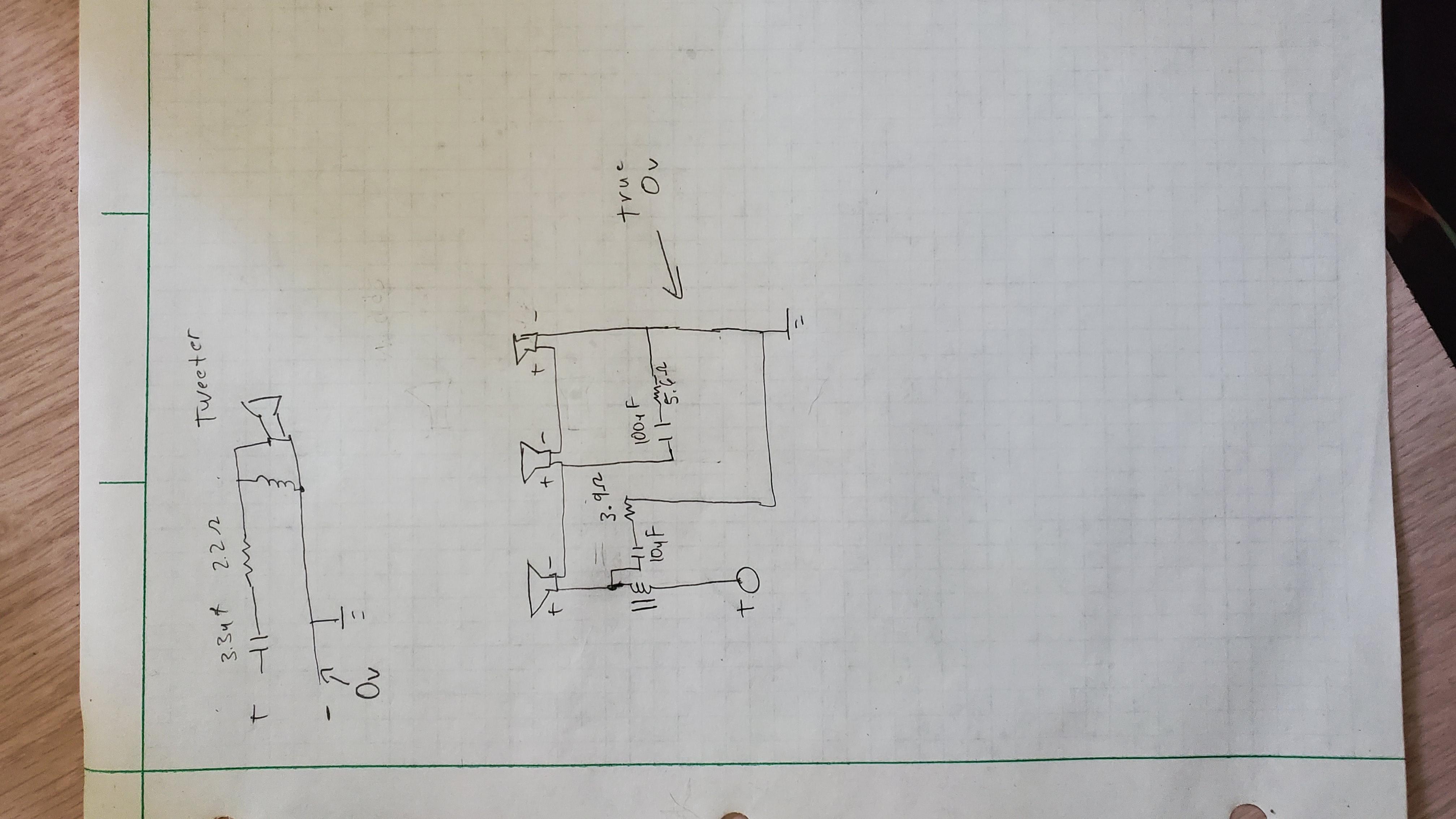

I basically want to upgrade the parts to see if the sound gets any better.Im doing this for fun and also to learn. Also because I don't understand why the mid woofer and the 2 bass woofer are all is series.

Pioneer describe the SP-FS51-LR as having "three woofers". They also say it is a "3-way" with crossover frequency 2.5kHz.

Your circuit shows the three woofers in series driven by a second order low pass crossover. It looks like impedance modification has been applied across a pair of the woofers and perhaps the crossover experts will elaborate on that.
