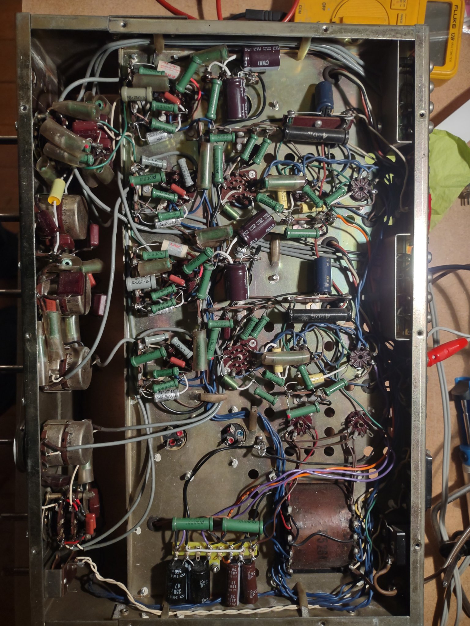

At long last got started on this. One advantage of the cold and dark days is that there is a natural break from jobs on the house, so can tinker without guilt ;-)
I tried to slowly crank the amp up to voltage on a variac so I could take voltages from the valve socket pins, but some test music sounded absolutely awful, and I soon saw that it looked like there was DC on the grids of the output tubes, so decided the recap had to be done.
Replaced all the paper in oil (PIO) caps and electrolytics, disconnecting the can caps and fitting new electrolytics under the chassis. It is a metal chassis with AC heaters, so as Eli mentioned above I will probably never have top notch sound. There is an interesting grounding scheme, however, with quite a lot of shielded cables to and from the controls, and a star ground at each input tube, so has had some thought. I left all the resistors after testing a few and they appeared to be within tolerance.
I tested the tubes and they are not perfect but would all classify as 'OK' on a tester. The 6AR5 output tues were around 90%, and the 12AX7s 60%, but well matched halves.
I had some problems getting it powered up again after the recap. The gain/splitter 12AX7 would not conduct on one half, but it looks like that must have been dodgy sockets since eventually after swapping tubes around they all worked OK. Hoping the sockets are just intermittent through lack of use, but they are paxolin and maybe ought to be replaced eventually.
When it was powered up OK I managed to collect all the voltages I needed, and they looked in the ballpark. The volume control is incredibly scratchy in a way that sounds like bad coupling capacitors, so now I need to turn my attention to the non PIO caps. I have attached some pictures and would be greatful for any views on them. Are they a known weakness? The brand is 'Clover' but nothing showed up on Google.
In the end I left it running with some music on the Bluetooth to Aux, and it did not sound too bad.
Now I have to decide the next steps. It is not in such good condition that it has to stay original. There is a switch for 'Stereo, Mono, Channel', where channel is just one channel. I am thinking that I will adapt that so that it can bypass the other controls. That will get me to the point where I can assess how much noise is being contributed from the preamp stage.
There are some electrical safety changes required - exposed fuse at the rear, electrical outputs (which caused melted wires inside), maybe the electrostatic outputs which I can't imagine being needed. That simplifies the wiring a bit.
There are also equalisations not needed at the input, so if I do look at replacing components in the phono section, I will not bother with the Xtal cartridge and Tape head equalisations. Instead add one more line level Aux input.
Anyone with any experience of these amplifiers? The output transformers look OK, 60mm x 70mm so around Dynaco EL84 PP size. It is not impossible they are produced by Tango.
The rectifier tubes are a rarity, 5R-K16. A bit like an EZ81 but with a 5V heater. Thankfully they tested OK.

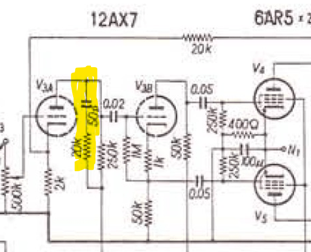

Can anyone guide me how this serial resistor and capacitor affects the circuit. It looks like a Zobel network and is across the anode load. Plugging the figures into an online calculator the values correspond to an impedance of around 18K and 25mH?
Leave it alone.
There are multiple high-cut phase-shifts in a tube amp. If they happen at similar Hz it will oscillate. A lag network makes one dominant. This is not the same as a Zobel but if that makes sense to you, OK. The measurements and calculations are very tedious; values are usually determined on the test bench with multiple test loads. It has no effect over most of the audio band, at least the part where the power is. The overall NFB masks the shelf in forward gain.
Reactions: OldHector

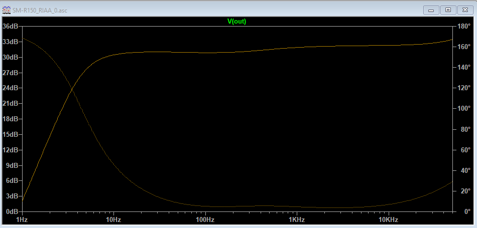

I am in a bit of an impasse. I don't feel there is a magic bullet that will return this amplifier to HiFi status, and now I need to get some conviction for what the next steps should be.

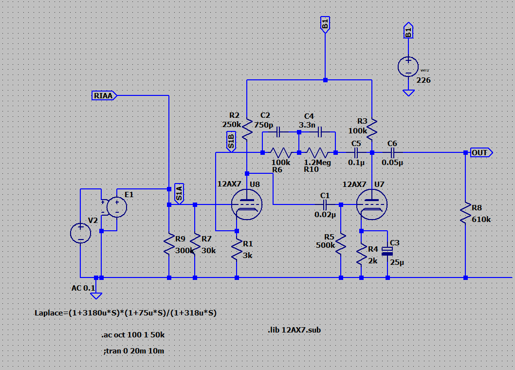

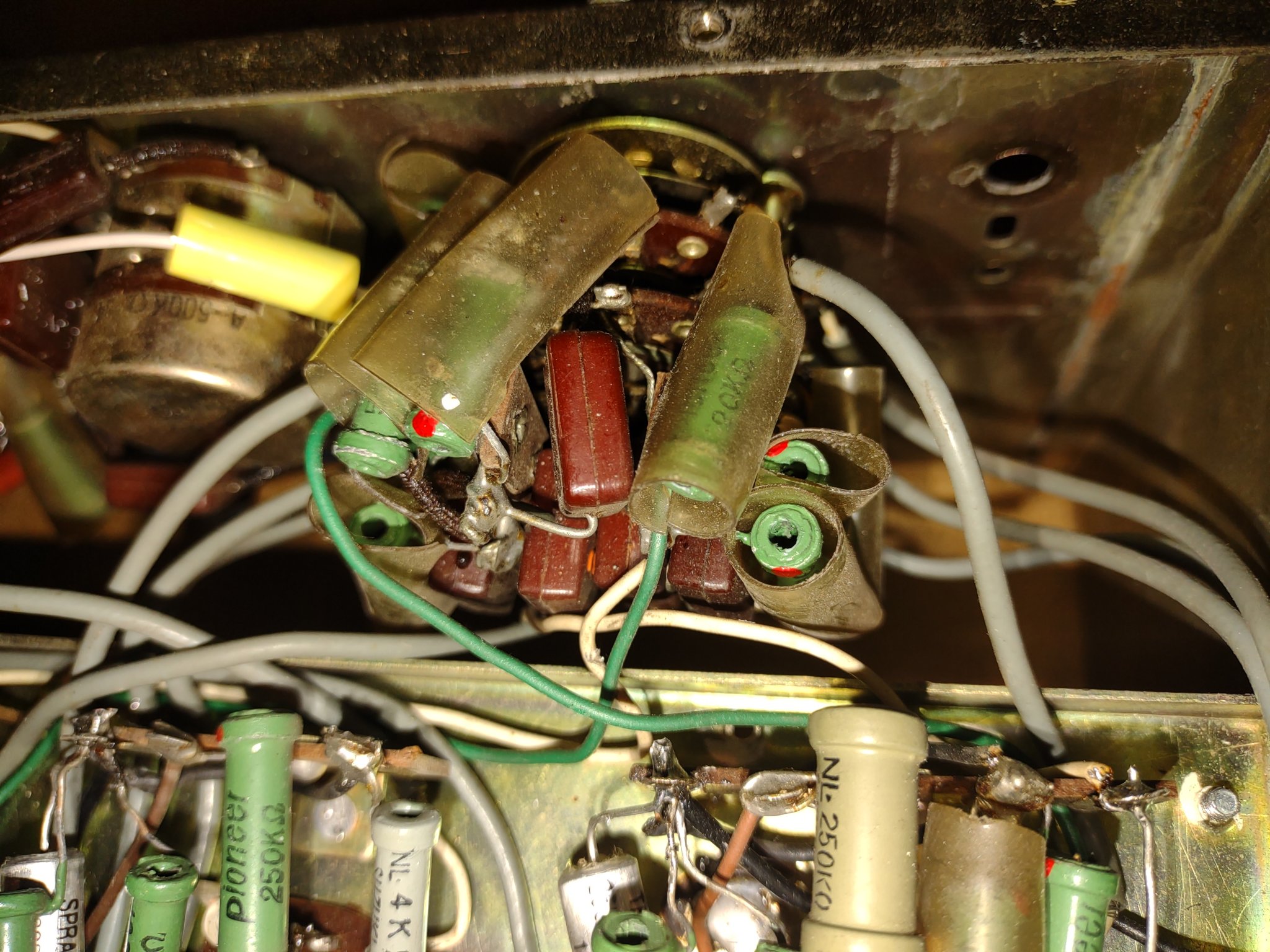

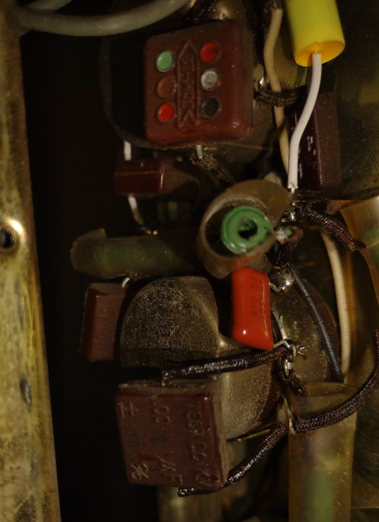

Looking at the different stages in the amplifier, are there any thoughts on this RIAA implementation? I have decided that I will rework the input selector. I do not need Tape and Xtal inputs, so I am aiming for 1 Phono input, with RIAA equalisation, and then 3 line level inputs. If I am doing a bit of surgery there, then maybe I can improve the RIAA implementation at the same time.

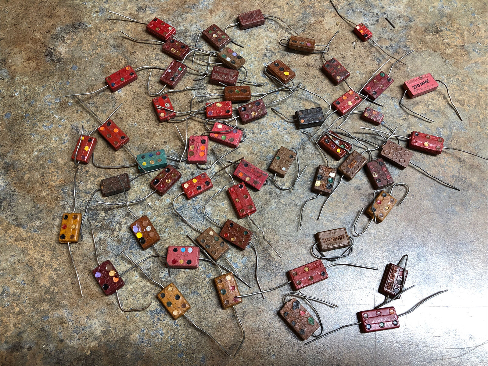

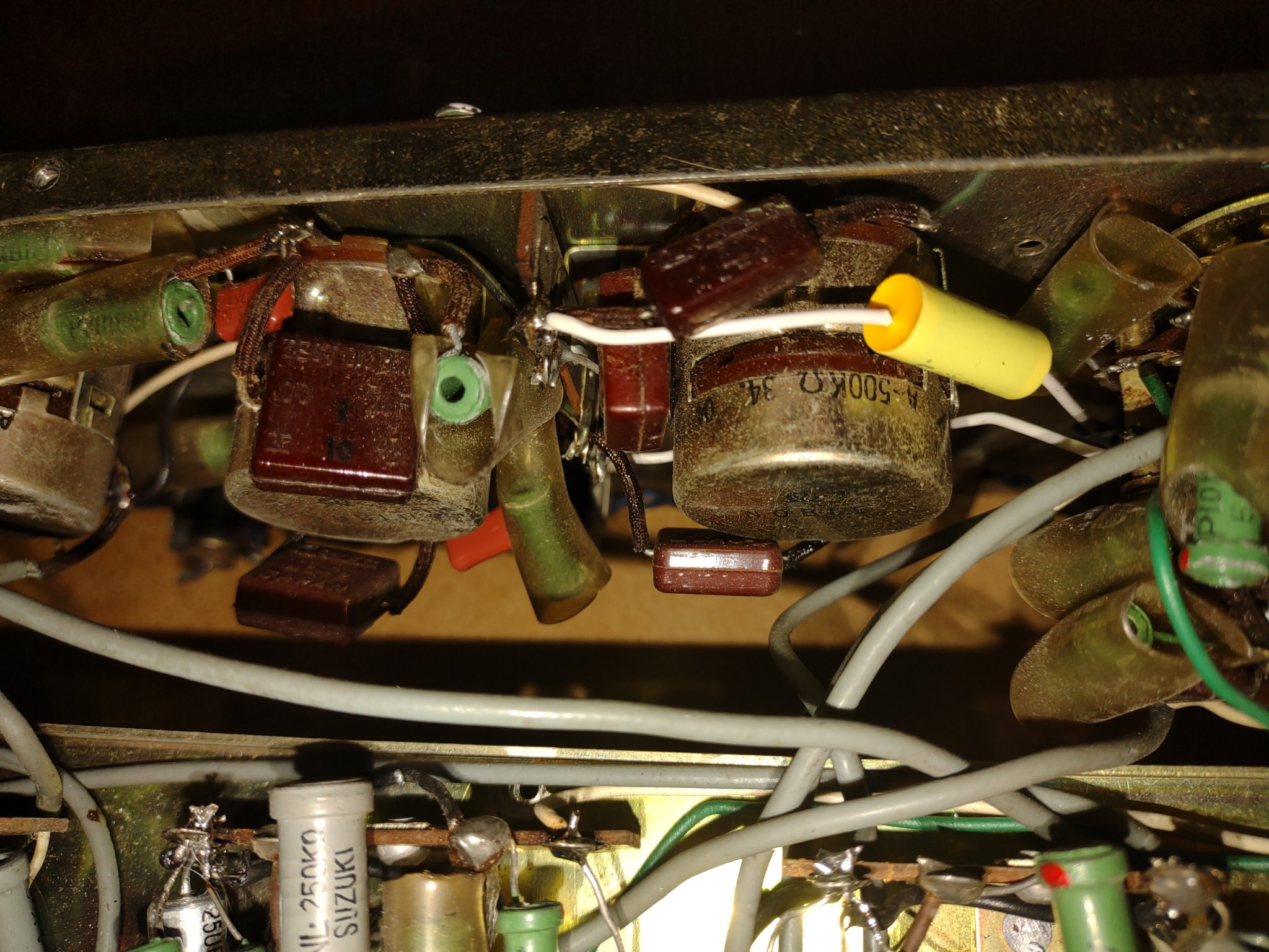

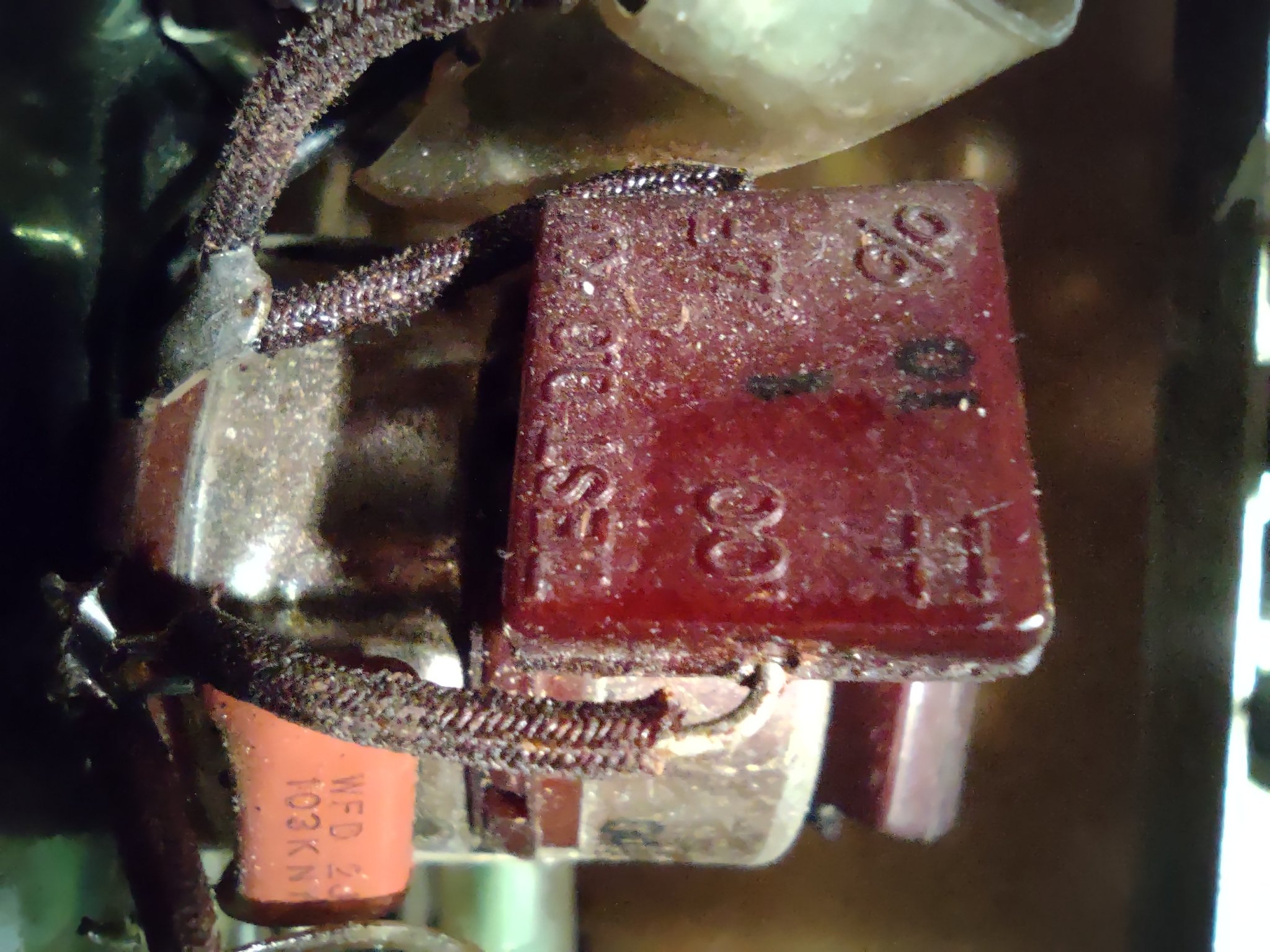

Also, I am a bit hampered by not having a capacitor tester. There are lot of brown lozenge capcitors (some with brand name Clover) in the input stages and used in the RIAA. If I am going to rework the RIAA implementation, then I would probably build with new components - I have a good selection of silver mica capacitors - and perhaps base on the RCA RIAA implementation.
The brown caps you are asking about are look like old mica capacitors. They should have 6 colored circles on 1 side (2 rows of 3) indicating value

I have an ltspice simulation of the amp now, since I am considering some changes. I also was surprised the volume control was where it was. The 0.5v line in signal is down to mV after the tone controls.
The 6AR5 is the same data as a 6K6GT, and there are curves and operating points for that tube in PP with 285V on the plate and shared cathode resistor if 400R. The OPTs are 12K, so not so flexible.
I took out the tube before the balance pot, so listened to the driver, splitter and output section, and it was totally silent, so I am coming round to the thinking to get it running without the previous stages and adapt the previous 2 stages to an active Baxendall tone control, and a RCA style phono stage. The rectifier tubes are 5V heaters, so maybe further down the line lose them and add a voltage doubler off that tap for preamp DC heaters.
I was looking at the Dynaco SCA35, for some inspiration, but I don't think I would be able to reuse the components I have. The pots in the pioneer are all 500K and branded Noble and probably worth hanging on to.
Adapting the Stereo/mono/channel switch so one option is 'direct' skipping the previous stages, will be the first change and is not too destructive. That will impact the tone stack if I aim to keep the volume control.
re: post #16: Of course you'll want to remove the low level switching and change R9||R7 to standard loading 47K. The single 12AX7 phono equailzer is (or at least was, before simulations) a wonderfully challenging puzzle, and very often encountered when restoring Golden Age gear. Yours looks like a very clean design, but I'd worry about having enough open loop gain for very low frequencies - R10 is the correct value for lots and lots of open loop gain, but may be too small for here. This page:
