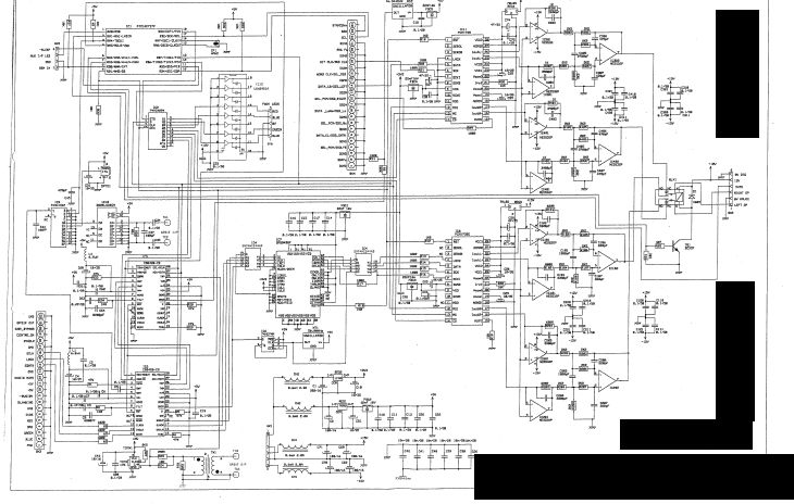

Is any one who can tell me the DAC Chip type about Pioneer SACD Player PD-D6 ?

If we are talking about there newer model, the grey one PD-06-J, then it has a pair of BB PCM1738 according to a thread at our Swedish forum. The OPs used are NJM5532

No. Like the DSD1792 that preceded it and the PCM1792 that followed, the PCM1738E has a native DSD input. There is no DSD to PCM conversion needed with this chip.
The I/V conversion uses a double bipolar opamp per channel, the Opamp used is the NJM5532.
The LP filter that converts the signal from balanced to SE also uses the NJM5532 which is shared between the two channels.

All the above is true. I bought this player at reaonable price from Melbourne because it is relatively easy to modify and I already have all the necessary parts except for a clock. Off the shelf it is not a bad player in its price range but simple mods carry the potential of turning it into something really nice.
The analog section has three njm5532 soic opamps which can be replaced with Brown Dog soic adaptors and then one has quite a number of possibilities. I intend to try ths4031ID and ad844 for IV stage and opa627 at the output.
The output 47uF caps will be replaced with Black Gate 100uF caps paralelled with 2.2uF polypropylenes. A few other electros will also be upgraded. The next more expensive step is to upgrade the clock. To do above I'll wait a few more months as the player is only 3 months old and still on warranty.

No, there is one PCM1738 DAC per channel.
The signal from the pickup goes to the main SACD/CD decoder MT1389EE/B2-L. Then, from the main decoder, it is taken to digital output circuits (optical and coaxial) and to PD0274A L/R channel PCM. Then there is one TC74VHC157FTS1 (PCM/DSD), fed from both PD0274a and main decoder, per channel followed by one PCM1738EG3 per channel.
Then the I/V conversion stage uses dual njm5532 per channel and final amplification and filtering is done by one njm5532 shared by both channels.
Unfortunately my Acrobat reader does not allow to take a snap shot of pages (I have the manual in pdf format as well) so I cannot show bits of diagrams and schematics here.

The PCM1738 does directly accept the DSD stream. Also the Pioneer literature states there is one single DSD decoder. So I think there is no DSD to PCM conversion.
