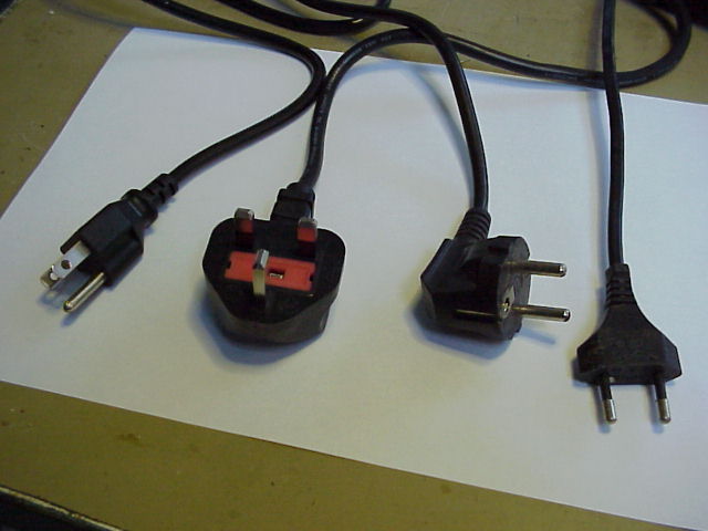

Nicole,
Here's a picture of different plugs. Can you select one to help us understand? Don't touch the voltage selector, it's fine at 240V.
/Hugo 🙂

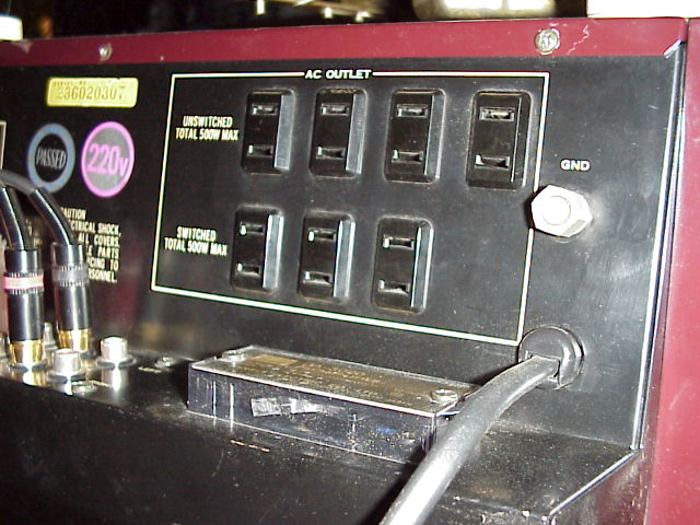

hi,
yea i do recognize those ac outlet things....its practically the same on the back of my amp......."switched 150w....and unswitched 200w"(sorry but i dont even know what that is for really...; /)

hi hugo...
yea its the standard uk one ...second from the left on your picture.
and it just has a 2 wired lead goin into it from the amp...no earth .
except when i got it someone had previously connected a wire from one of the ground terminals on bk of amp.. to the earth in the plug!!!!!!!!!!!.....pretty sure that this was unnecessary.....but not sure if this amp has the origional mains lead in it still...looks like it but cant be sure.

Do yourself a favor and take your amp to someone who can fix this, i.e. a local electricity shop. If you're lucky they will fix it instantly and you will learn the most out of looking how they do it and asking a few questions.
The AC outlets on the back are there to provide current to other equipment connected to this amplifier, meaning that the other equipment needs to have a plug that fits in the outlets.
'Switched' will switch on the connected equipment when you switch on the main amp. 'Unswitched' means that the outlet always carries 240V when your amp is connected to the mains.
Don't stick anything in there.
