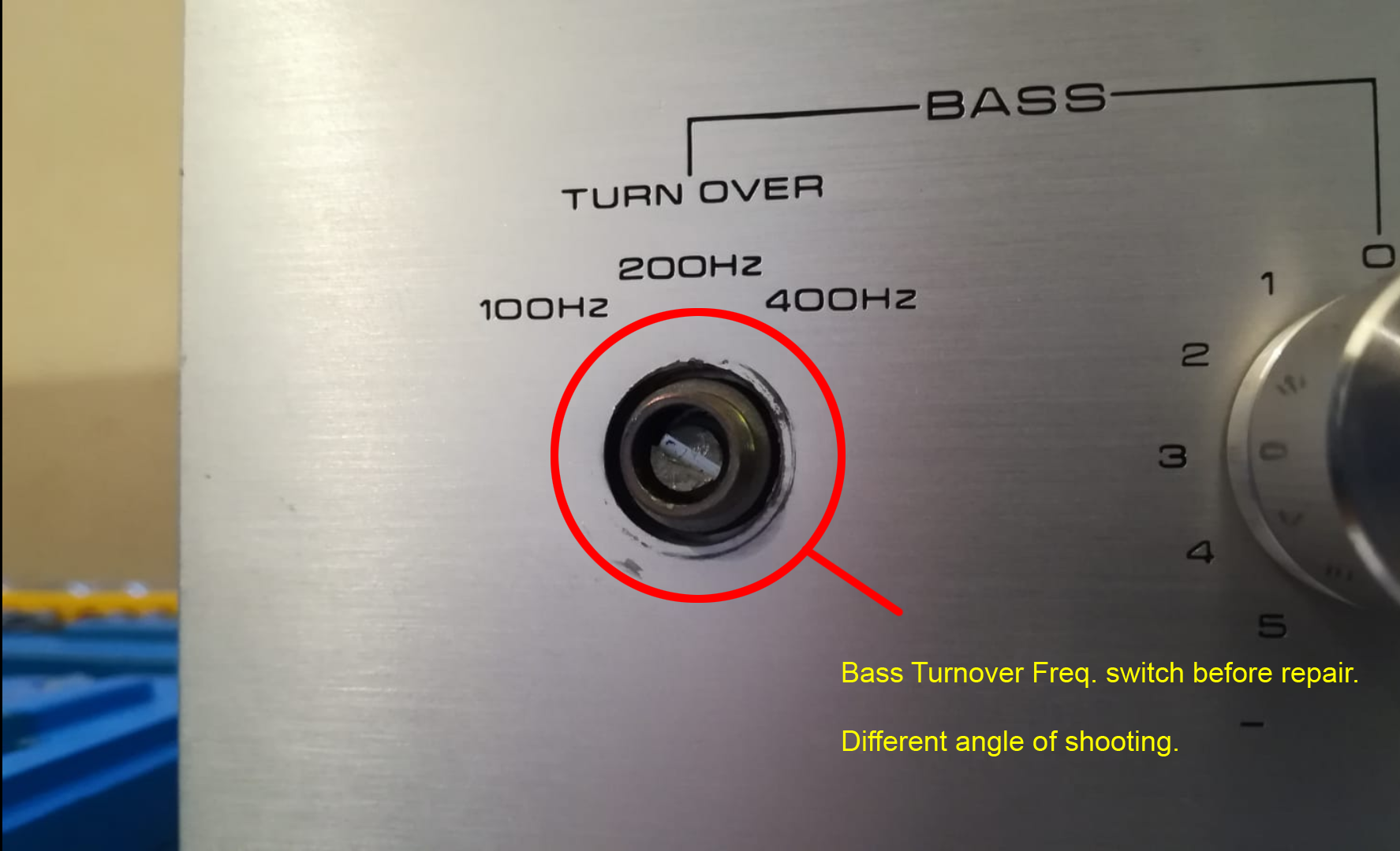

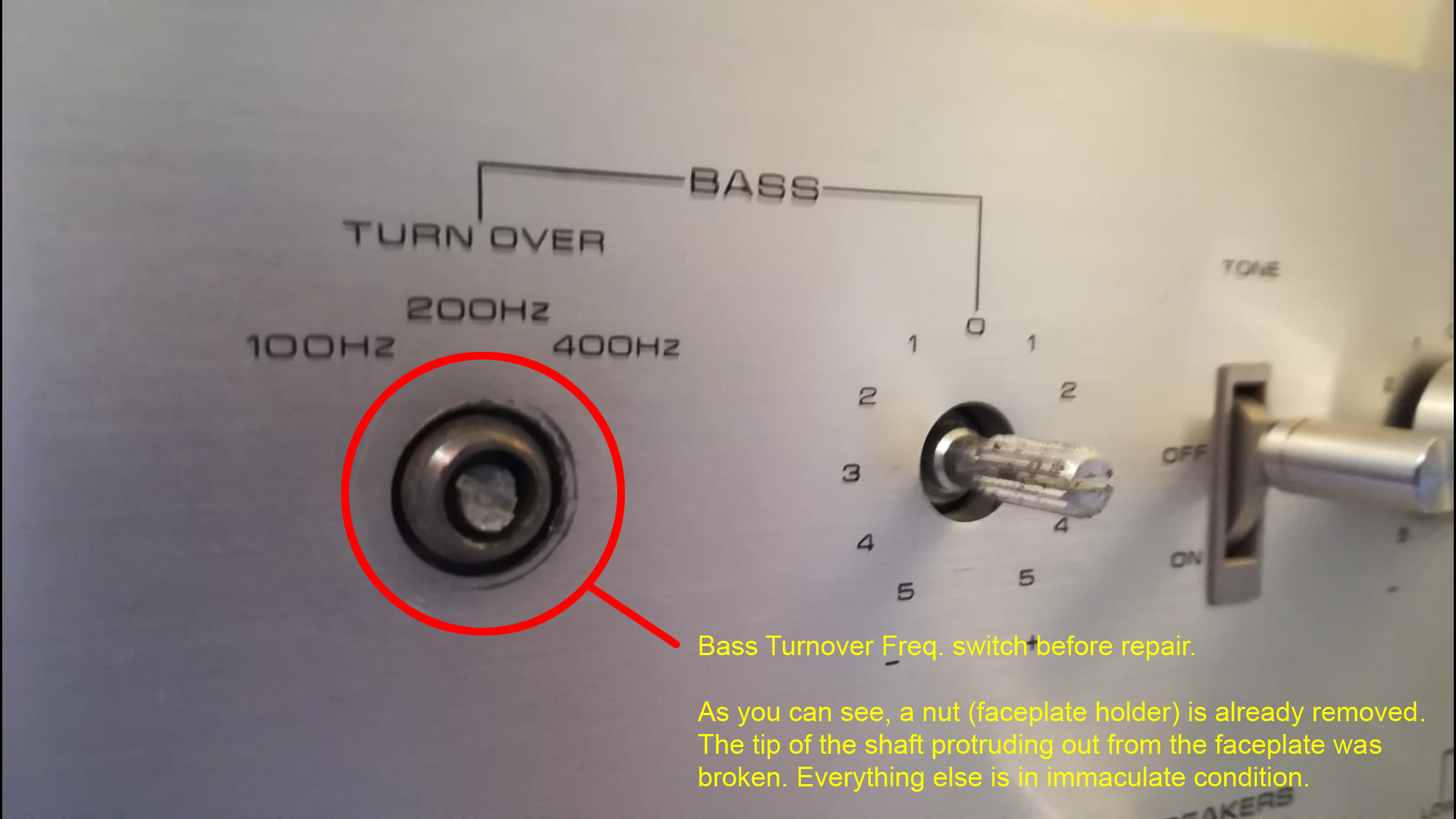

Hi all!
As the subject line says, I am looking for 3-position rotary switch (for "Bass Turnover Frequency" Positions) for Pioneer SA-8500 II model. Also, a knob that goes on that shaft is missing as well. Original part numbers from service manual are:
- Bass Turnover Frequency, rotary switch, 3-positions: ASD-057
- Knob: AAB-116
If any of fiune people has one SA-8500 II for spare parts I would gladly pay for that switch and for that knob.

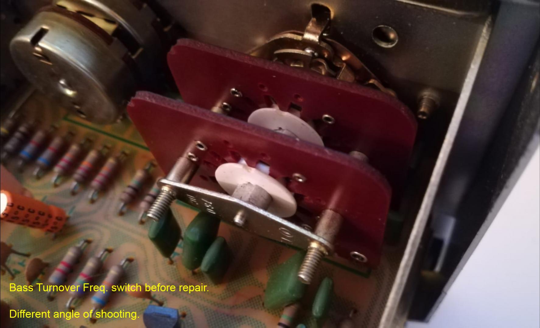

I checked that source you sent me. I need to continue my search. Amp has finally arrived and now I am in real position of either eyeballing or tkaing it apart to see whether the shaft alone can be replaced or not. If my eyes are not deceiving me I would say that switch can be disassembled. So I can either find replacement switch or find any donor (ALPS-like rotary switch) that have same or similar construction. Same shaft in lenth or longer is OK. If all of this don't give any result I can always give steel rod to a CNC master to make me a shaft accoridng to specs and drawing.

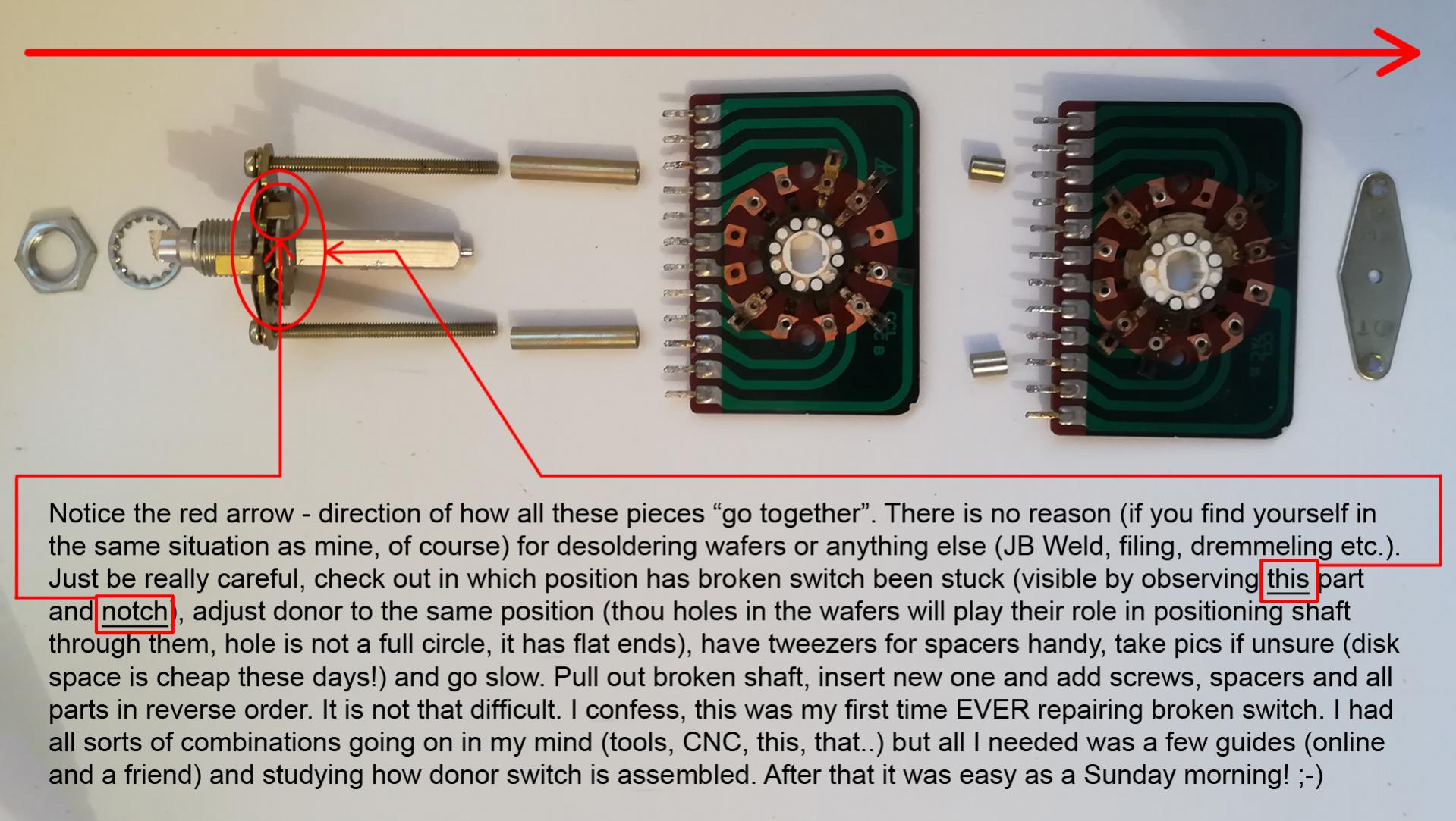

I would like to thank all for participating any giving me feedback. I solved the switch and I am simply pasting what I wrote on AK. ;-)

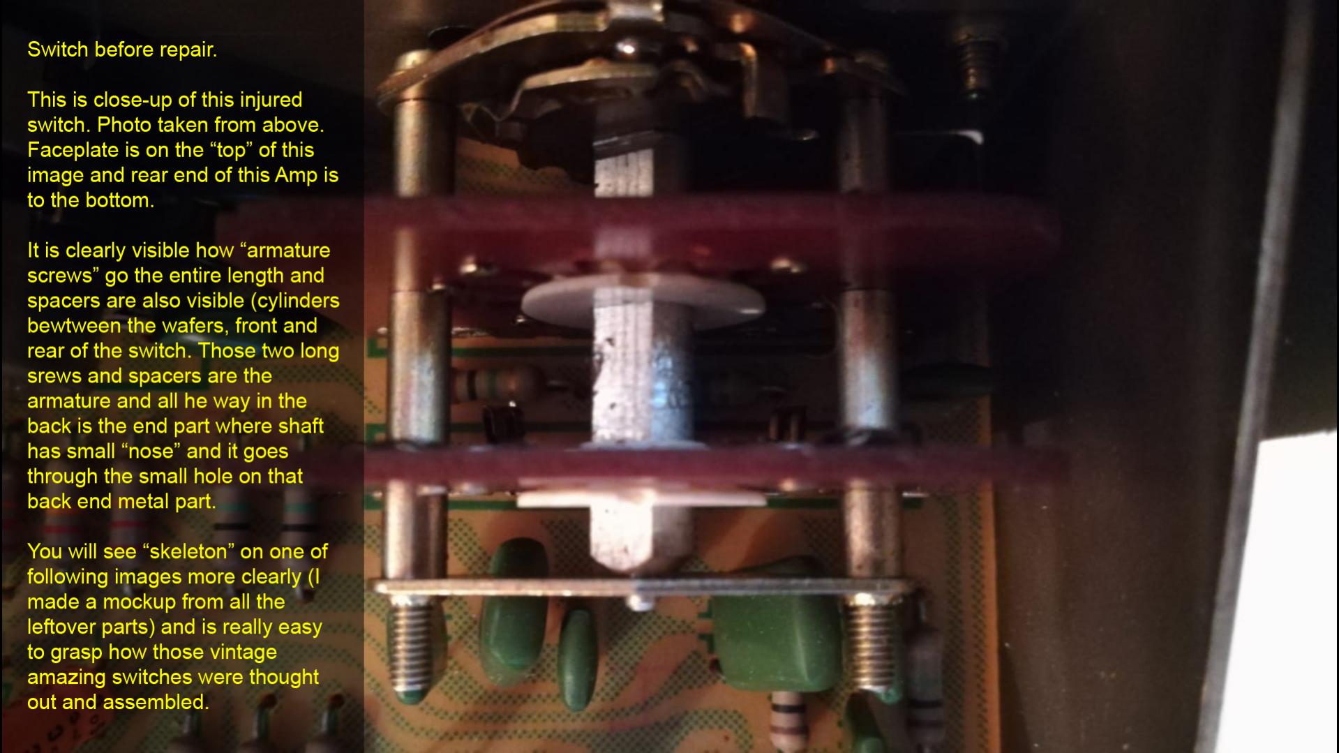

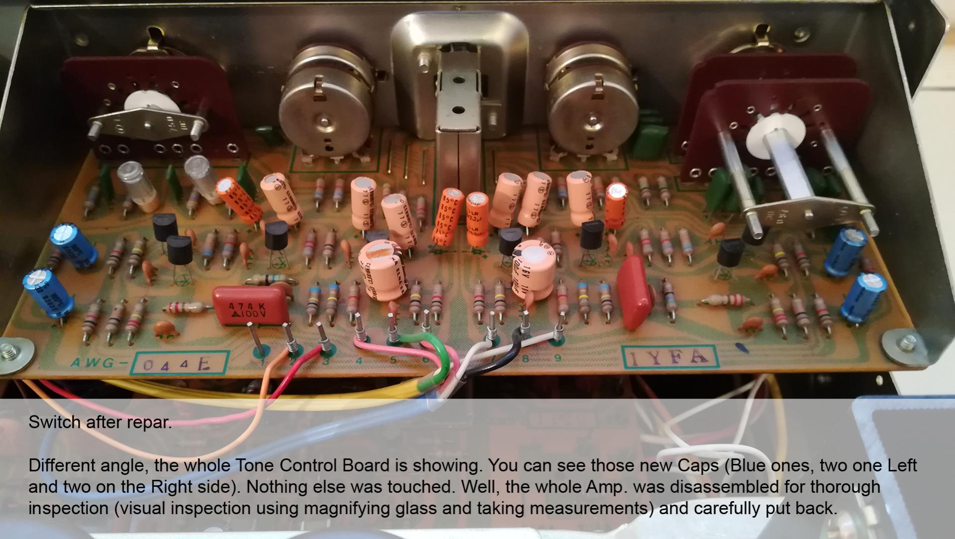

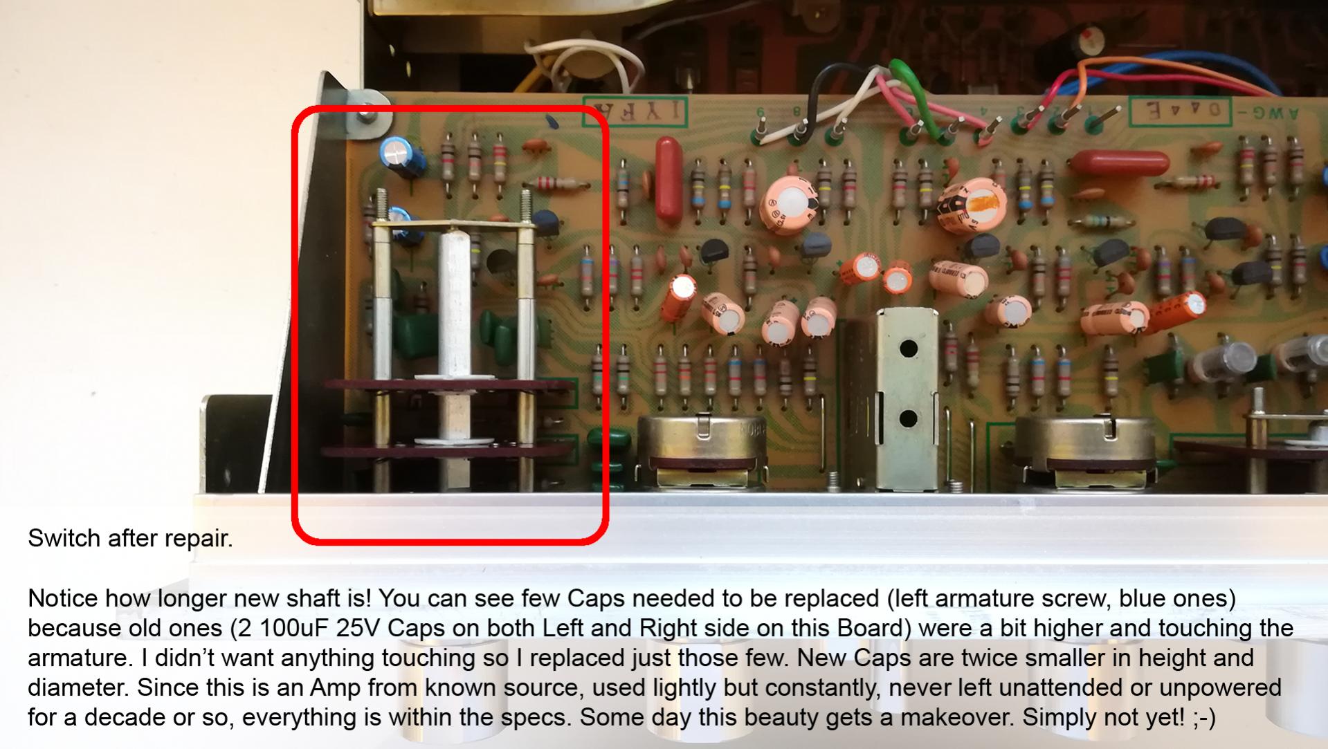

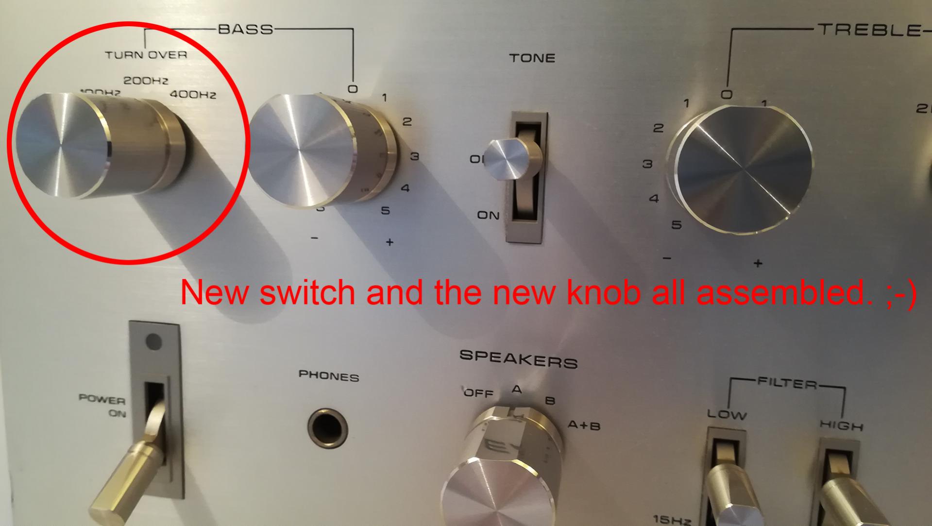

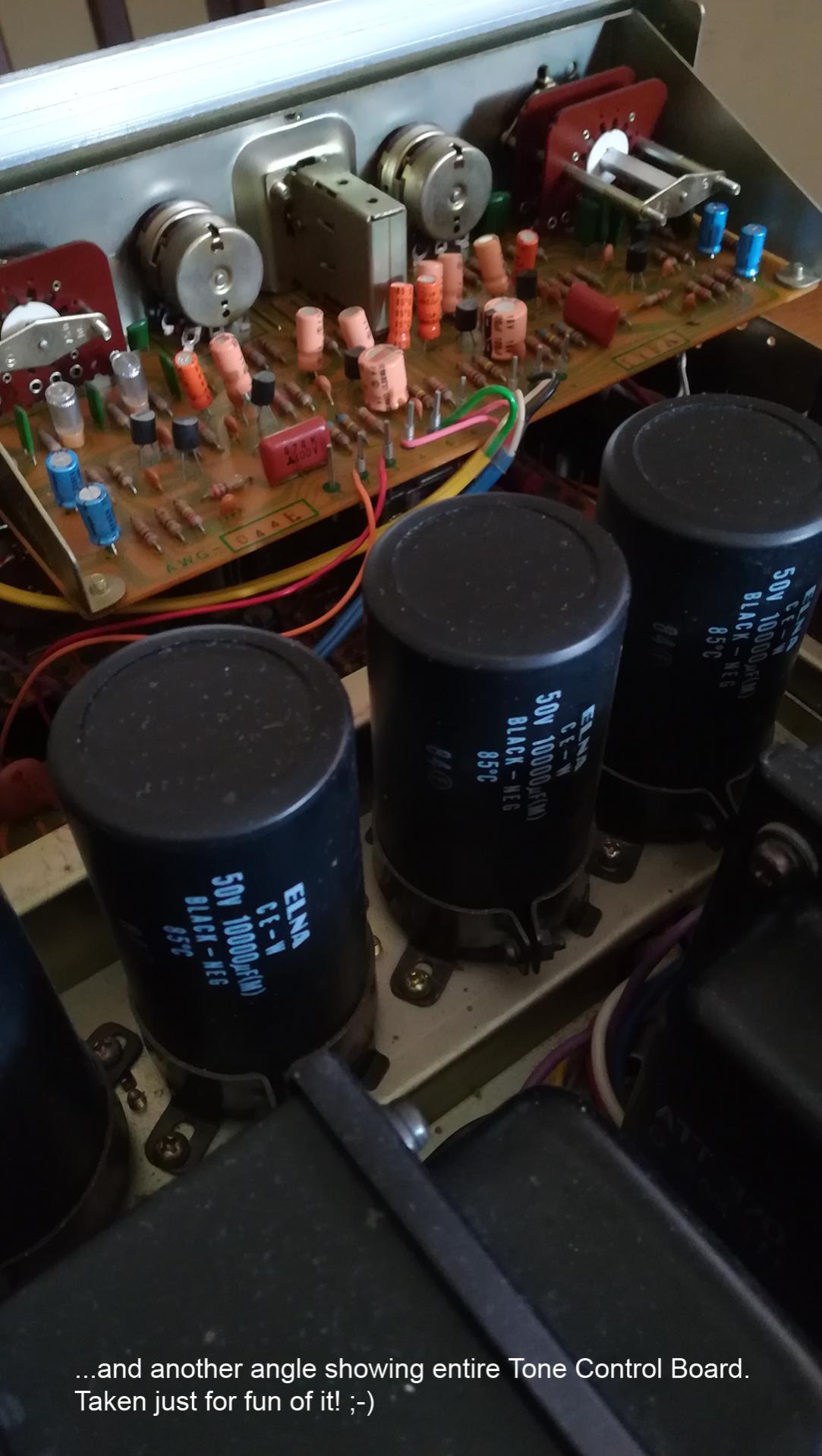

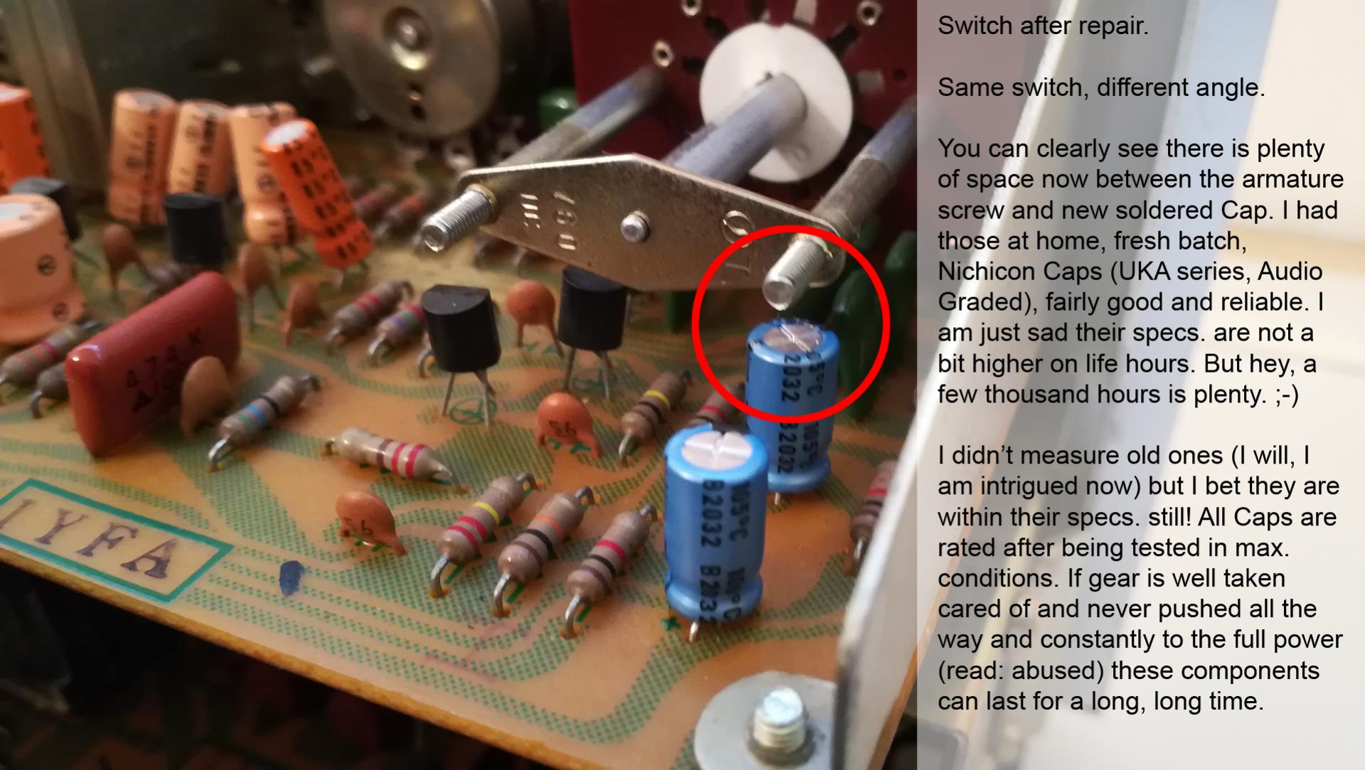

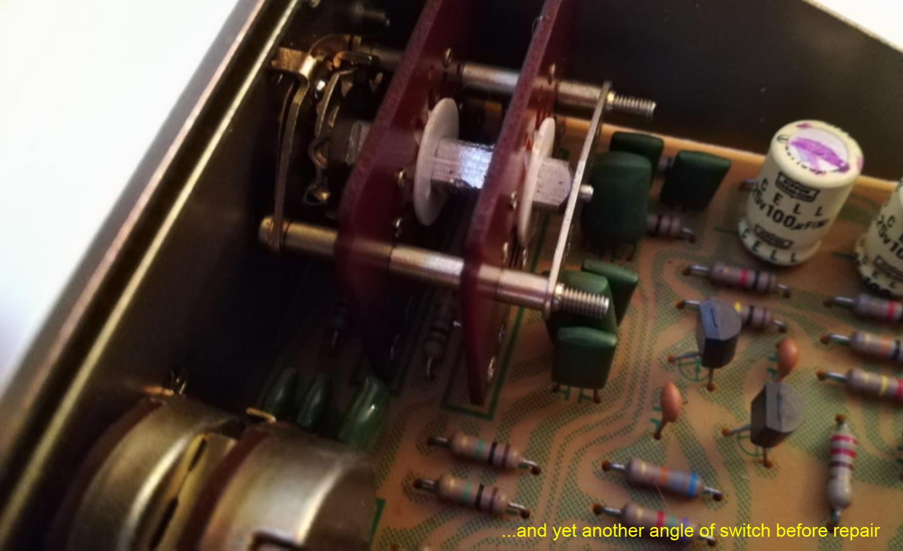

So, it's been a while but finally rotary switch has been dealt with. It's all working now and repair, as hard as it seemed in the beginning, was really easy. For all interested in similar situation (in case a piece of shaft that is protruding out from the faceplate anyway) I can tell you that there is no need of welding, dremmeling, filing off etc. as long as rotary switch is healthy, not bent or broken all the way to the end.
Now, the hardest part was to find exact same design of rotary switch that Pioneer outsourced (or they had their own mills, I don't know that detail) and installed in their units. Exact same part number I haven't been able to find but I did find one that had longer shaft. So, with a little bit of brainstorming and checking out donor switch (and contacting a few folks I know or found online - thanks Buddy) with my neighbour solution presented itself. No drilling, no disassembly (other than switches), no desoldering, nothing... Story is that all those switches (so far I know all ASD series) are the same but their length varies, depending on unit construction and utility of that switch. Shaft can be pulled out and switch left in place, all wafers and all soldered. Be gentle, be very careful and slowly pull out broken shaft. Now, my donor was longer. No big deal. All those switches comes with enough small parts (like those cilinders that goes on two long screws holding switch construction in place) and since my "new" shaft was longer I simply added those "elongaters (cylinders) and put all back together. Now, while I had Tone Control Board out I noticed a few Caps were higher and getting in the way of new, longer shaft. I replaced on that Board two Caps on the left and 2 on the right side (I had at home 4x100uF 25V electrolytics). Newly made Caps are twice smaller, both in heigth and diameter, so after they were replaced nothing else was in the way of newly placed shaft. Yes, it is 1-2 cm longer but it doesn't matter. It has no other function than rotating around it's axis. Right? So, initially I was pretty worried because I haven't ever disassemble old rotary switches. This ones, their construcion, is done in such a way that it is easy to work with.
In case any of you find yourself in similar situation you can go this way. Of course, issue must be as mine, partially broken shaft.
I just wanted to thank you all who participated and wrote back.
Stay safe!
