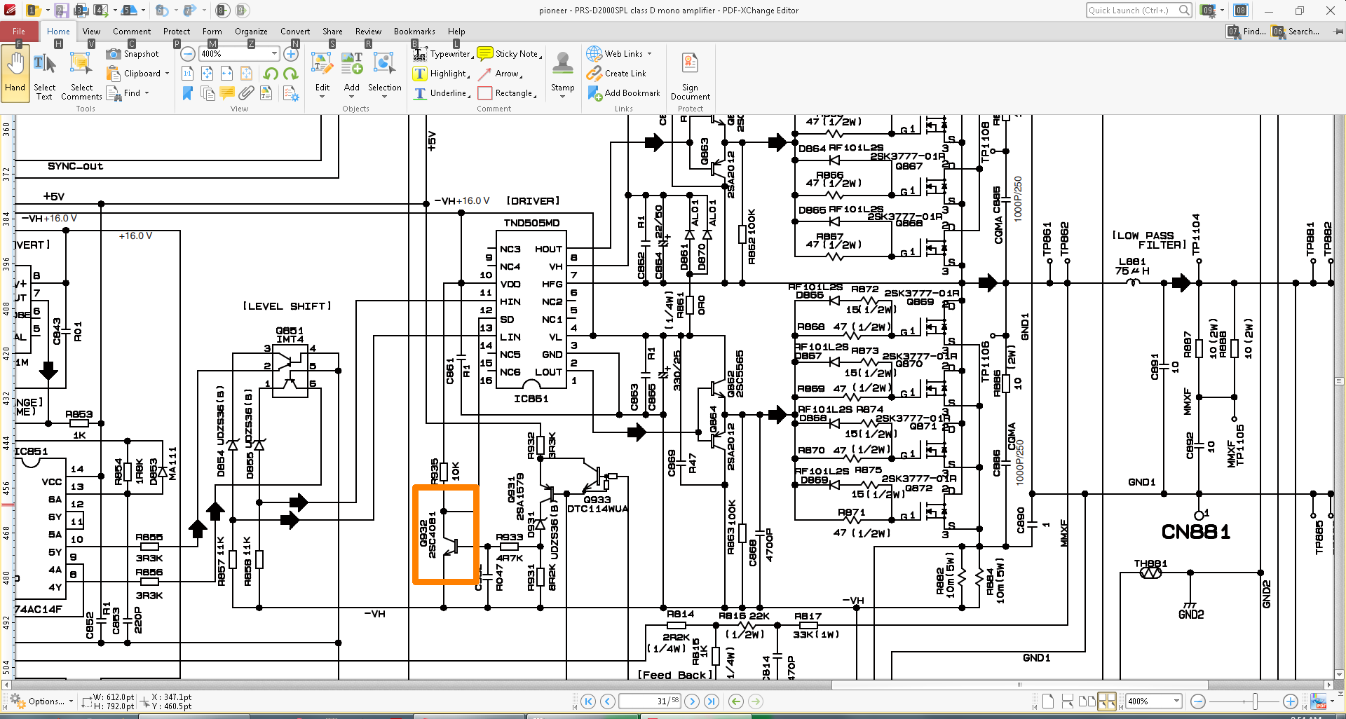

Hi everyone, I have recently purchased 2 Pioneer PRS-D2000SPL amplifiers, and I'm having issues with both of them. I need to replace the driver IC on them both, but the TND505MD ICs are discontinued and I've found an old thread here saying that the guy replaced a TND505MD with an IR2110S, however a modification was done, and he worded it as connecting " the Ground and Common together on the IR2110" but I can only see a COM pin on the IR2110S, while the TND505MD has a GND pin, so I assume they are similar. However the IR2110S also has an additional pin that is in use, pin 15, and it's labeled Vss, while pin 15 on the TND505MD is simply not connected. Could someone with a little bit more knowledge be able to help me after comparing the TND505MD and the IR2110S datasheets and suggest how to modify it to work like a TND505MD. Thank you for reading.
Thank you for the reply. So I assume I should short pin 2 and 15 on the IR2110S, as pin 2 would be GND on the TND505MD? Would that cause any issue for pin 15, because in the service manual for the PRS-D2000SPL I can see pin 2 connects to -VH rail, which is about -110V?
Thank you Perry, I've placed the IR2110S in now, with pin 2 and 15 shorted, and the amplifier turns on but it makes my subwoofer emit the loudest mid-to-high-pitch sound, with the amplifier itself buzzing as that happens and LED D402 on the power supply board flashing red repidly with each buzzing sound the board emits. I of course turn it off quickly, and when reducing the gain pot to about midway point, the LED doesn't flash anymore but stays on instead, with the speaker still emitting the same sound. When reducing the gain pot to below half, the LED doesn't switch on anymore at all, but the subwoofer still emits that loud noise. Any idea where I could start with the troubleshoot?

I need to know what the drive waveforms look like.
You'll need to remove or lift the transistor indicated below.
Transistor 2SC4081 @Q932 removed.

To get back on topic, I've removed the 2SC4081 @Q932 and now with a scope sitting beside me, could you guide me as to what the next step would be in troubleshooting the issue?

I see a square wave on the HIN and LIN pins of the IR2110S, when measured with multimetre they are both at -114.7V.
